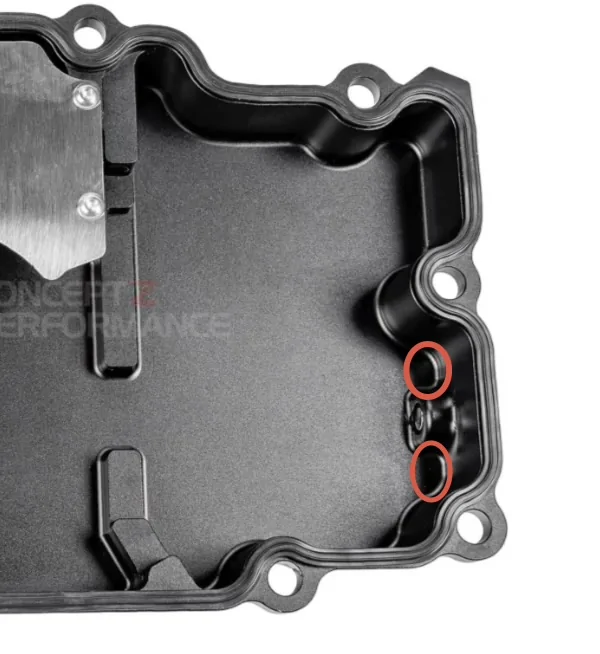

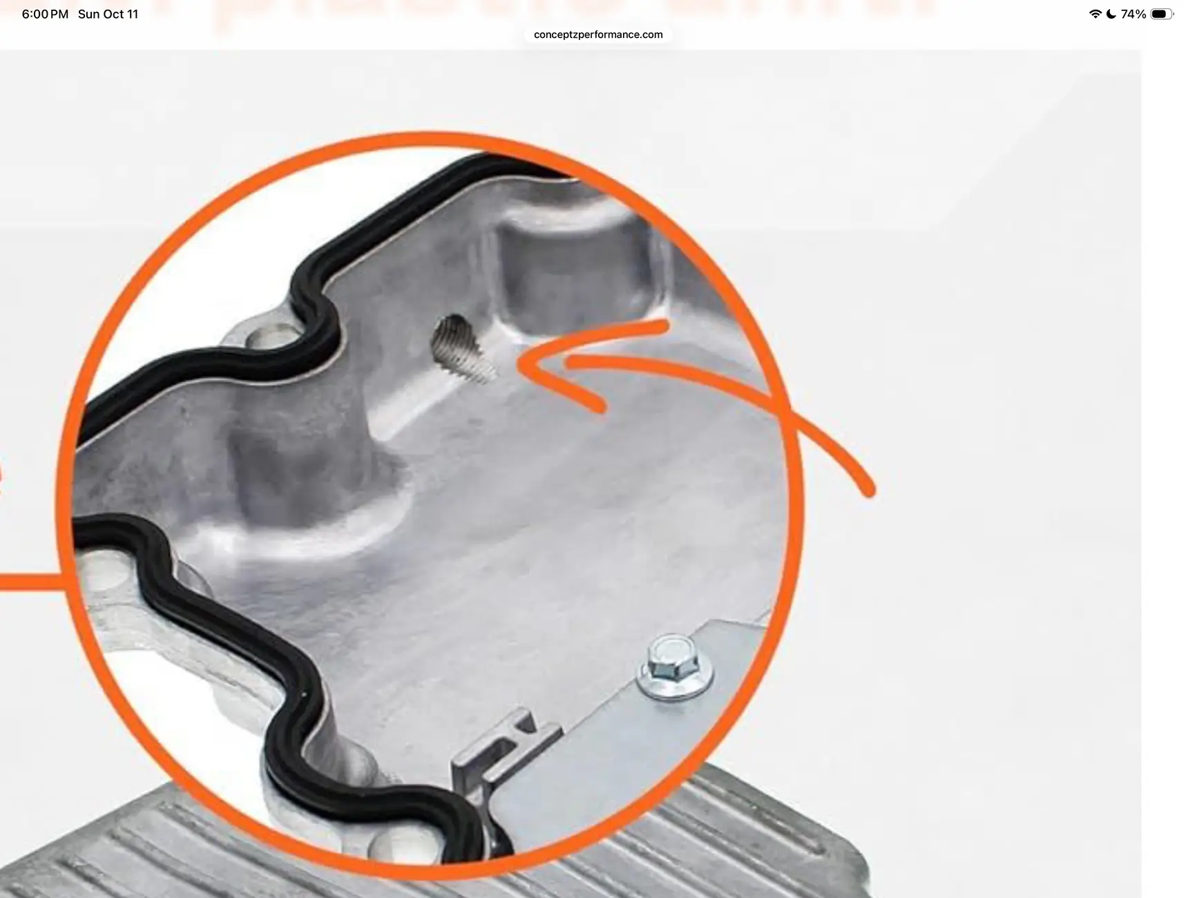

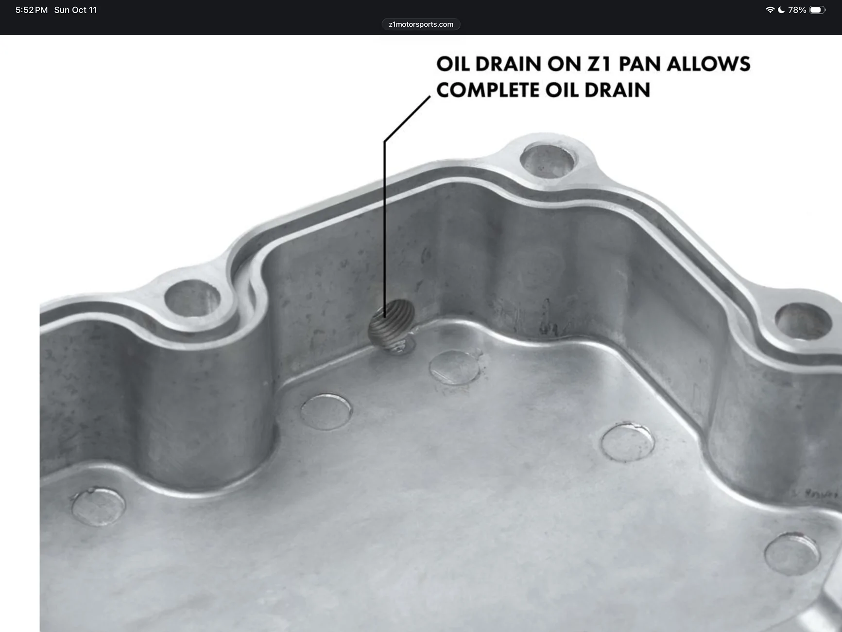

Looks like the Dorman and Z1 will drain better than the CZP. CZP drain is similar to stock except the drain is flush with the floor but raised from the side wall creating pockets on both sides of the drain.

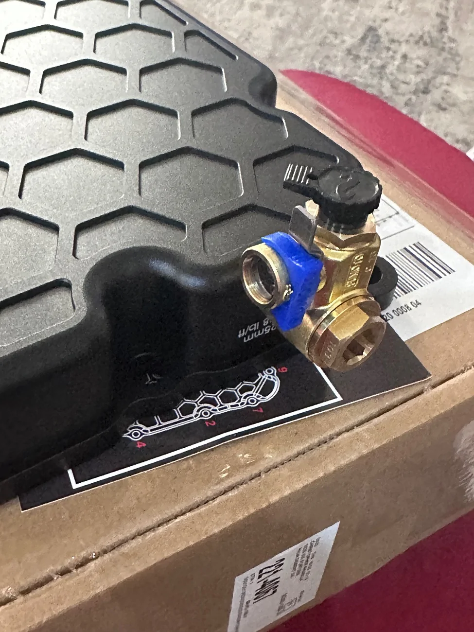

One of those Fumoto drain valves with a 90-degree bend would make for a clean oil change!

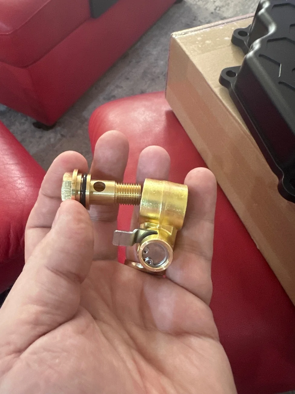

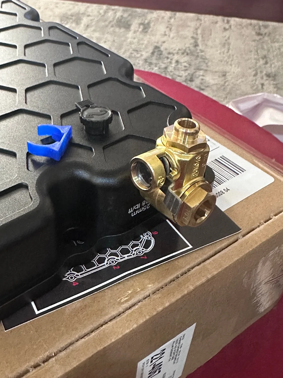

Ordered my CZP oil pan and already received my Fumoto right angle adjustable valve oil drain plug, my previous ones had a plastic fitting that should snap onto the valve to connect the hose, this was easy to bum off. Now they offer a brass option fitting to connect with , something like a snap on action device. This I assume will work better.
