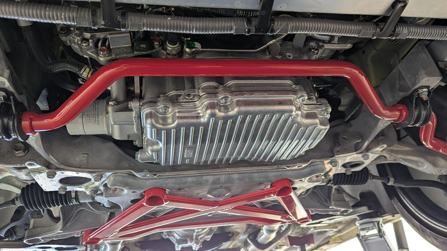

Some initial observations after having my Dorman aluminum oil pan installed for about a week now. This is not scientific data, just some general eyeball observations driving around Houston in both traffic and spirited conditions.
Oil temps are running about ~5F degrees cooler during normal driving conditions and stop & go traffic. When things start getting spicy under my right foot (testing out my new RaceBox tune, for example), peak temps appear to be roughly ~10F degrees cooler.
I suspect this is a combination of the slight increase to capacity, but also the thermal properties of aluminum vs. plastic (which is an insulator).
Once full warmed up, I've also noticed oil pressure sits ~2psi higher at idle.
Overall, very happy with this addition considering the minimal cost and ease of installation!

Beware of the aluminum threads on these pans. They strip very easily with 25ft/lbs of torque on the drain plug bolt. Learned the hard way. I still had some good thread left and used a longer bolt as a drain plug. So far no leaks. Highly recommend a steel thread insert.
