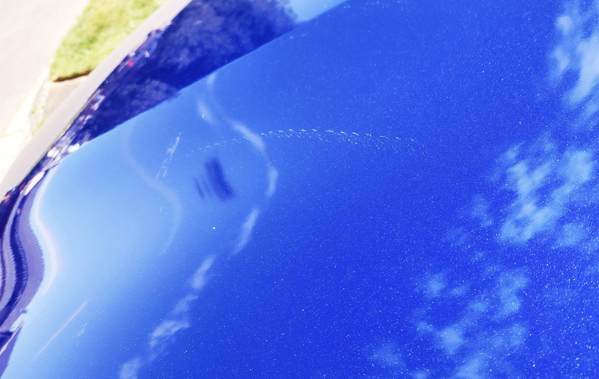

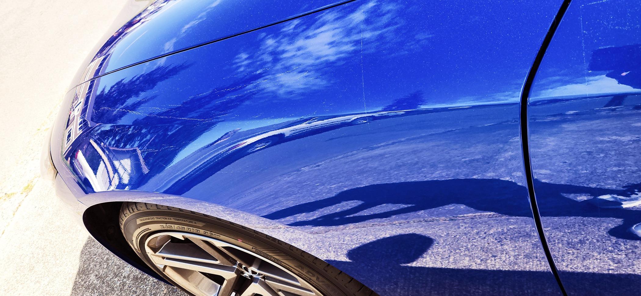

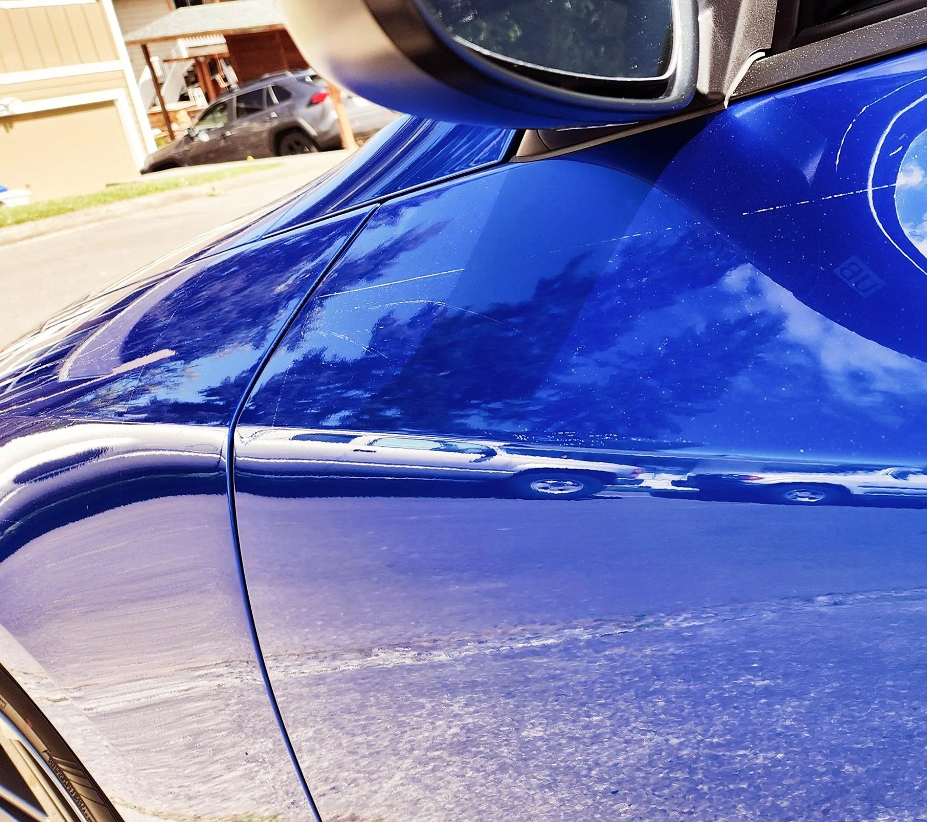

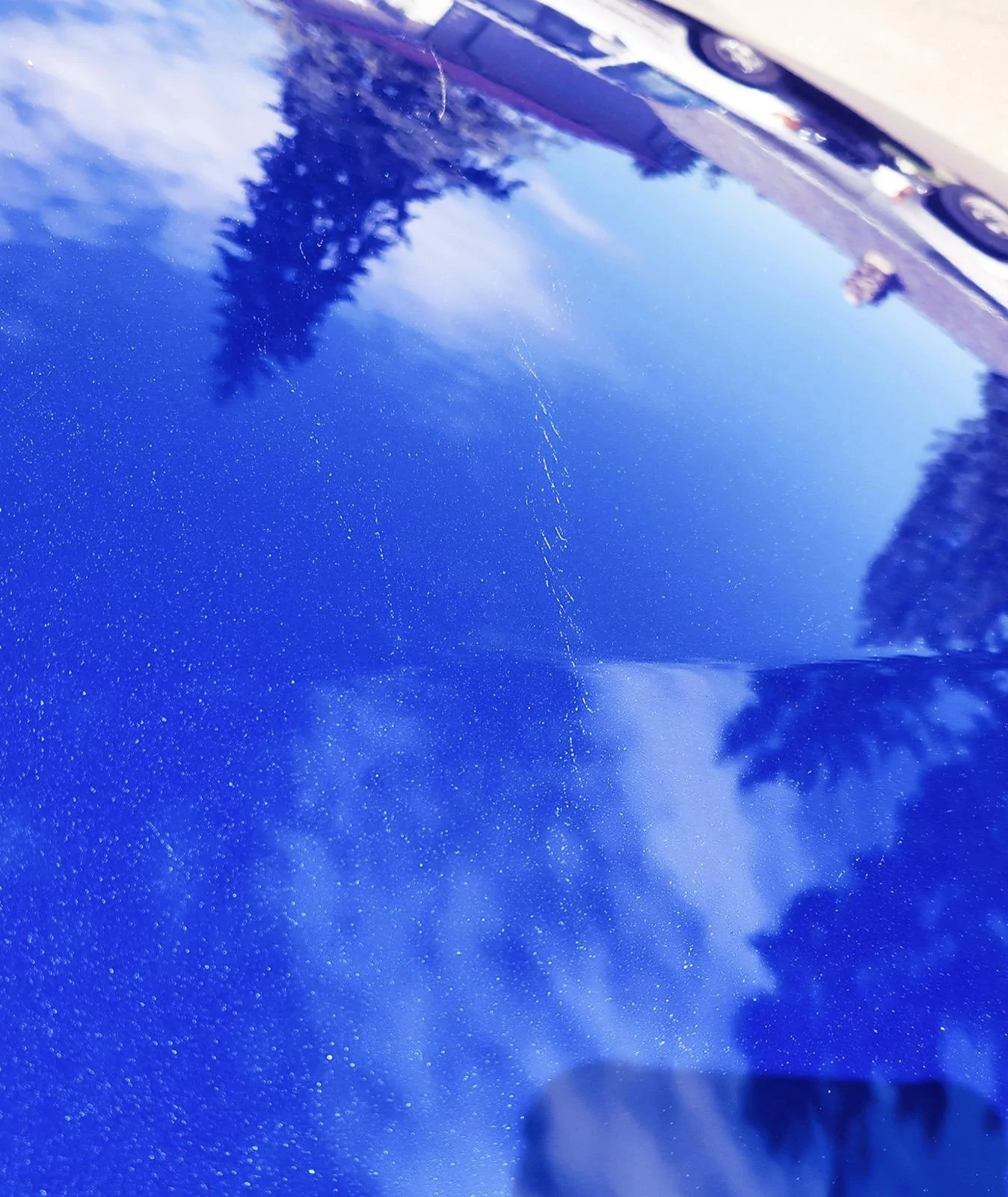

My car paint has adhesive residue from the dealership. Looks like it was from the tech ripping off the transportation white protective film and left marks all over the paint. Would clay mitt work on removing the residue or should I just go straight to machining with paint correction?
I wanted to reach out here for those that can help me decide what the best way to handle it

I had some on the sides of the rear bumper. A little wax act took it off. You can slightly use a bit of scratch x on an application pad too

I almost hate to admit that I've had mine since November and still have a few small lines of adhesive I haven't gotten off. But yeah mine rubbed off fairly well in the spots I actually tried. Mine was mostly the rear bumper around the reflectors. Didnt have any on the hood or roof ect

Mine was delivered with the adhesive lines too. I agree the IPA wipe would probably work, or maybe some quick detail spray after a wash. Others have specifically suggested 3M adhesive remover (the general purpose one, not one of the specialty ones).

Mine did as well, but I used WD40 to get them off. Worked freakishly good, the lines came off like melted butter.

I removed most of the residue on the drivers side post wash with a little elbow grease, spray on wax/sealant, and a microfiber towel.
Most of mine was on the fenders, door, and quarter panels. Still discovering new lines in different lighting

Yeah, Im just going to claybar and do paint correction with a DA polisher. Then add Sealant afterwards
