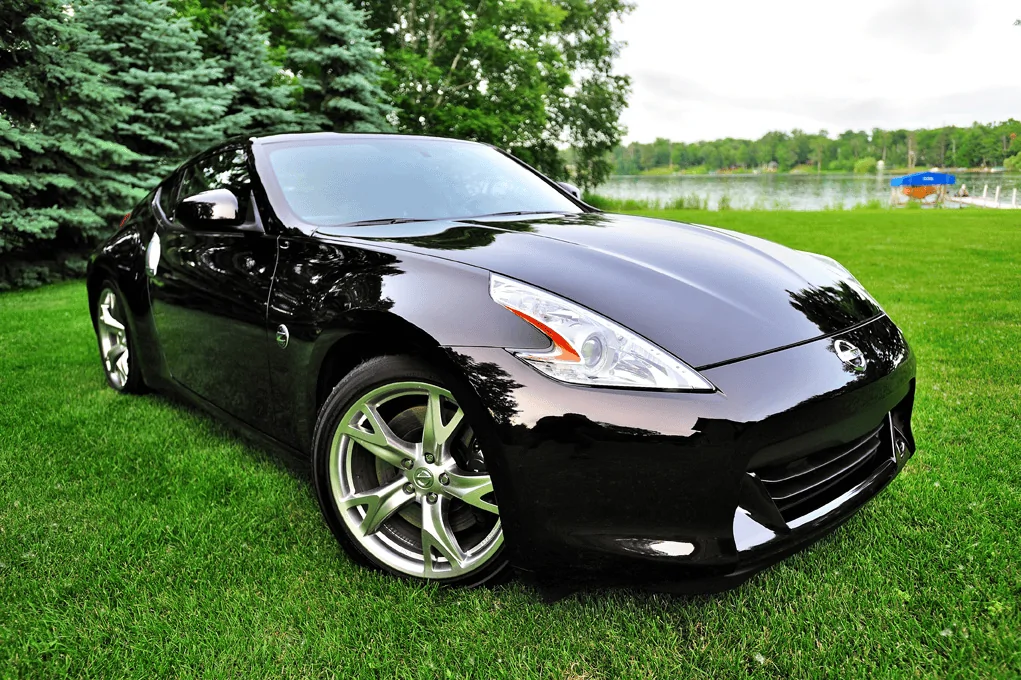

Companies like Adams Polishes or Chemical Guys are all about polishing and paint correction, and both companies have a ton of videos. I use Adams polishes and pads with the trusty old Porter Cable 7424XP random orbital polisher. There are other polishers that are more efficient, but I like the variable speed random orbitals because they make it almost impossible to burn or otherwise damage the clear coat. More importantly, the results from such polishing followed by glaze then a good carnauba and/or a grapheme ceramic are typically spectacular.
I've been doing this paint correction stuff since my first 370Z in 2011, and Adams was a fledgling start-up. In fact, my Black Cherry 2011 was featured for awhile on the header of their web site way back then (that Black Cherry color was notorious for showing swirls and marring). I used, and continue to use, the pads and chemicals from that era....orange ->green->white, followed by machine-applied sealant. Now, it appears that they've changed some of the colors/compounding, but I have a lot of confidence in that company.

That is incredible work!
