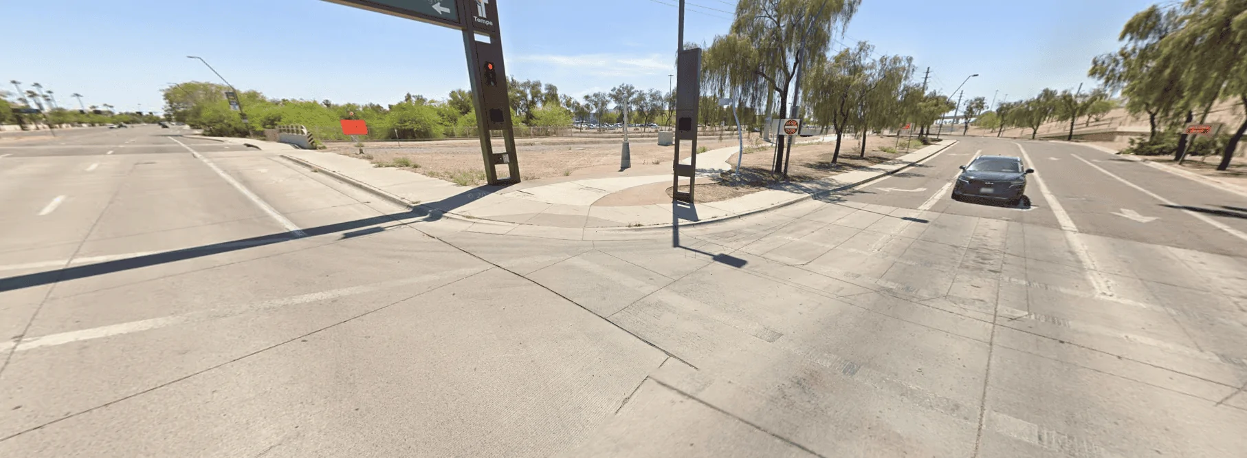

Stock tires here still, but I swear after we hit 100+ degrees here in Phoenix, I feel like I'm actually slipping MORE often. Probably doesn't help that a lot of highway bridges & turn-ons etc here are all just flat concrete instead of actual asphalt these days..
perfect example image:
I'm from AZ, currently live in WA state.
I had a tuned 2016 GTI, and I had way better traction (still not great) on streets in the Phoenix metro area. I could never get traction here in WA state, even on nice days, and we're mostly asphalt here.
I replaced my GTI with a Q60 AWD, and now I'm not so sure I want a Z because I'm enjoying traction!
