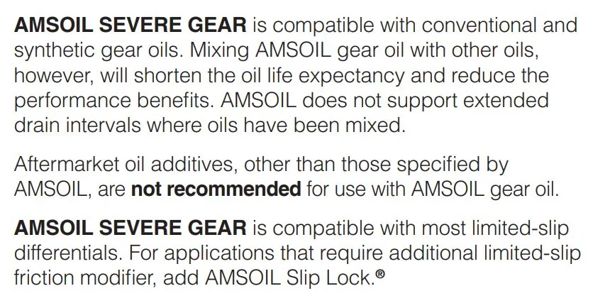

I am a HUGE Amsoil fan and user...this stuff is fantastic ..
https://www.best-synthetic-oil.com.au/AGL
I have Redline in the Z and Wrangler, but have Amsoil SG in the Grand Cherokee. Both are basically the best available on the market.
Funny timing on this diff fluid discussion...just last night a thread I started a decade ago on the C7 Corvette forum about this exact topic just became active again! Basically the same comments too, just how nasty the fluid looks and sludgy the drain plug magnet is, even with very low miles. Once you're through break-in, that almost completely subsides and you can start extending drain intervals much longer (easily 30-50k, sometimes even 100k miles, depending on the vehicle & fluid).

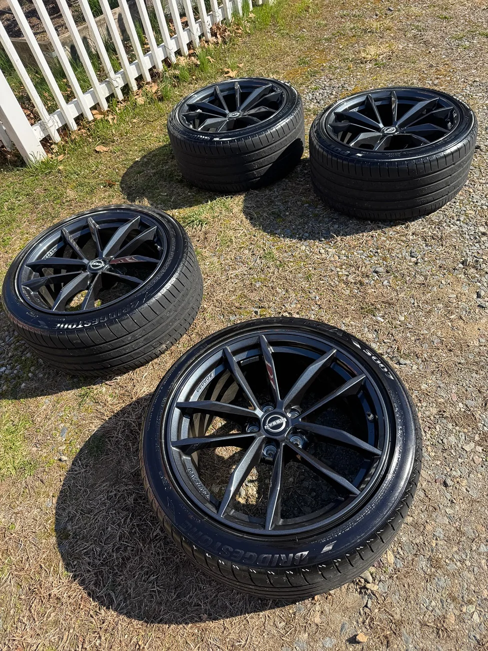

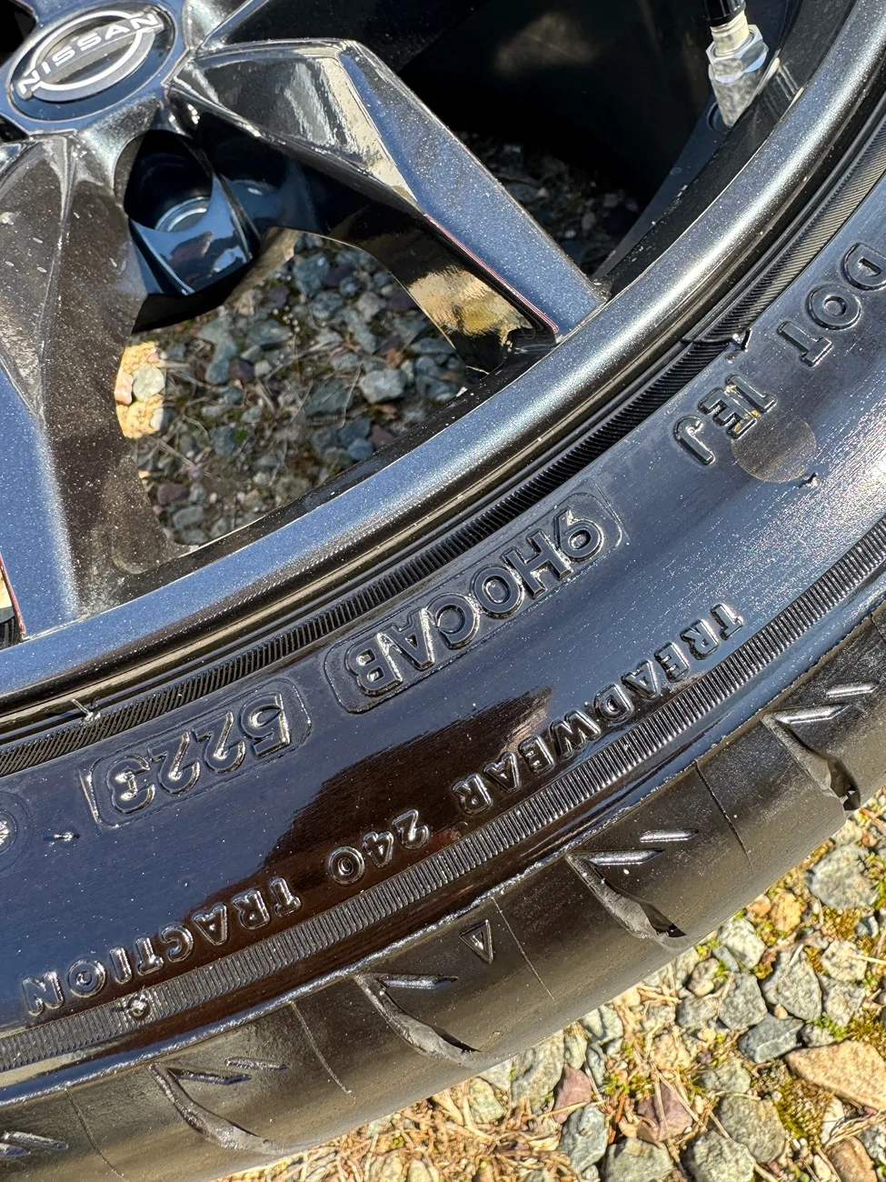

Cleaned my tires and applied some fresh coats of Dura Coating. The shine lasts for months and months. I don't use tire shine gels or sprays anymore.
This is how they look when done. They are dry to the touch and won't pick up road grime. Easy to clean too. A pain to apply but worth it.
