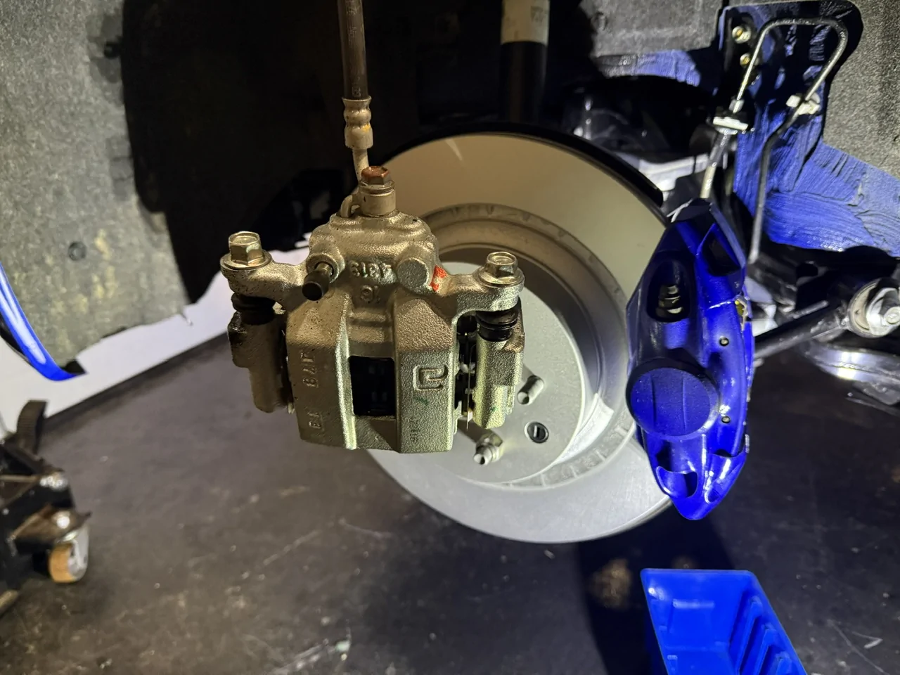

i installed them without refinishing them. It’s only cosmetic anyways. No one is gonna know except you guys lol
This is the “conversion” SS braided line i used. The oem had a hard line to a block with the rubber hose.

Line kit was manufactured a decade ago? That would concern me.
Christopher
Nov 23, 2025
973
1,316
Fulshear, TX
VP
if people have 20 years old hose on their daily that they track, i think my ss will be fine lol
To each, their own. I had a SS brake line blow out on me once so perhaps I'm a bit paranoid.

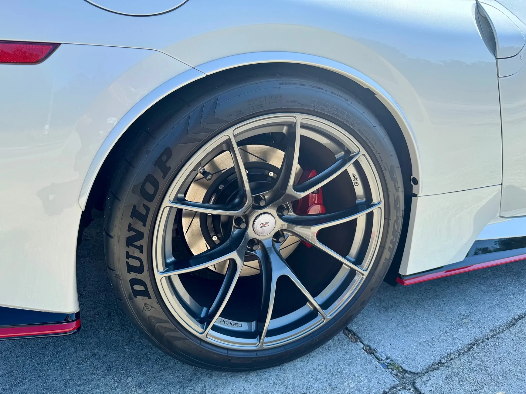

I did the CZP Paragon 2 piece rotors. I feel the Nismo should’ve come with 2 piece rotors, but yes I know the 2027 Nismo will have them on the front at least. These rotors actually didn’t drop the amount of weight I was expecting(26-28lbs) it was more like 21 lbs which is still good.
Oem front 34.6 lbs
Paragon front 28.5 lbs
Oem rear 19.5 lbs
Paragon rear 15 lbs

The rotors, wheels, and car color look so good! The paragons are so expensive though. What was the cost for all 4 corners?

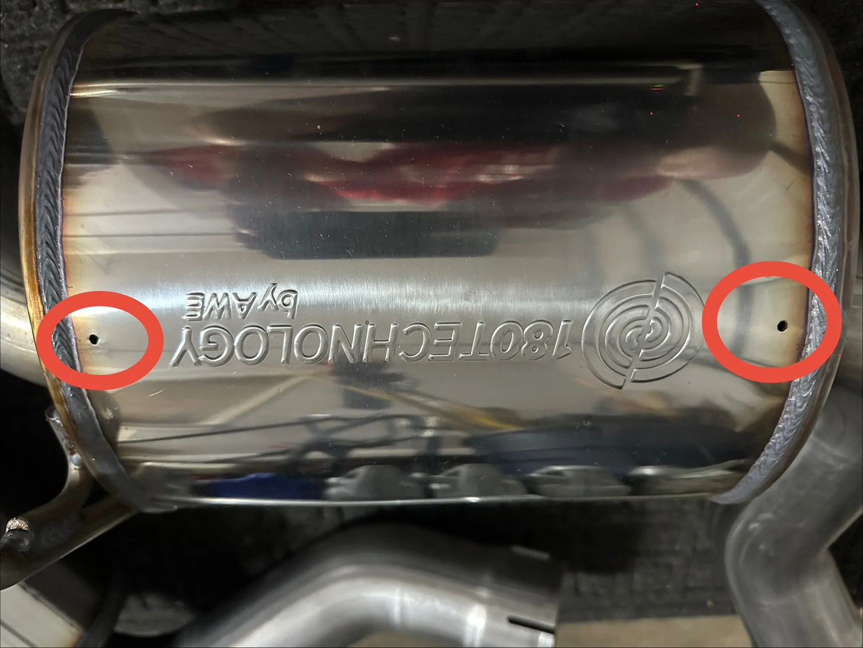

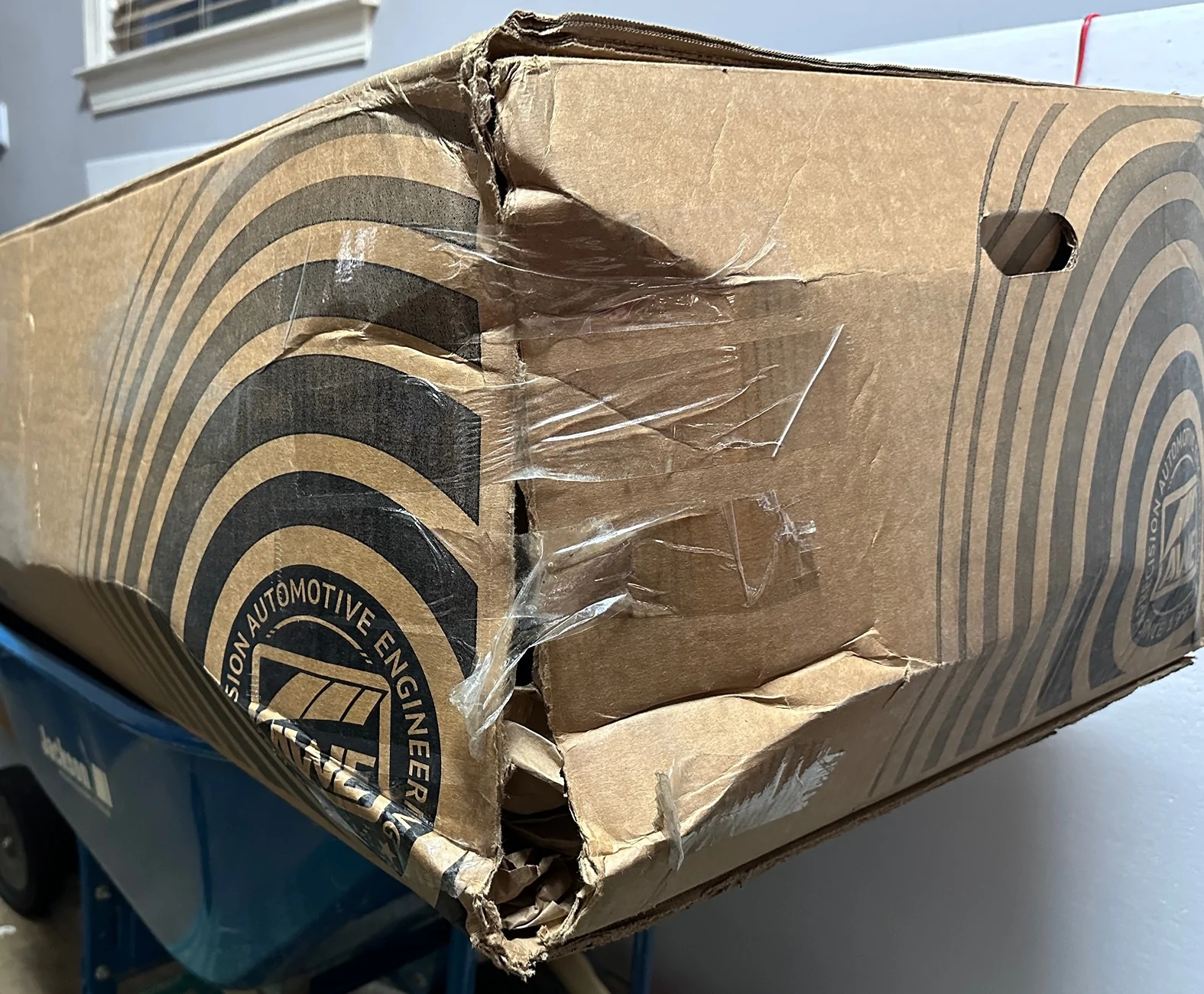

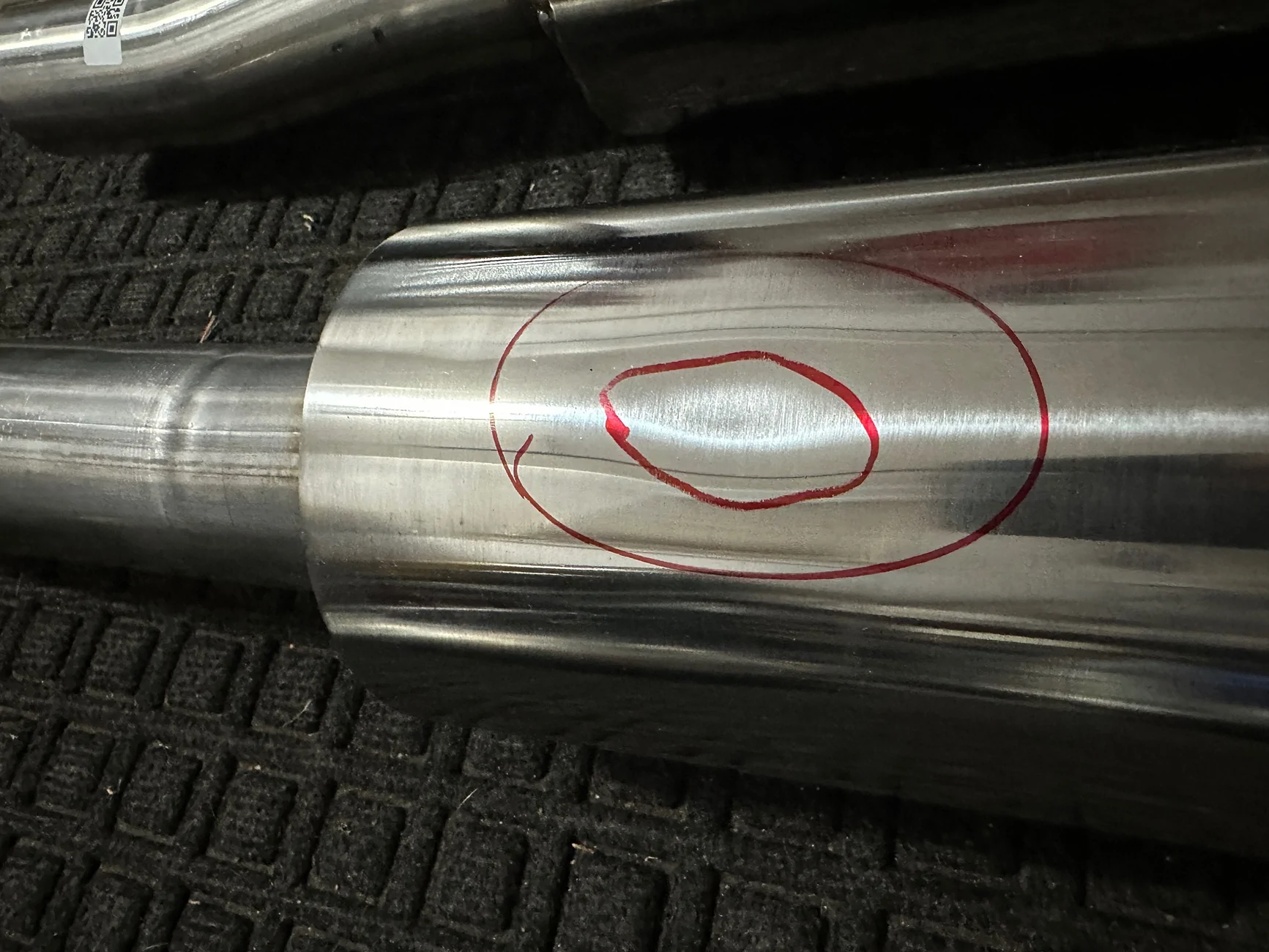

While I’m waiting on my lowers, i decided to check my awe exhaust since box was trashed by fedex. everything looked good. Has a minor dent in one of the resonators and the mufflers have weld splatter that rattles as you tilt the mufflers side to side. Also i took a pic of the holes in the mufflers part of the 180 technology? looks like something i did in my younger days…

They're condensation drain holes.
FedEx really did a number on that... Are you going to contact AWE for a replacement or run it as-is?
