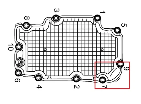

Went in to garage this morning to find about 1/2 quart of oil on the floor. After jacking and removing most of the Z1 shroud for access, I find my Z1 oil pan leaking at highlighted bolt pattern. Was fine for 3 weeks, first sign of a leak after a spirited drive on a very warm day yesterday. I torqued to recommended spec using recommended pattern, bolts were still tight.
I saw a post saying torquing to recommended Z1 spec can strip threads. I hope I didn't as that be engine block threads?! I lowered for now and threw an oil drain pan underneath as I contemplate a next move. At minimum it seems I should reinstall with a new oil pan gasket. But I'm now 2nd guessing my brand choice. Could there be a warping showing itself in that corner? Not sure if that's possible.

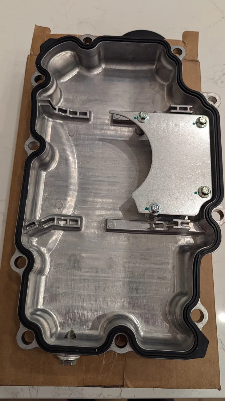

I may be able to get a replacement gasket out of Z1, but really wondering if I should swap for another brand. I did not like the soft hex bolts used to secure the plate (see pic). They felt like they were going to strip as I was torquing to spec.
I found this forum pretty much after I made my mod purchases. Saying that as I see many recommendations for the Dorman pan (thank you KrackaC8), and the CZP looks stellar but is $ 100+ more. The Dorman has sturdy looking 8mm? bolts securing that plate. @KrackaC8 was that plate already installed?
Hoping for suggestions.. what's a good next step? Thanks!

Oh man, that sucks! I'd bet either warped pan or gasket failure. You can reuse your stock gasket if you still have it, otherwise I'd ask Z1 to send a replacement. To check your pan for warpage you'll have to remove it and lay it face down on a granite counter (or other known flat table). A machine shop can resurface it back to true, but for all that work I'd just request a replacement or refund from Z1.
On to the Dorman, I still think it's the best value on the market since it includes a gasket and magnetic drain plug. That plate you mentioned does come pre-installed. I checked the bolts prior to installation and all 3 were tight.

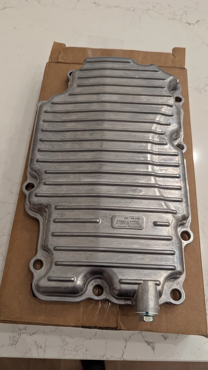

Here's my Dorman:

Dorman was a painless install for me as well. Internal baffle bolts were tight, marked as QC'd and have obvious loctite. Installed with the provided gasket and original bolts, approximated the tightening pattern and guesstimated torque by hand. No leaks.

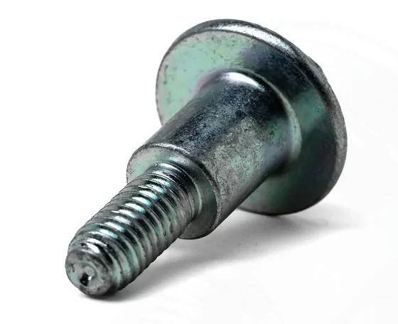

Meant to add the OEM bolts are shoulder bolts. With hand tools you can feel when they bottom out and stop at a snug fit. Honestly would not use a torque wrench myself, the area where the bolt necks down is a fail point and would be a royal PITA to extract.
