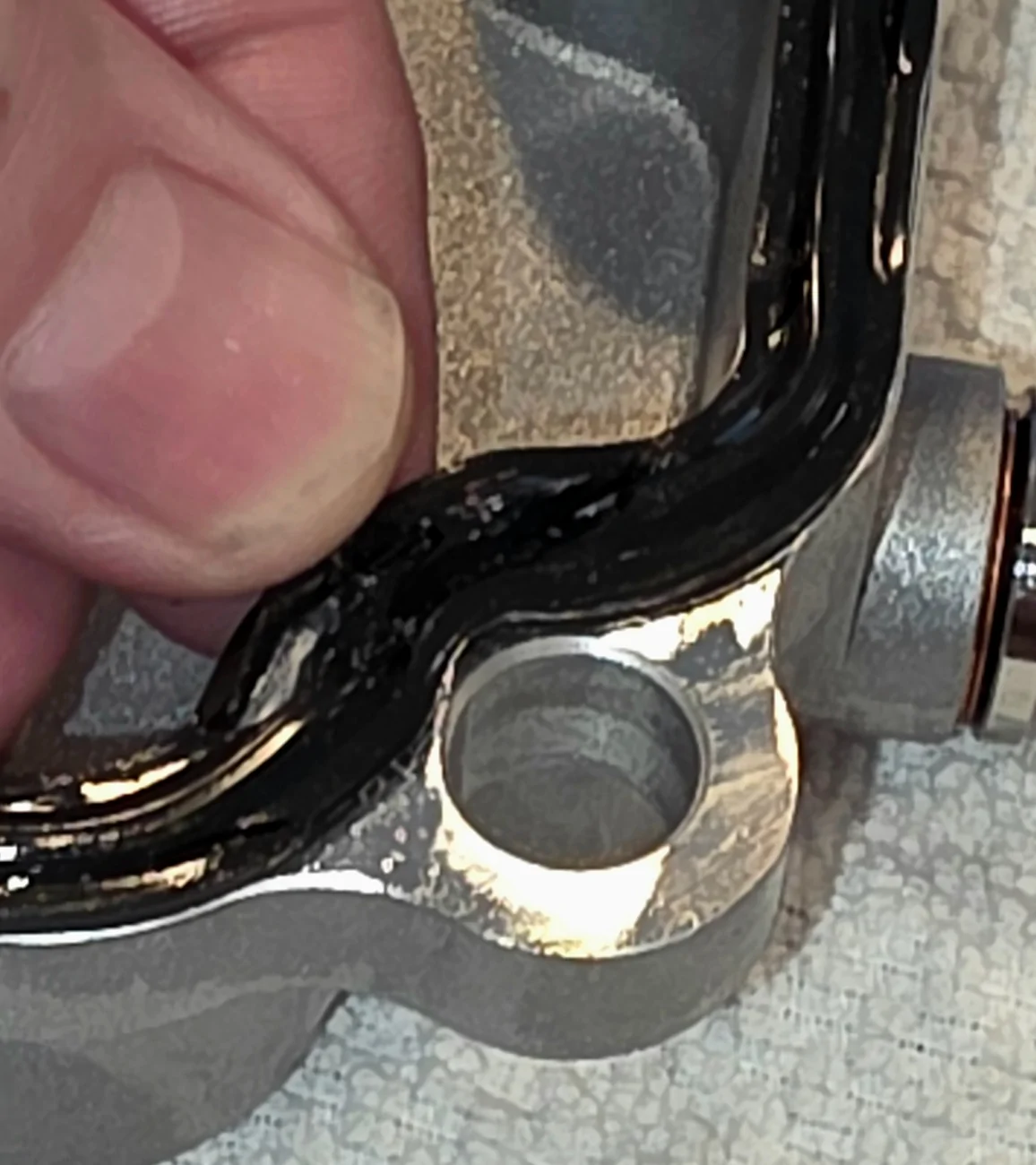

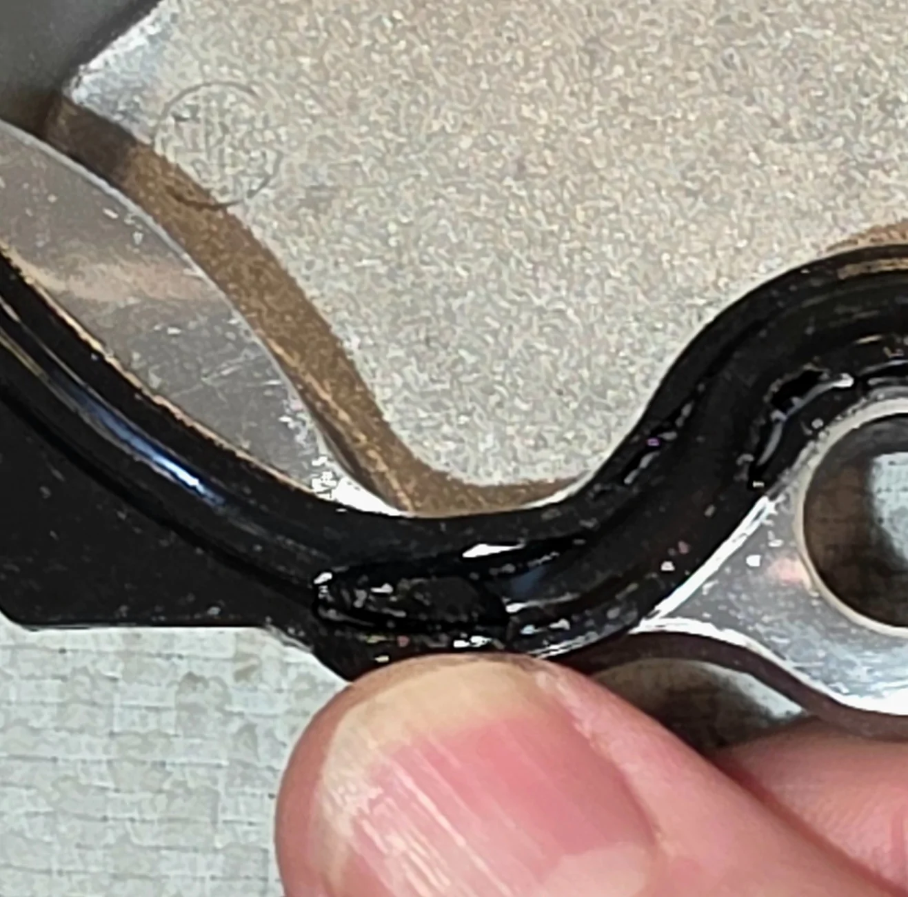

Well Z1 and Z forum, I owe an apology for the alarmist jumping to conclusion post. Turns out the gasket was torn in two places. I guess I could have jostled the gasket a bit when mating the lower pan to the upper.
In hindsight, I recall the gasket being a balled up mess. Doing again, I would install the gasket and let pan sit for a day, maybe helping gasket learn the bends. I'd also install the plate bolts a day ahead, letting the red Loctite cure. And mating lower to upper pan, be as even as possible, get four perimeter bolts hand tight to keep pan in place, then install all bolts and tighten per pattern.
Learning experience.. cheers,

I'm glad you found the issue! You can reuse your stock gasket if you still have it.

I ended up finding a slow leak on mine too. I reinstalled the original OEM gasket and retorqued everything. No more leak. Can't say if it was the new gasket or I just didn't install the Z1 gasket correctly. Definitely not an issue with the pan itself though.
