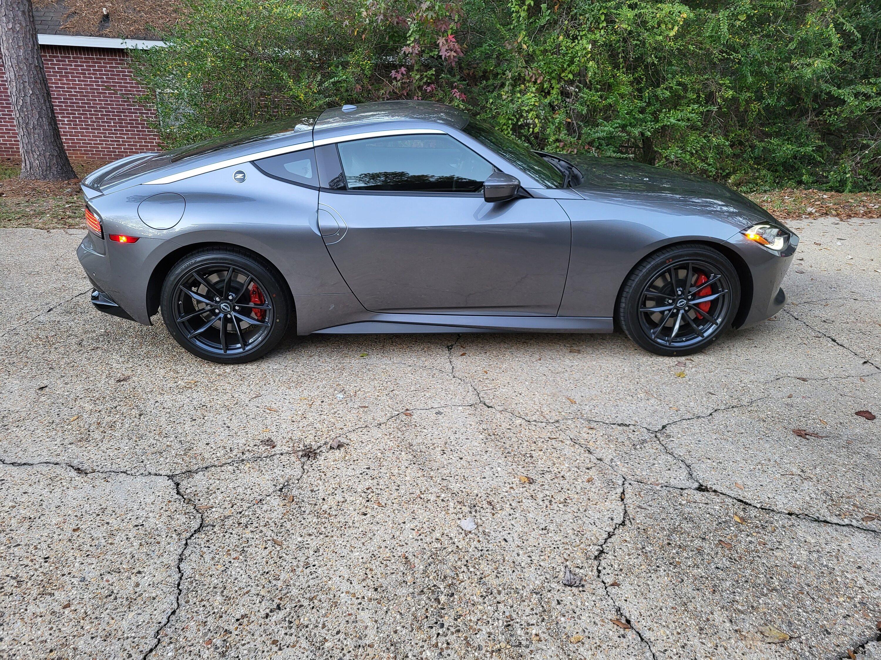

New 2024 Z only a few miles and I have a rattle on door. Slightly rough roads,etc causes a rattling noise close to arm rest. If I push on it, it will almost go away. Sounds like a loose wire behind panel? I can tap on panel and I can hear a rattle from the area. Anyone else heard of this.?

Post some pics of your new Z! What do you love about her so far and what do you dislike .

Dislikes- rattle in door, poor backup camera quality, and maybe aggressive downshifting when slowing down.(AT)..
LIKES- just about everything else. They nailed the side and back profile. Still undecided about front.

Beautiful color. I totally agree about backup camera.
