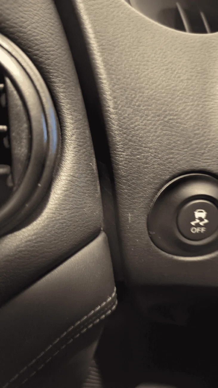

Probably not i mean if that button pops out I might have them see if they can tighten it. Yesterday I did some back road driving and I actually pushed that soft touch material area surrounding it forward as hard as I could and it went away for the rest of the trip.

So my wife (who appears to have better hearing than me) said she noticed a rattle or buzz in the dash when we were driving the other day. I couldn't hear it.

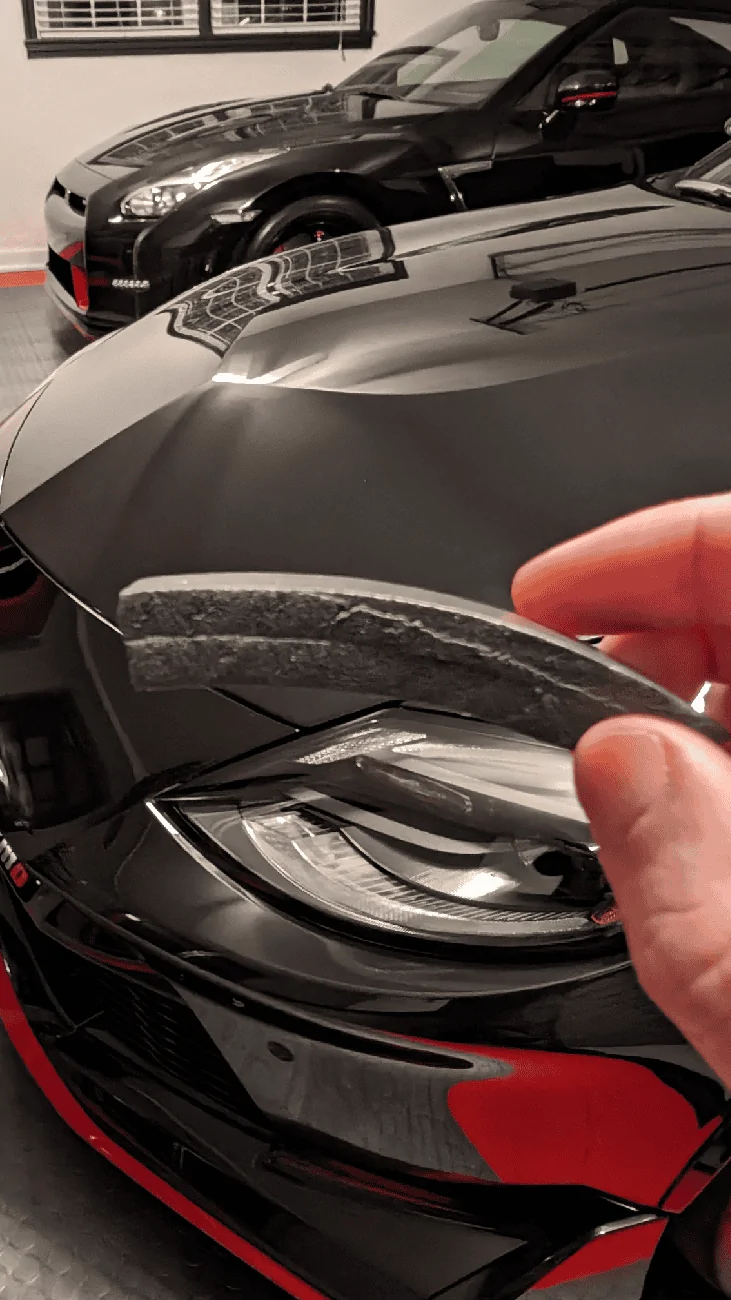

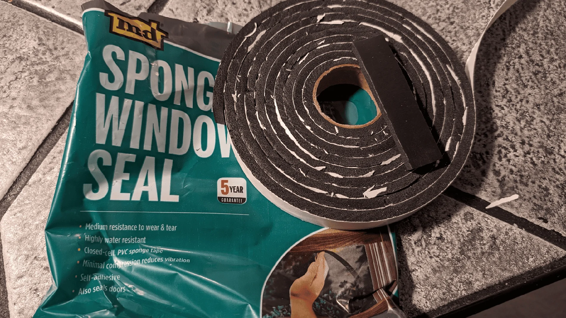

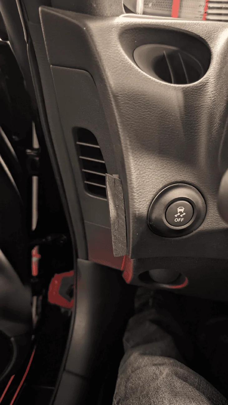

Ok so I figured out a temporary fix. It's not optimal for a new 50k plus car but I went to Lowe's and bought some window sealer foam strips. I cut a small piece and double stacked it putting it on the edge of dash area best the traction button . When the door is shut it compresses the foam and the buzzing sound is gone.
It's not great to have foam there but you can really only see it when the door is open. You might have to play around with positioning to get the right

I'm wondering if I can pop that air vent off and stick the foam on the inside of the dash right there for a more permanent cleaner fix??

Yeah I thought it was just the button but I randomly stuck my fingers between the door and dash while driving and it went away which gave me the idea to stick foam there and sure enough it worked

With the door closed you can't really see the foam
