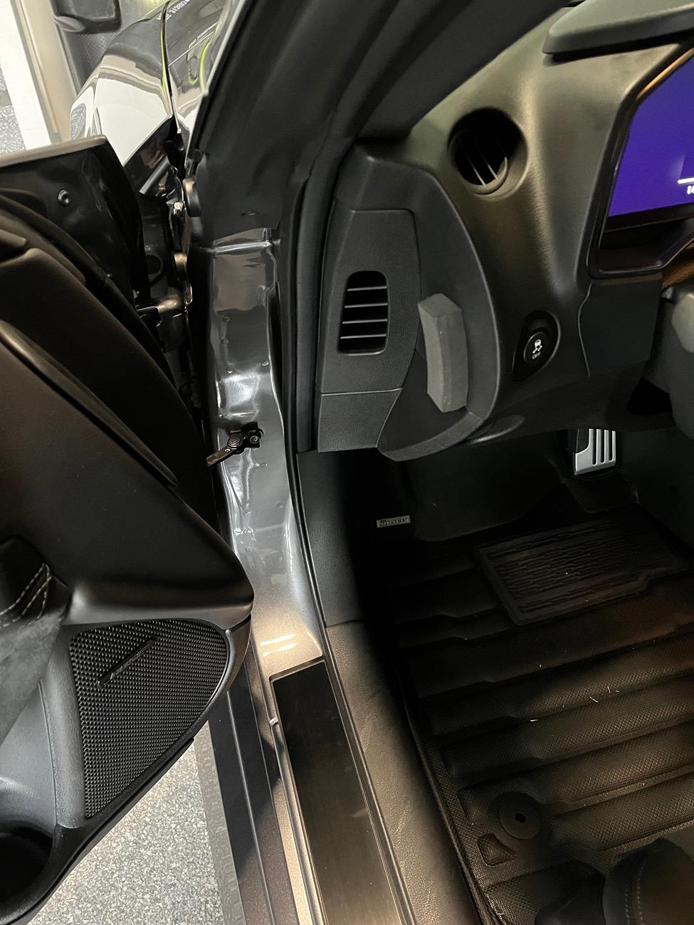

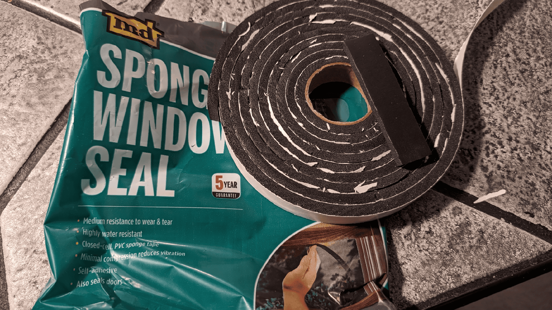

Ok so I figured out a temporary fix. It's not optimal for a new 50k plus car but I went to Lowe's and bought some window sealer foam strips. I cut a small piece and double stacked it putting it on the edge of dash area best the traction button . When the door is shut it compresses the foam and the buzzing sound is gone.
It's not great to have foam there but you can really only see it when the door is open. You might have to play around with positioning to get the right

the door and dash dont actually rub ...its the side of the dash buzzes at the traction button location on bumpy roads unless there is pressure on it. the foam being compressed between the door and dash is applying the pressure to prevent that.

one other thing ive noticed it while it might be the taction button the noise can be "fixed" by compressing the part of the dash around it. so while your are driving stick your finger in the gap in between the side of the dash and the door to where your finger kind of wedges that soft touch material. if it should make the noise go away if its the same issue I have. once you know that you can just get a little piece of rubber or thick weather strip to out there until you find a permanent solution. the weather strip works good for me if I double stack it but after a few weeks it will flatten out and the sound will come back. If I had something more firm that it would 100% fix the noise

I think a permanent fix would be putting some sound deadening on the side of the dash basically on the inside of where your stripping material is now. I think that would mean pulling the lower part of the dash down as I tried and you cant really get to that area underneath. you can see the back of the traction switch if you lay on your back in a super awkward position... just no real way to place anything up there.
I might have the dealer look at it next oil change but since the strip works im just gonna keep using that
one tip on the weather stripping is it will eventually get mashed down and less thick and the rattle will come back so either swap in a fresh few pieces or find something a little more firm like a rubber version

Thanks. I had this laying around. I used this in my garage to put my trash/recycling up against without hitting the wall.
https://www.amazon.com/gp/product/B07P9CDPFG/ref=ppx_yo_dt_b_search_asin_title?ie=UTF8&psc=1
Not sure where I can find a true rubber one the same size. I'll see how this holds up.

This is exactly what Im using just from home Depot. I've had to swap it out a few times so was just thinking something slightly more firm would be more permanent but at the same time it doesn't need to be so firm is makes an impression into the door or dash when closed

Did you ever find something more “permanent”. Just replaced mine. It seems the sticky pad behind the foams seems to melt due to heat.
