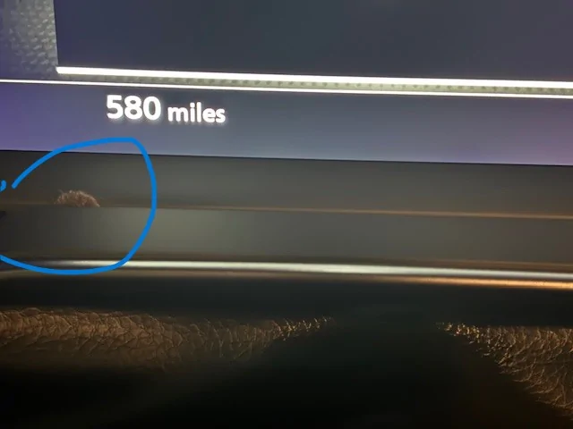

Has anyone made progress on this?
I have a 2024 Nissan Z, and had some issues with this rattle buz, and I solved the issue, I know exactly where it is. When you push on the traction button it does make the rattle go away, but that's not where the issue is. It's the dash surround plastic trim; there is no foam installed between that piece of trim and the actual plastic dash assembly. I gently pulled back the plastic dash surround and installed four small discs of adhesive foam in between the dash surround and the actual dash display. The noise is gone, and the car is silent. It was driving me nuts, but it was an easy solution.

I put foam between the dash trim next to the traction control button but as the original poster stated its at temp fix because it compacts and the glue moves around in hot sun. Any photos for exact spots? I am looking to have my friend help me with this and anything would help. Not sure how the dash comes off. Seems like a very intensive job.

This is a 15 second fix. Get a few small furniture discs with the adhesive back and place them in between the actual dash finisher and the plastic digital dash. I thought the rattle was coming from the side of the dash by the traction button, it's not. The reason the foam on the door helps is it put's pressure on the piece that the dash finisher trim clips on to. However, if you want to eliminate that rattle you need to isolate the dash finishing trim from the actual plastic digital dash panel. See image for reference. I used a total of four small foam furniture pads, and it's been dead silent for two weeks.

Thanks for detail. Is there any screws or bolts to get loose or does is there just enough space? I just need info on how to actually get it there.

I used a small plastic pry tool, but you can just use your fingers and gently pull back the dash finisher a tiny bit to get the small foam pieces in there (you do not need to undo any clips, just gently pull back to make room)... It's a very easy thing to do, and nothing needs to come so if it does not work for your not taking your car apart. But it took me literally a couple mins start to finish, and it worked great.
