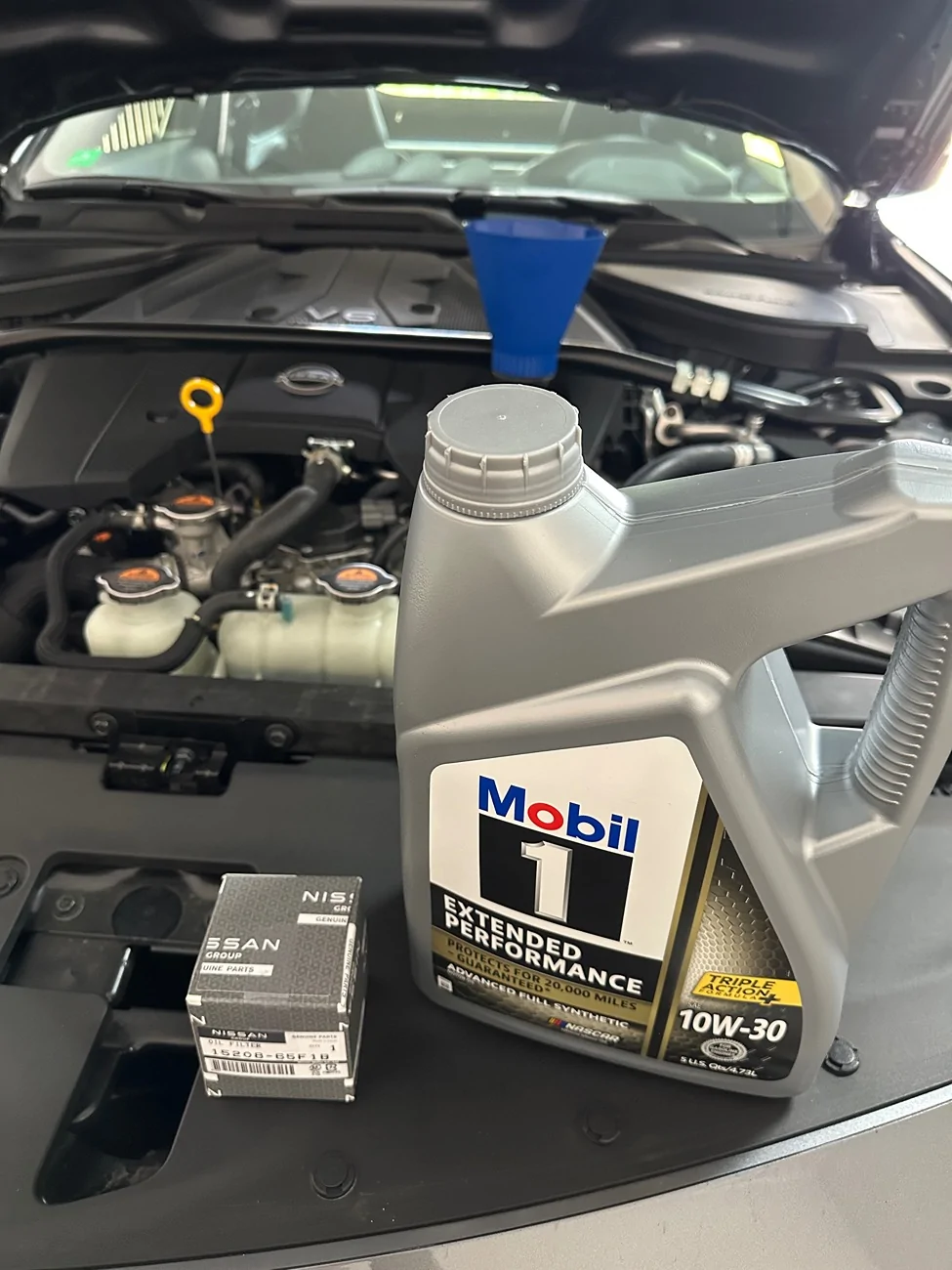

Oil Recommendation

M1 @ walmart or Amazon…
