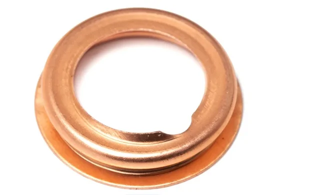

Quick question about putting on the washer. Does it matter which way or which side you put the washer on? Because both sides are different.
Other questions:
When you put the new oil filter back on, do you only tighten with your hands or do I need to use a tool to really tighten the oil filter?
When I tighten the screw back on, how should I tighten it?
Thanks!

Crush washer: larger side towards the oil pan
Oil filter: hand tighten

I changed my oil 5 times and still using the same crush washer - lol
i hand tight the oil filter and then give it another 1/4 turn with the oil wrench.
I change the crush washer when I feel like messing with it. Maybe one out of 3 times. I only tighten the filter until snug with my hand then a little extra umph with my hand. I've never had a leak from a drain bolt or filter.
I have a bag of washers - not sure why i dont use a new one every time. Maybe next time. I have a ‘14 taco with ~250k miles and i maybe have changed the washer 3-4 times -lol

I made the mistake of buying the NISMO magnetic oil drain bolt, it comes with washers that are meant to be re-useable , and they have an integrated rubber o-ring. Next oil change I am getting rid of it , I think it is a bad design personally. I like the stock crushable copper washers myself, I think they are a good design. I'm starting to question the NISMO parts , the NISMO radiator cap I bought is a lower pressure than the OEM ones , the idea is that aftermarket rad caps are supposed to be higher pressure, not lower. I'm not using it.
