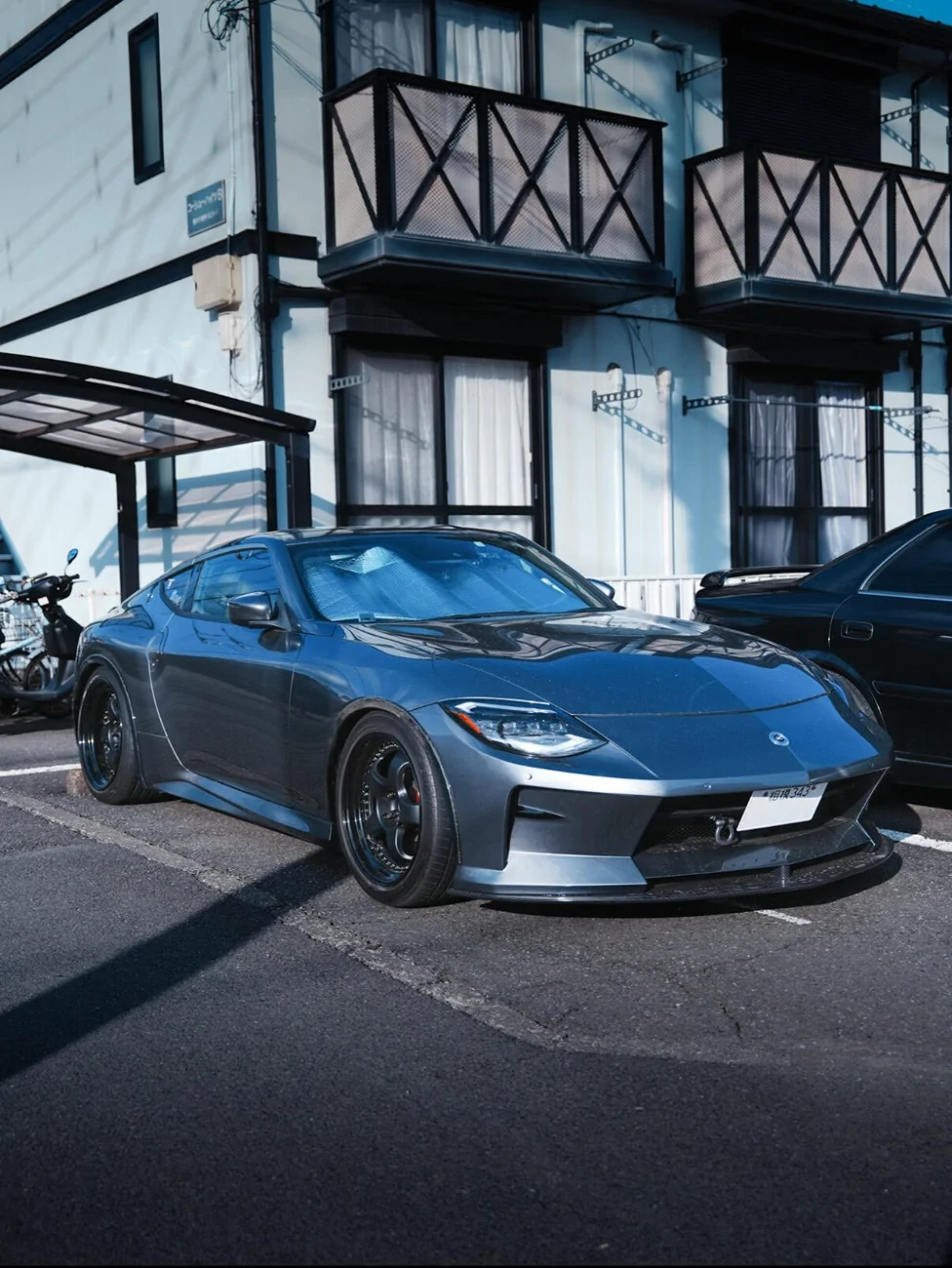

Did you get the front diffuser with this bumper? I saw the pics on the Libertywalk website but they only had the full bodykit on display. I'm curious to see just the front bumper with their diffuser
No I didn't order the diffuser, it be good looking but road condition at my town is terrible, so I gotta make sure to minimize the damage. (might coat the bumper later as well) Also here is a pic I found before purchasing the bumper, it has the diffuser with it too, maybe this can help you take a better look.

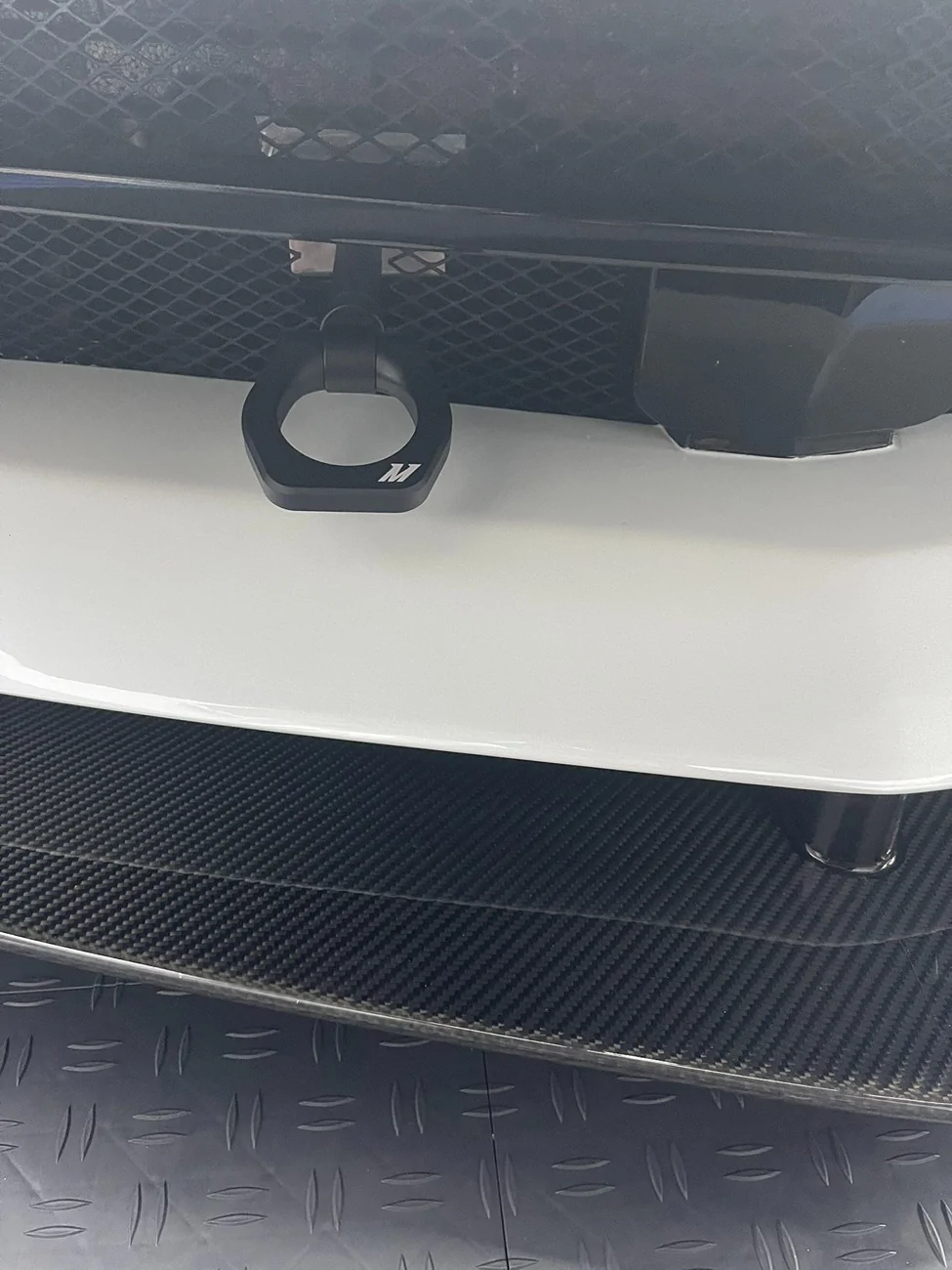

I have had the full kit for basically the entire life of the car. I have had zero issues with any safety features. The only annoyance is that it blocks the front tow hook location. I am working on finding someone local to make the solution I've come up with for the issue.

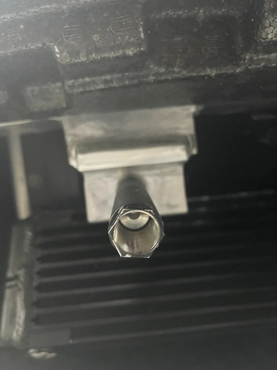

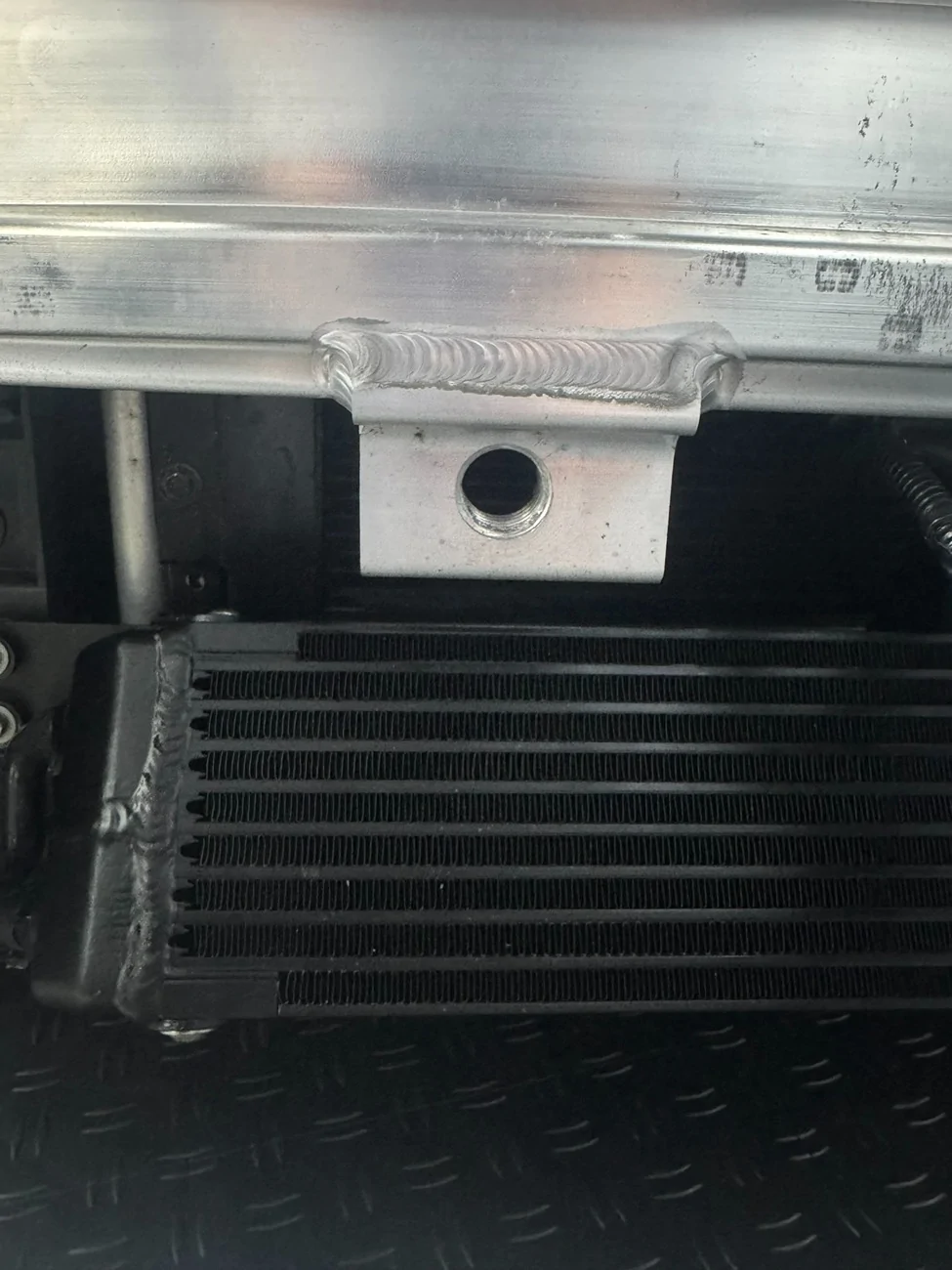

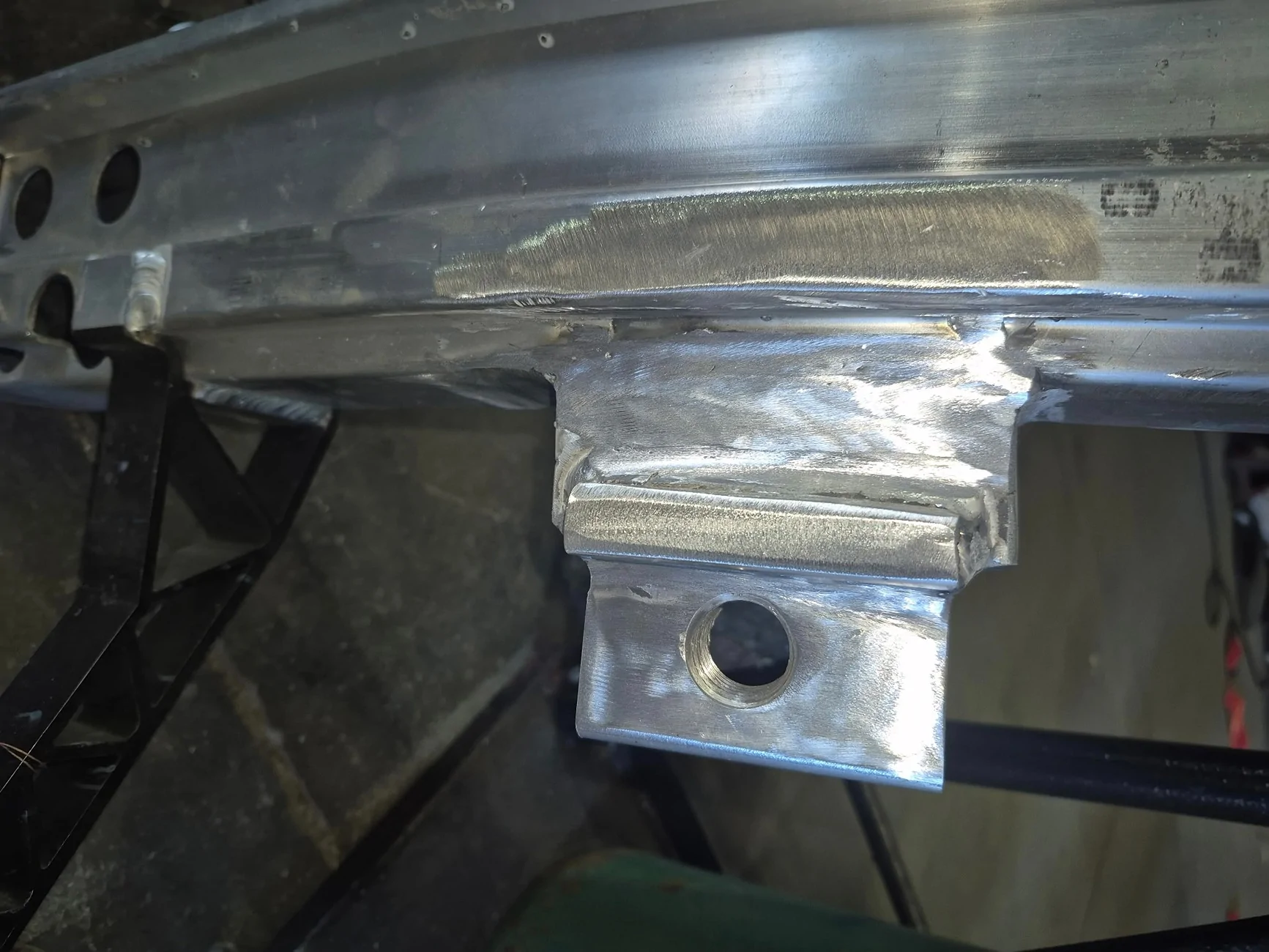

Finally got my tow hook installed. We ground off the welds of the original location, and welded a 1" block of aluminum in the same spot. Then welded the original bracket to the new block. Plenty of clearance from the bumper cross brace so no rubbing or contact. I included a picture of the factory mount location for comparison.
