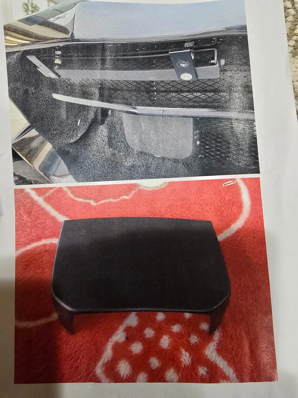

nice, i also would like this front bumper, fitment was good? was it a plug and play or was some cutting needed?
It needed some slight changes, do be careful with the stock radar systems, its cover needed to be in place along with the radar. Also the edge needs drilling, because it doesn't come with stocking hole fitment. You'll need to use a module to measure and drill the fitting holes yourself. I kept having radar proximity problems still.

Its strange you are still having problems. I have had zero issues. I know the front crash detection module is very sensitive. If it was dropped or even handled poorly it could have broken it.

I'll post my instructions from Libertywalk when I get home, they now recommend you cut the fiberglass radar cover out and rivet on the stock plastic cover, I'm guessing because people were having these issues.
Yeah I ended up doing what you suggested, the stock cover works well unless it's raining. Proximity alert kept happening while the rain droplet drips down the surface.

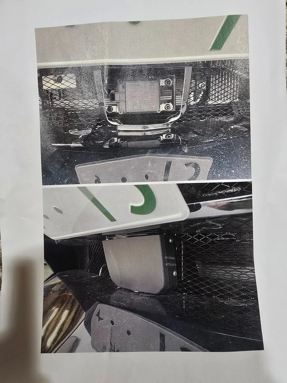

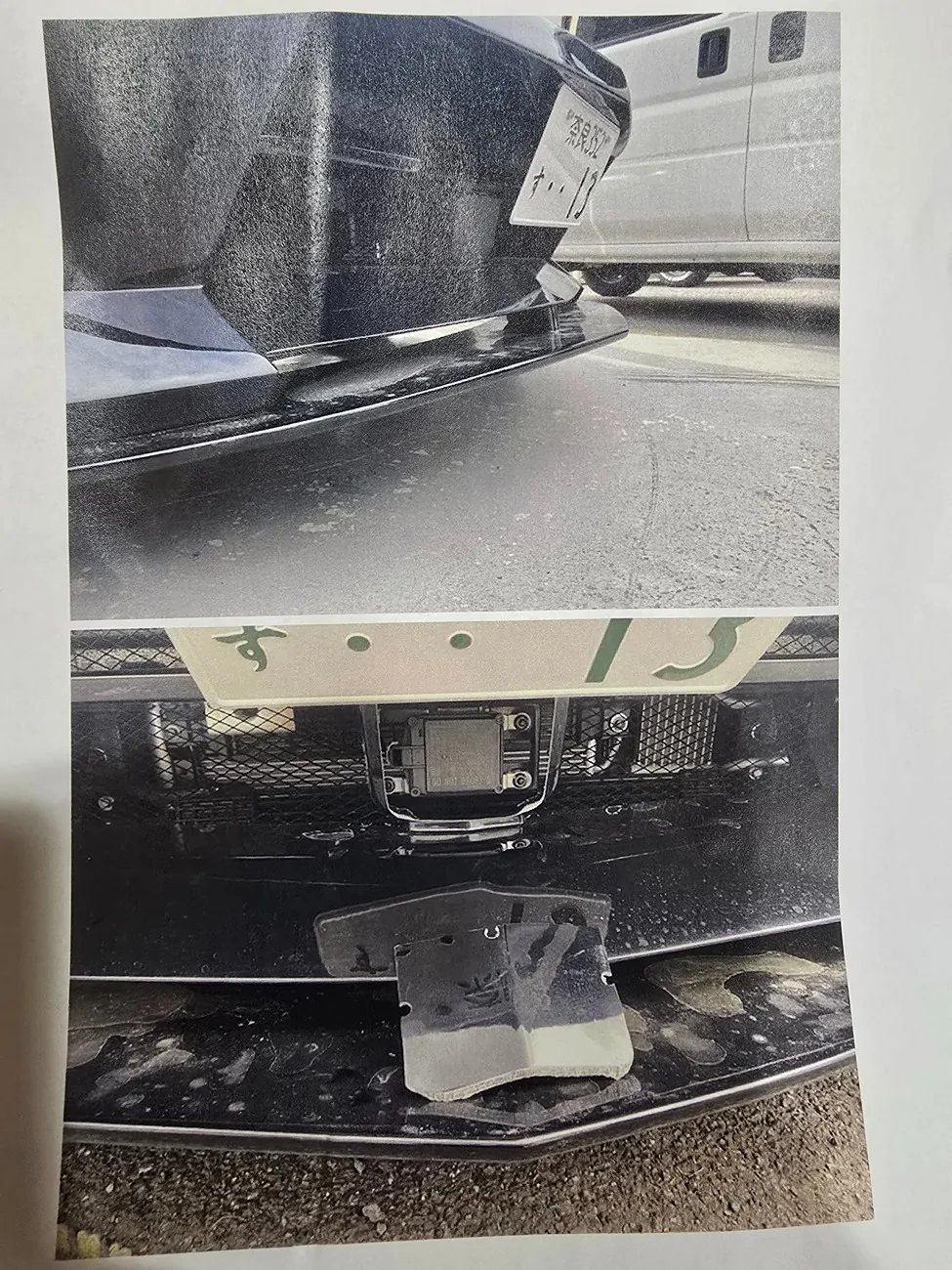

These were the instructions I got with my kit, no words just photos, but it looks like they removed the fiberglass cover and riveted on a cover from a stock performance bumper. Sorry this took so long to upload ive been busy.
