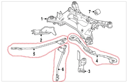

I tried to figure out differences related to trans mounts/bracing and diff mounts/bracing. WAY too much time on parts.nissanusa. I may have found one thing that could be tied to diff bracing/rigidity, but not sure.
I could write a thesis on this. Not about the rigidity differences. It would be about NISSAN's dumpster fire of a component structure. To get to the point, I'll say their "Vehicle Fitment" info is...'hot garbage.'
The image above are rear cross-member parts, #1 being the rear cross-member itself.
Pretty sure the diff tucks up in there.
Items 1, 2, 3 and 7 are shown used on all '23-'25 models. #7 is the rear diff mount and there are no subcomponents. So if that's a diff 'rigidity/mount/bushing' thing, if there's only one part for all, meaning that wouldn't play into any rigidity/stiffness differences.
If this is correct, this is literally the only useful info in this entire post. And even that is useful only for the 1 or 2 people who even care.
-> Items 4, 5 and 6, they say, are specific to the '24 Proto (doesn't show the '23...?) and '24-'25 NISMO. I do not know where these connect. If any connect to or play with the diff, then maybe that's the 'increased stiffness.'
They list 4 different diffs, which makes sense, open/LS x MT/AT (final drive difference). BUT...I was under the impression that the NISMO has a larger capacity cover that's more aggressively finned. And the Sport doesn't have a diff temp sensor mounted to the cover. If the NISMO has "firmer bushings" (speaking of the two on the input/front of the diff) wouldn't there be another full assy with the firmer bushings? Oh, maybe the input side bushings are separate? Well, yes, you can buy them separately. There's one part number. Just one. For all years/models.
So how come only 4 different full diff assys? It also says both the MT versions (open and LS) are used on all years and models. (open/MT used on the '24-'25 NISMO. Nope.
I'm not even going into the Hellscape that my transmission mount search turned into. I give up. This has left me markedly less sane. Hoping it's temporary.
