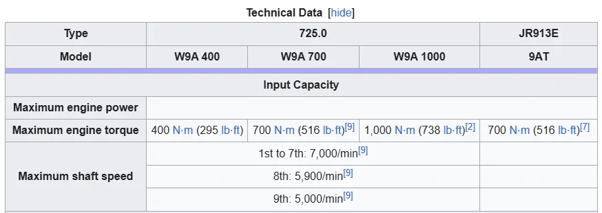

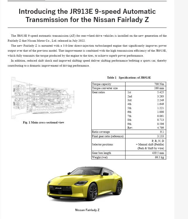

700NM ~ 516 LB-ft
pretty good trans to handle extra power, however other components would definitely need to be upgraded to actually make use of the added power.

I guess the upgrade on the Nismo trans with the clutches and all would help as well hopefully.
