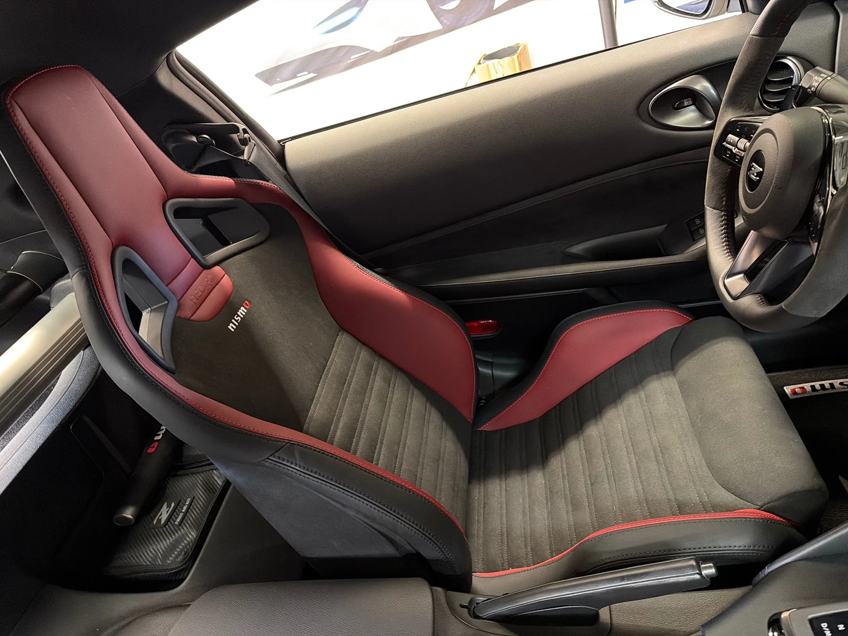

I replaced the stock seats from my Nissan Z Performance MT with Recaro SR-S. Feels very much OEM but way better driving position. Lumbar support is good with ample lateral bolsters for spirited driving. This new release Recaro SR-S were specifically designed for modern-day sports cars with low driving position such as the Nissan Z RZ34

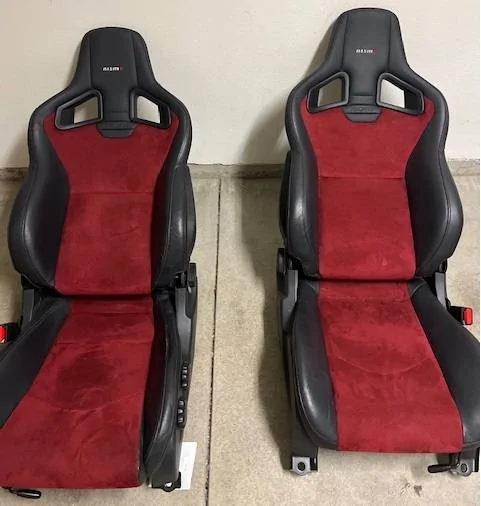

I lucked out and found used Nismo 370z seats. They bolt right in and had same harness as the RZ34 Sport. It was straight plug-and-play.
My own regret is not re-tightening the assembly as the seat is a bit squeaky.

Good to know the harness is identical, seat airbags are also compatible then. Those seats fit much better for me. I would lose the power adjustments in my Performance, wonder if the harness is also plug and play?. Did you compare weights?
duckieZ
Stan
May 30, 2025
Irvine
2025 Nissan Z Sport
@trackratZ
You would lose power adjustments as the motors are on the seat on Performance trim. I don't think you would cause a DTC for disabling power functionality. The harness is different for sure and the rails.
I did not weigh the Nismo but they felt about the same if not slightly heavier than the Sport seats, they will definitely be lighter than the Performance seats.
