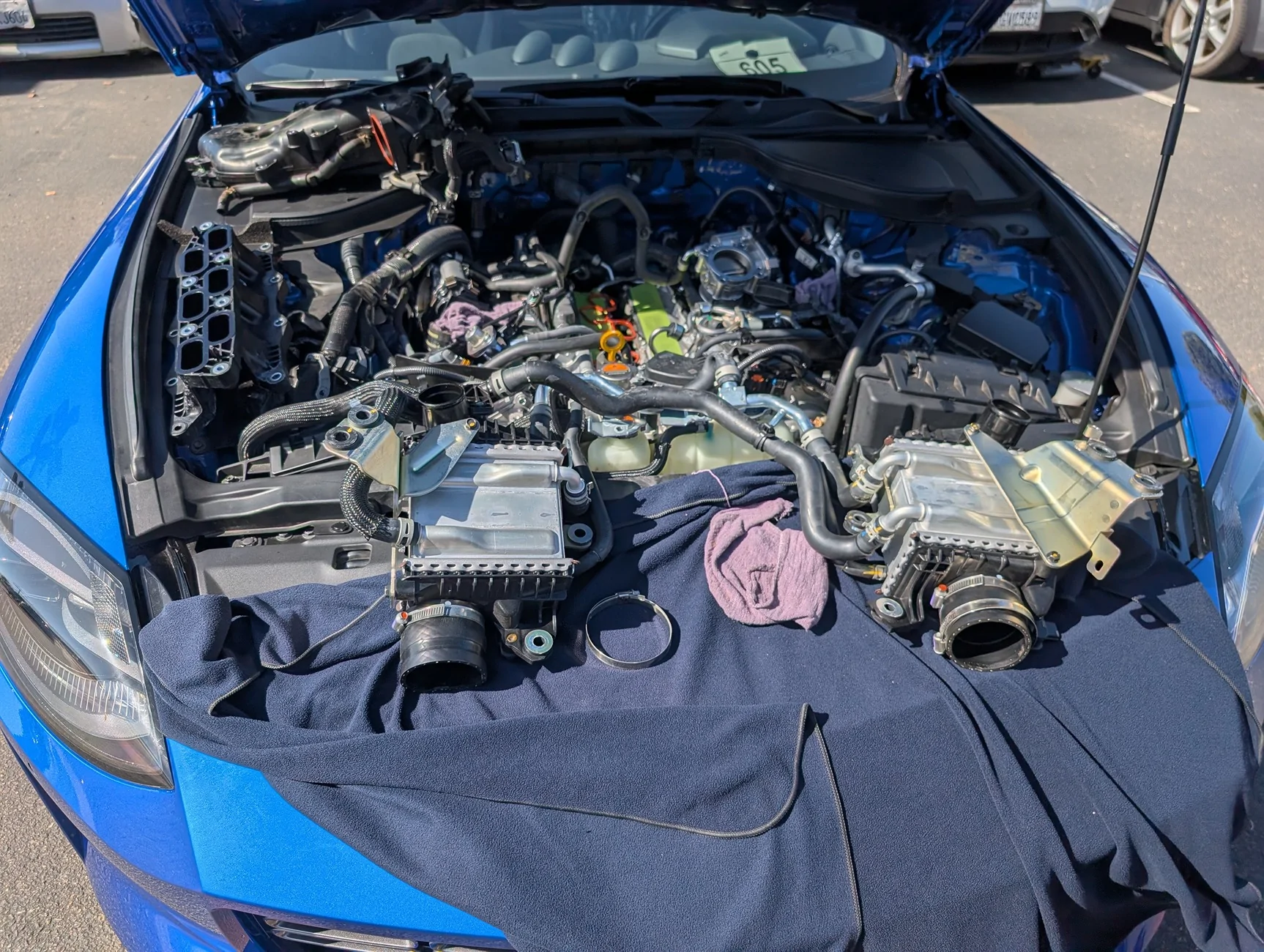

Another update:
Car is disassembled waiting for parts. I'm driving a Nissan Kicks loaner. It's interesting to see the shared DNA in the digital instrument cluster.
Could this have been the problem all along?
@FSUZ33, it could be. The first repair fixed an upstream fuel line. This made the gasoline smell worse. Then that was repaired, but the smell didn't go away, but it was much more subtle. I'm hyper aware now, and this may be the occasional whiff I got when I was trying to remember if I'd ever smelled fuel.
Heh… at this point, I’d be seriously wondering if this service department has a clue as to what they’re doing.
Maybe best to go to another dealer, sounds incompetent to me, yikes!
Even though this has been a pain in the ass, I'm going to cut these guys some slack. They probably suspected one thing and tried a fix. That repair was bad, granted, but they corrected it. This leak is in the orange "O" ring, deeper into the engine. They might not have been so inclined to go that deep without trying the earlier fix. Who knows? Maybe both parts were leaking.
In any event, I hope they get it all back together, that it drives like it did before, and stops leaking.

Another update:
During all this I've been researching other cars in case I bail on the Z. Some cars I researched back in 23 are off the market, some cars have shown up on the market, but I feel like the Z fills this nice niche: huge bang for the buck. I'd be hard pressed not to buy another one if this car just isn't the same afterwards.

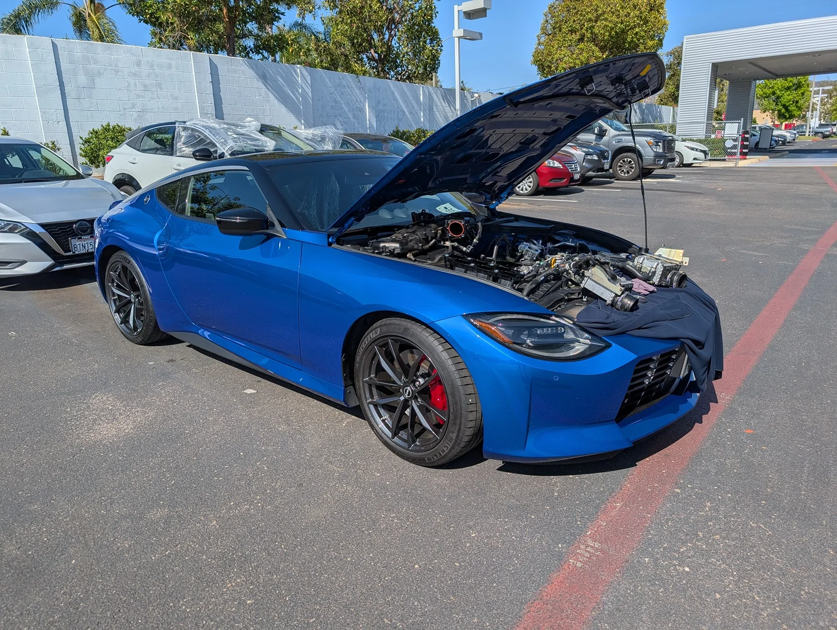

Hold up. I know the SD weather is PERFECT. But garages (dealerships!!) do repairs OUTSIDE? And leave the car disassembled OUTSIDE????
Well...yes.
They diagnosed it while it was in a "bay", and then rolled it outside because they needed the bay for other cars. They'll roll it back into the bay overnight, they said. You can see the intake ports into the heads are covered with tape (yellow in the photo), so the internals of the engine should be safe (I hope no spiders crawl on there).
I put "bay" in quotes because the bays are basically outside themselves. It's a high roof, a closed back wall (south). The east wall, at one end of the bays. The west wall, at the far other end, and I'm not even sure if there is a door on the north. There must be, but maybe it's always open. So the techs work basically outside. I'll try to remember to take a picture next time I'm there.

Well...yes.
