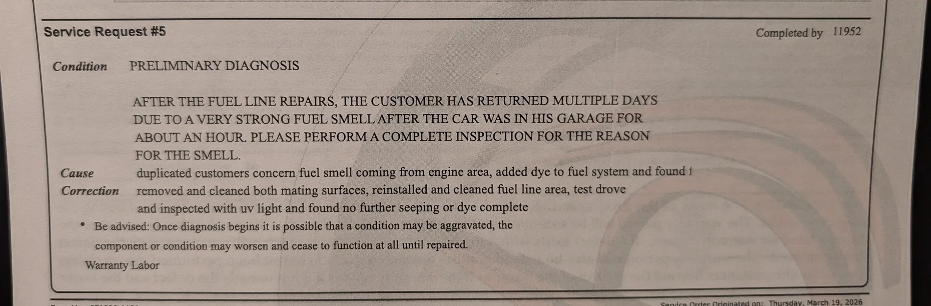

Update on my case: The car is back from the shop and the problem seems to be resolved. I guess it's not so easy to install the replacement part correctly.
(Interesting that the printout seemed to chop the "cause" data.)
Will definitely keep an eye on this going forward. It seems like a potentially dangerous point of failure.

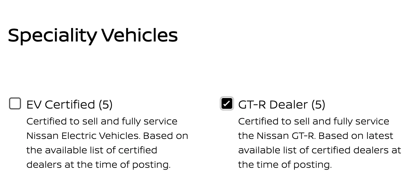

and last thing for all, always try to request the highest trained most certified tech work on your car. I know we don't all own GTRs but this dealer locater has a filter for GT-R Dealers. could help
Great point. I'm very pleased with my Service Adviser and Tech at my local Nisan dealer. Both are very sharp, well trained, know their stuff, and pleasant to work with. The Service adviser makes sure I'm always assigned their specially trained GT-R tech and he's very familiar with the Z.

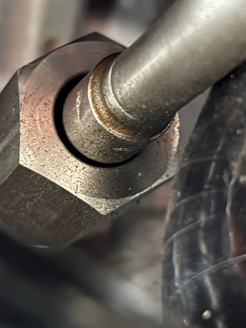

I also had to tighten the lines after the HPFP - all leaked from factory.
Of course I cad to go look - the right side rail seems to be leaking again- left side clean and no residue.
