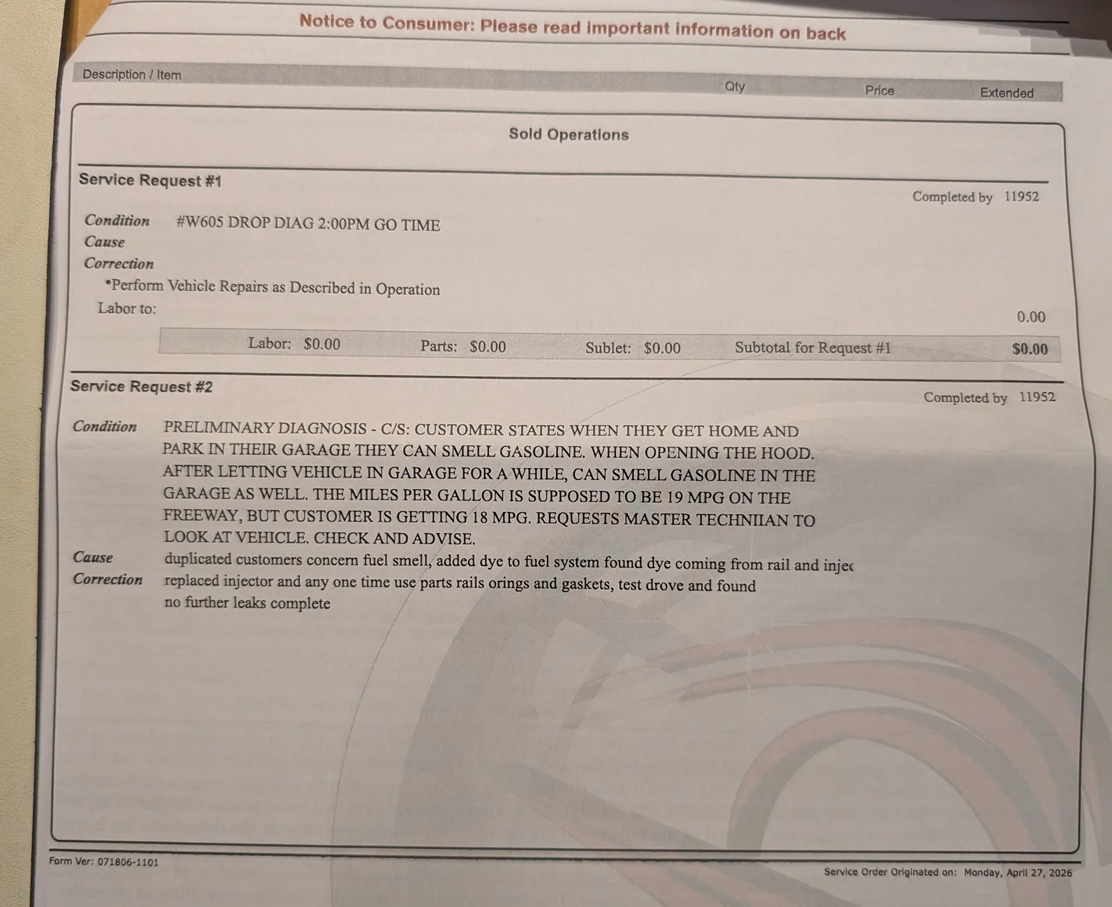

Good news! I have my Z back now. I'll review the paperwork in a bit, but the summary from the service advisor is, "Deformed fuel injector caused leak. They replaced it along with several one-time-use parts, and it's good to go."
When I picked it up, it was registering 16mpg. The car itself was experiencing lower than expected mpg anyway, and they probably ran the engine stationary a few times while fixing, and maybe spilled some fuel from the system, etc.) All of this was a side effect of the leak. When I dropped the car off at the shop a week ago, it was struggling to get over 19mpg.
So I went straight to the gas station and filled up, reset the trip odometer, and drove to work in mostly heavy street traffic. She got 22.3mpg on that drive. This leads me to think the fuel leak may have been an issue for longer than I knew because I don't think I've ever seen milage that high on the street. Now that all the fuel seems to be going where it's supposed to go, the mpg is higher than it's been in awhile.
Maybe she's fixed now.
I'll post some screenshots of the repair paperwork when I get a chance to go through it.
This was all covered under warranty, which expired while the car was in the shop. I may rethink my position on an extended warranty.

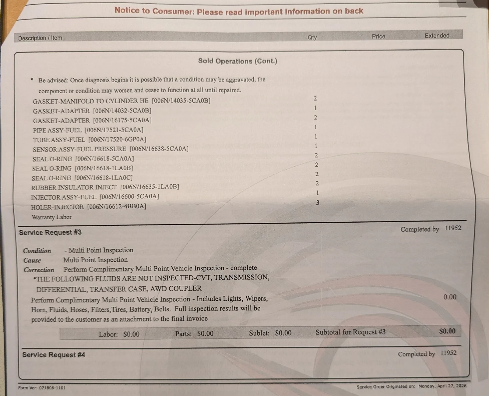

Update on this. I wanted to share this some time back, but I've been traveling, busy at work, walking the dog, driving the Z, blah, blah, and blah.
It's been a couple of months since I got the car back and it seems to be fine now. No more gasoline smell, mpg is back where it should be, car is quick as snot.
Here's the repair report. This was all fixed under warranty, which was in force when the car went into the shop and expired when I picked the car up. I'm living on the edge now.

$492.57 performed on 3/13/2026 for a car that went in service on 4/28/2023.
Fuel system finally repaired on final visit, in the shop on 4/27/2026, returned to me on 5/5/2026.
