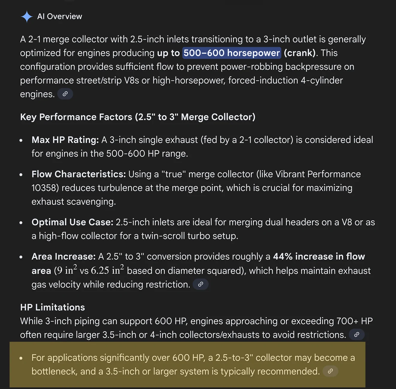

Looking at the remark setup, two 2.5ā€œ pipes (5ā€ total) necked down into a single 3ā€ merge collector. what is the 3ā€ merge collector hp limit @ 17+ psi boost? The only reason I’m looking at the remark setup - i love how smooth / straight their lines are - the fewest bends of the bunch. but I’m not sure what hp the 3ā€ collector is good for.

no concerns with the AWE. My concern is wih the remark 2.5 piping into a 3ā€ collector. any idea what the HP limit for a single 3ā€ merge collector?

AI to the rescue. Looks a 2-1 (2.5ā€-3ā€) merge collector is good for ~500-600hp. Iā€˜m sticking with 93 pump & stock fuel system, so remark should be good to go…
