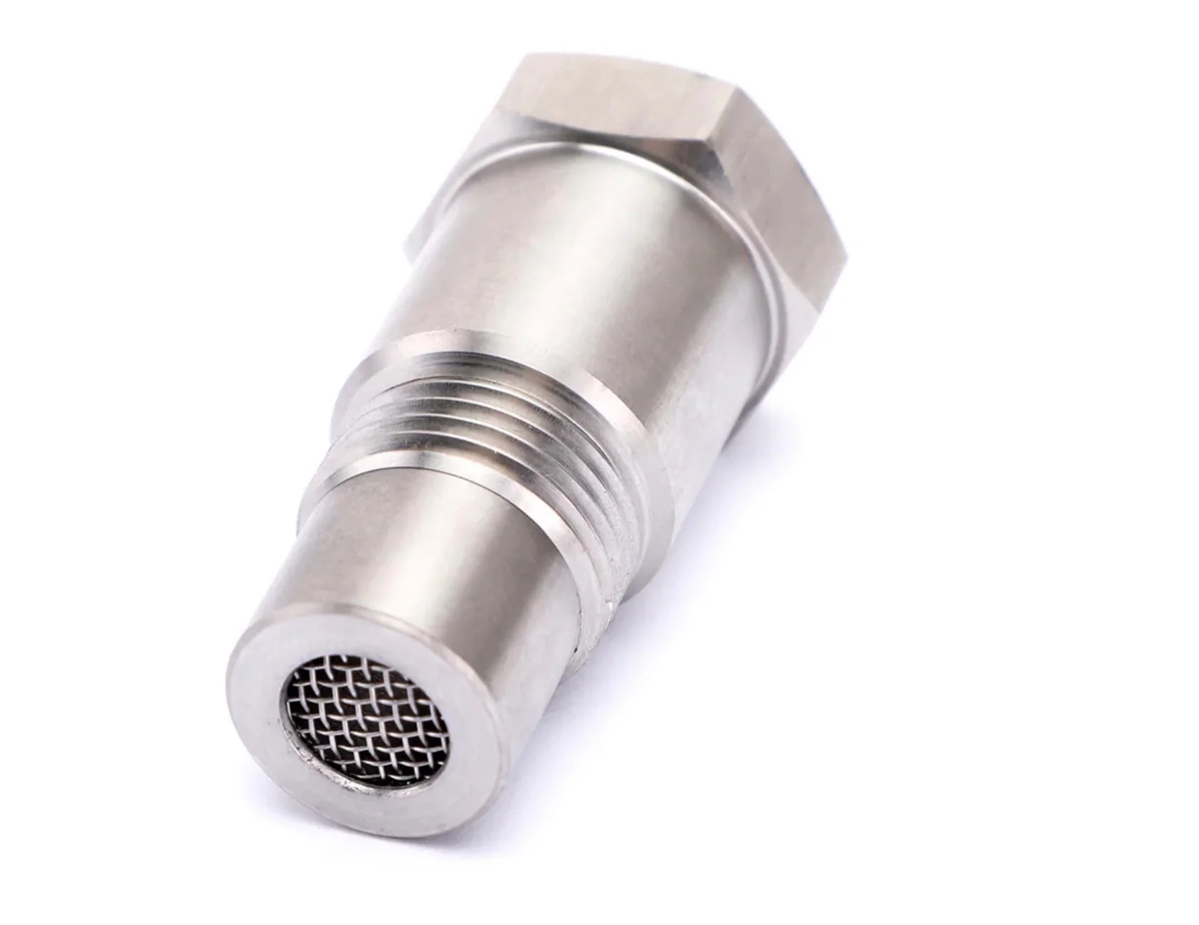

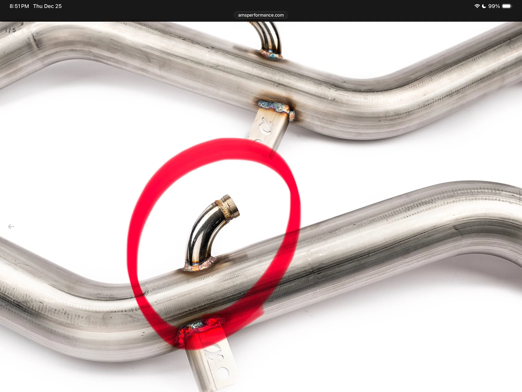

it should help but no guarantee, it’s an old fashion lawnmower spark plug defouler or o2 sensor extender. This is why ams has the extended o2 bung welded into the pipe for you.
You can also pack the extender with steel wool. The best solution is to have a tuner to disable the o2 check in the ecu.
Never saw this before - thanks. Are they all the same size / thread pitch?
I’ll give it a try.
I’ll give it a try.
Z should be M18 x 1.5mm - a common lawn mower spark plug thread size.
the secondary o2 acts like a temperature probe - if it heats up to fast, it will throw a CEL. So the extender keep it from heating up too fast. The steel wool helps with damping temp rise to prevent spikes on startup.
Maybe AMS put abit more engineering into the placement to make it act more like OEM

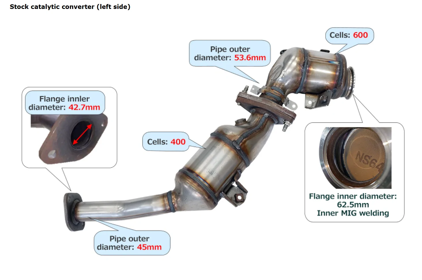

Thanks for the info.
Can you confirm the weld joint (from upper cat to the upper’s exit flange) is the same (2.75ā€) as the flange exit point or is the weld joint smaller as it appears in the picture.
Ok so i can't measure the flange as i'm not taking off the LDP but ive got the gasket which is close enough.
LDP - UDP Gasket is 2.6 inches.
LDP - UDP flange is 2.2 inches.
LDP - Exhaust is 1.75 inches
i measured the UDP - LDP Flange and it was about 2.75 inches, i didn't see a 2 inch restriction. The gasket could be slightly smaller as its joining 2.75 inches to 2.2 inches.
The most optimal path would be getting a 2.5 inch exhaust and LDP but i don't think there would be much restriction on a 3 inch system either. Replacing the UDP is ALOT!!! of work and not worth IMO unless you get to the stage of swapping turbos and then it would be an engine out job anyway.
Whoever designed this needs to go home and look in the mirror.
Thank you for the info. if the udp exit ID is 2.75ā€, the upper cat / flange weld joint ID should still be ~2.5 even with weld drop thru & shrinkage. So catless lowers it is.

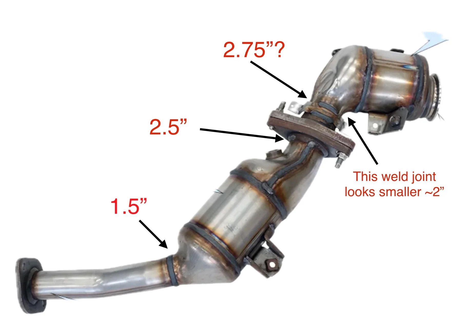

There is only one sensor per side and its the lower. The Upper will still do its job and wont throw CELs
I went full for both, switch over to catted to prevent 1. bad smell and 2. Rasp. The hi flow cats will perform just as good as catless
Thanks for posting this diagram.
If these dimensions are correct, the ID of the upperā€˜s neck down weld joint is ~2ā€?
The upper’s exit flange ID maybe larger but the weld jointā€˜s ID is smaller and the bottle neck. So if you keep the upper, there is no advantage going with a 4ā€ vs 5ā€ X-pipe?
if you go with full dps, then you would need a 5ā€ X-pipe?
I think the location of the arrow in the diagram is wrong. It should be pointing to the upper neck of the LDP which is measured at 2.2 inches and then would drop to about 2.
There is no way it drops From ~2.75 to 2. That's definitely not what I saw.
5" diameter? That's a bit overkill for fdp
I would just match it all the way through?
