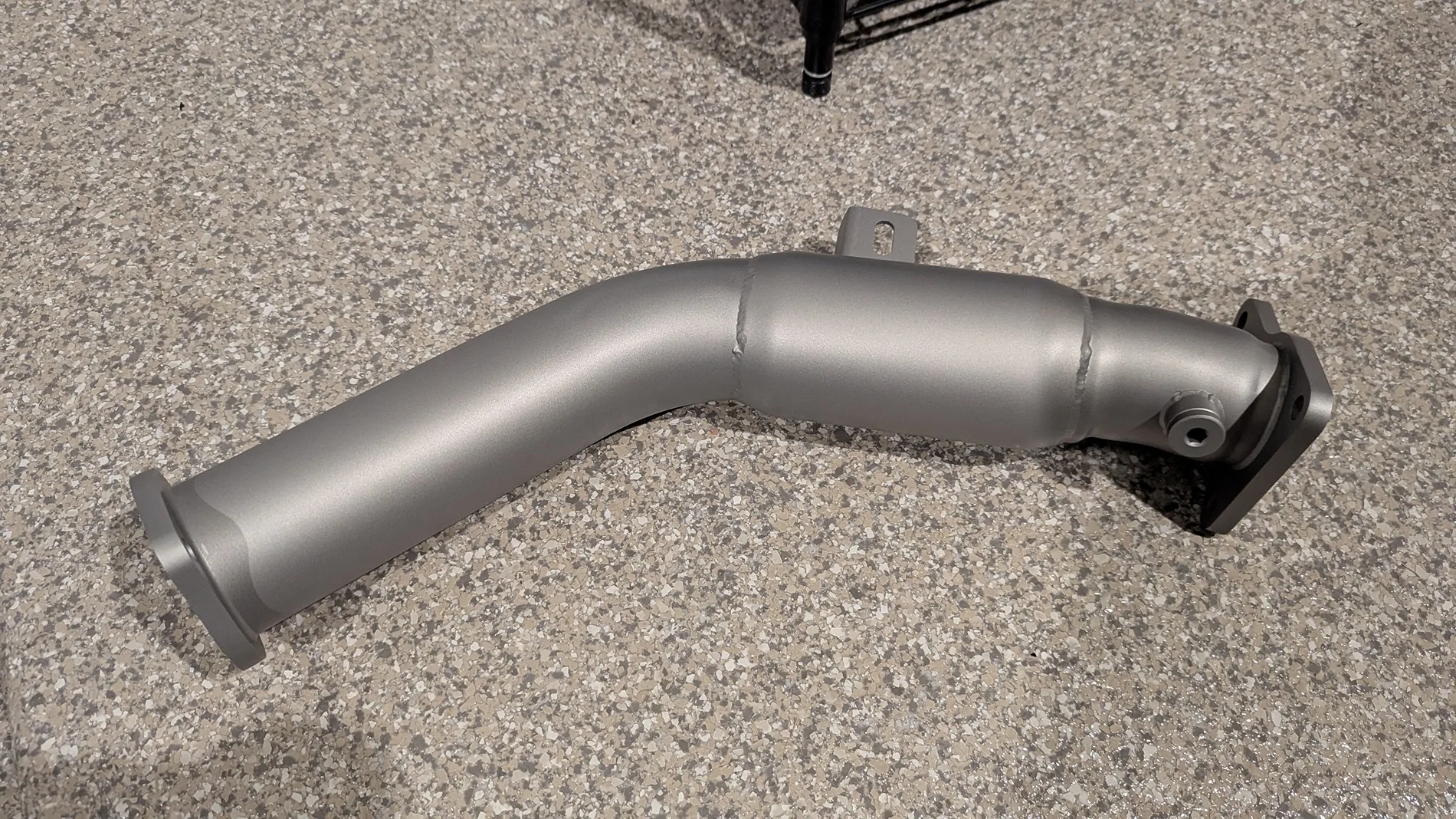

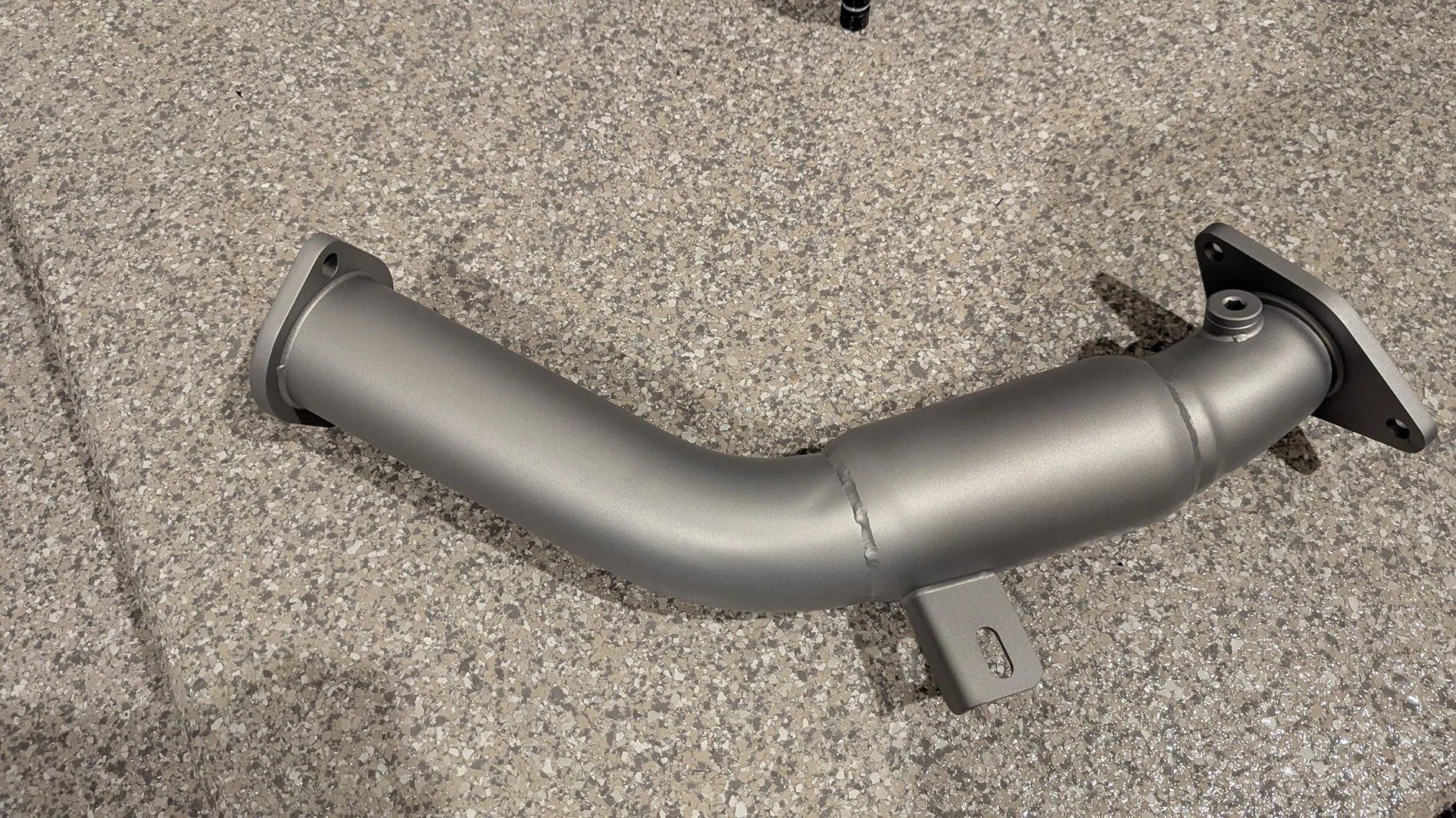

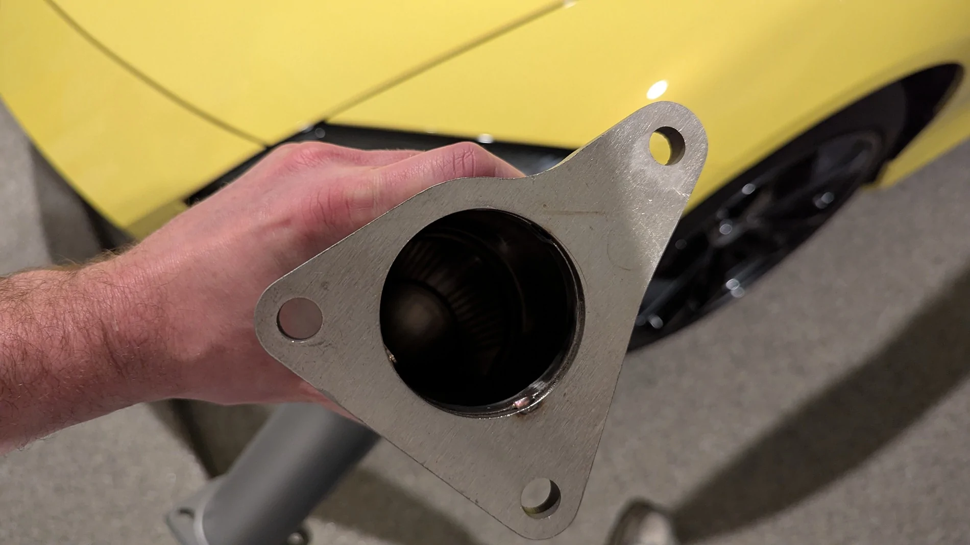

I picked them up from the coater on the way home from the airport today!
SPOOL 3.0" resonated LDPs
Inlets measured 2¼" ID and outlets at 2⅞" ID. The titanium coating looks fantastic, especially as this is the highest temp rating they offer.

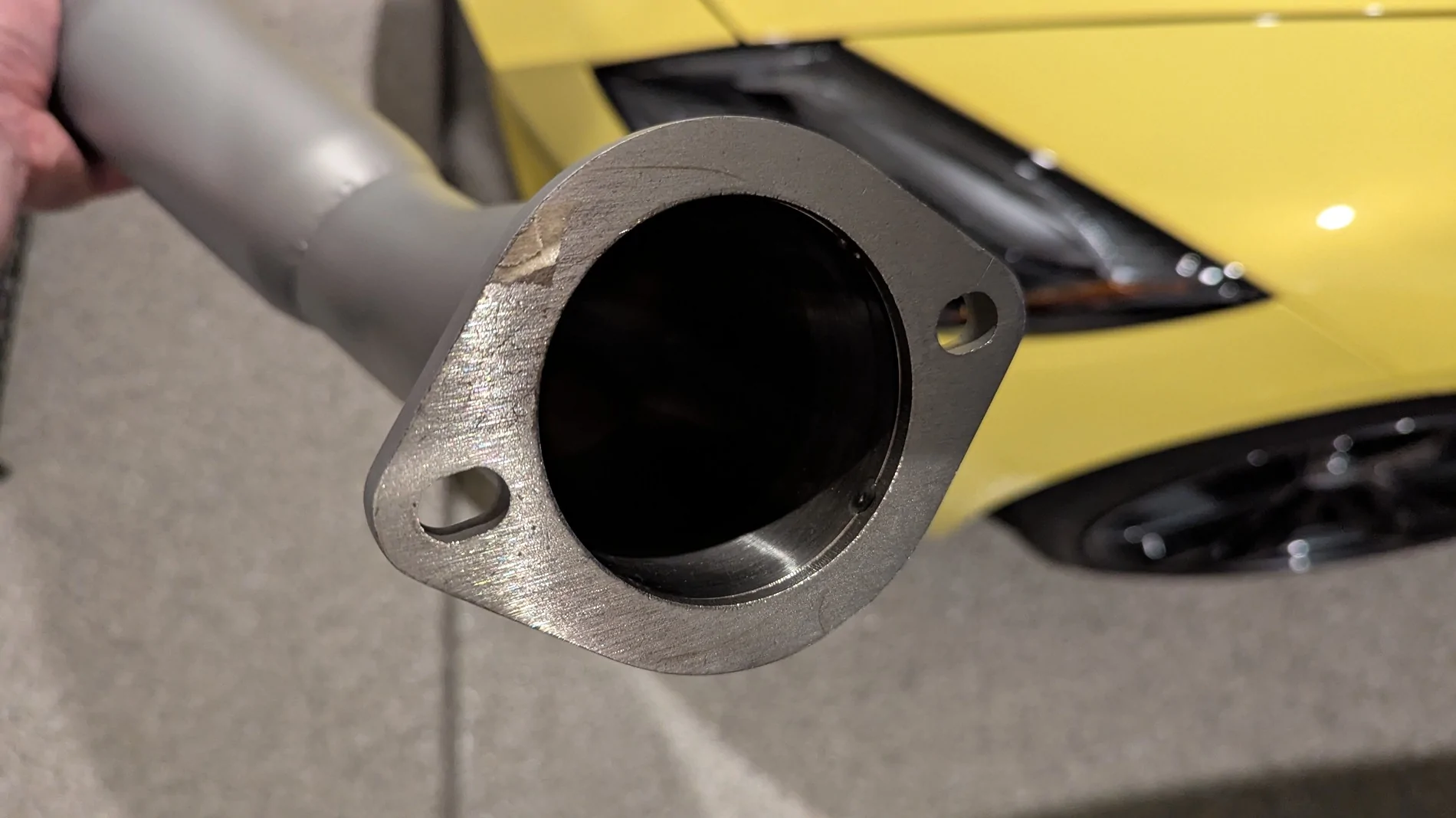

thanks for the measurements. is the inlet pipe OD a smaller dia. - machined down on the flange side and flared out on the resonator side?
I can’t wait for the upper cat outlet measurement

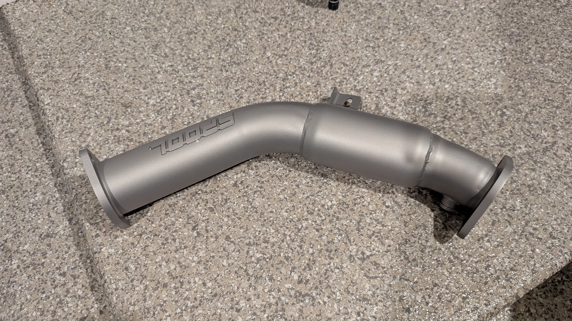

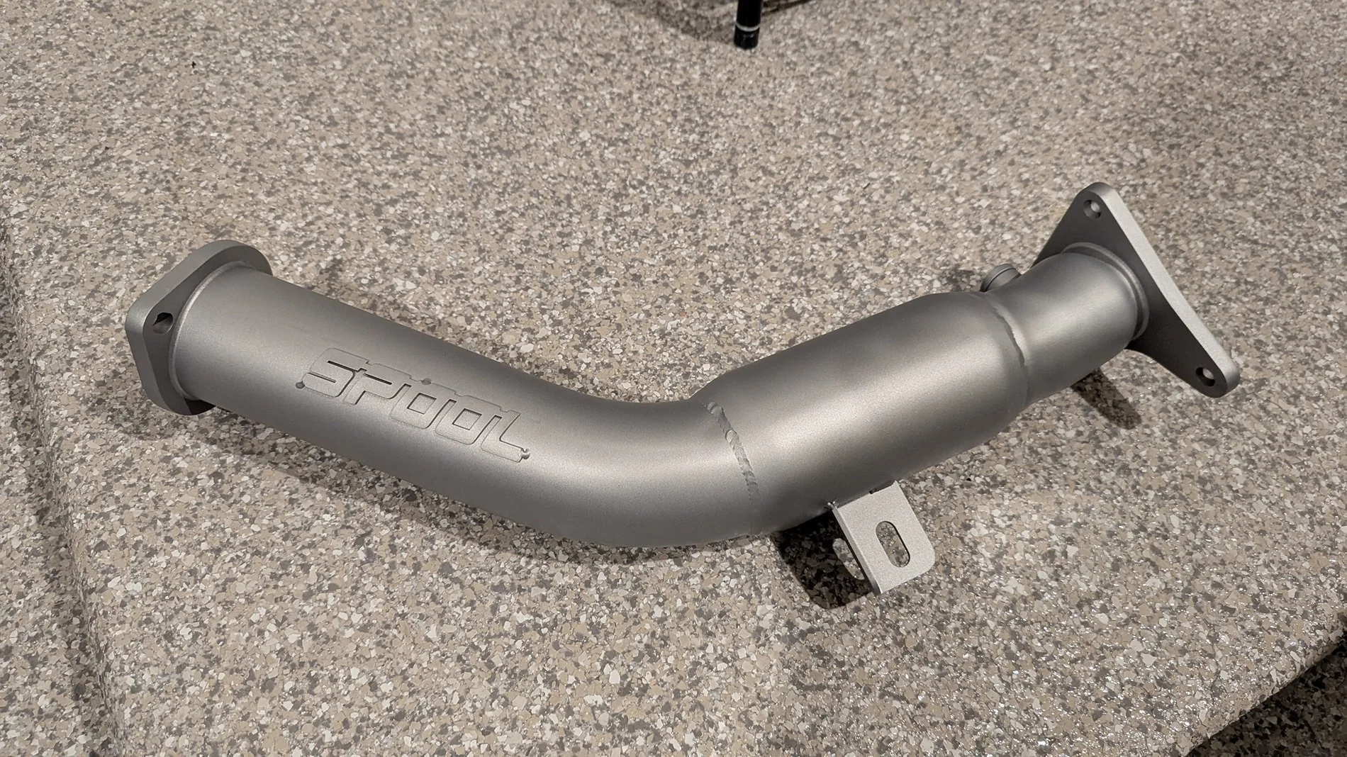

Regarding the inlet, the pipe matches the flange then tapers larger into the resonator. My guess is they started with a 2.5" pipe pre-resonator and pinched/flared it. You can see it in the pictures if you look closely. It's frankly exactly how I'd design mine if I were custom fabricate a set.
