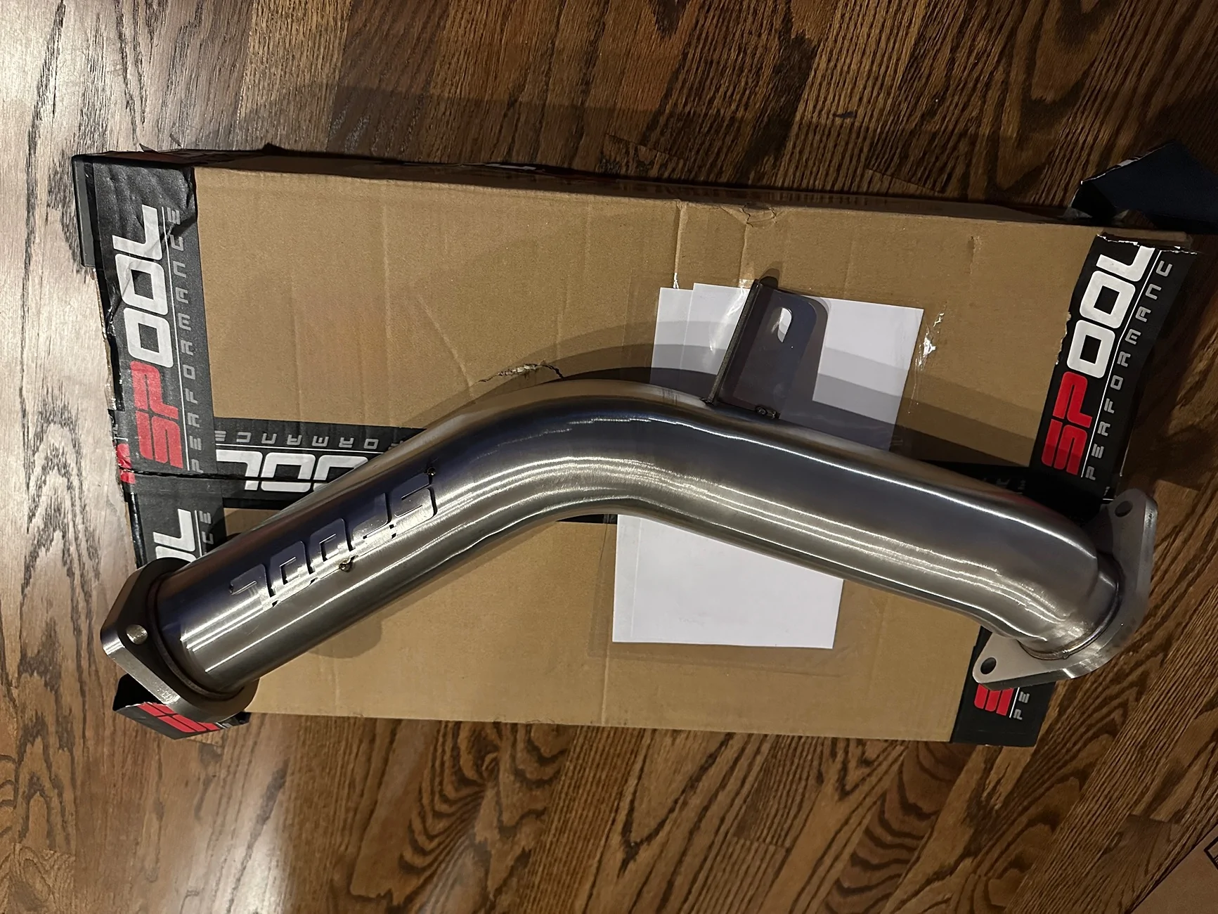

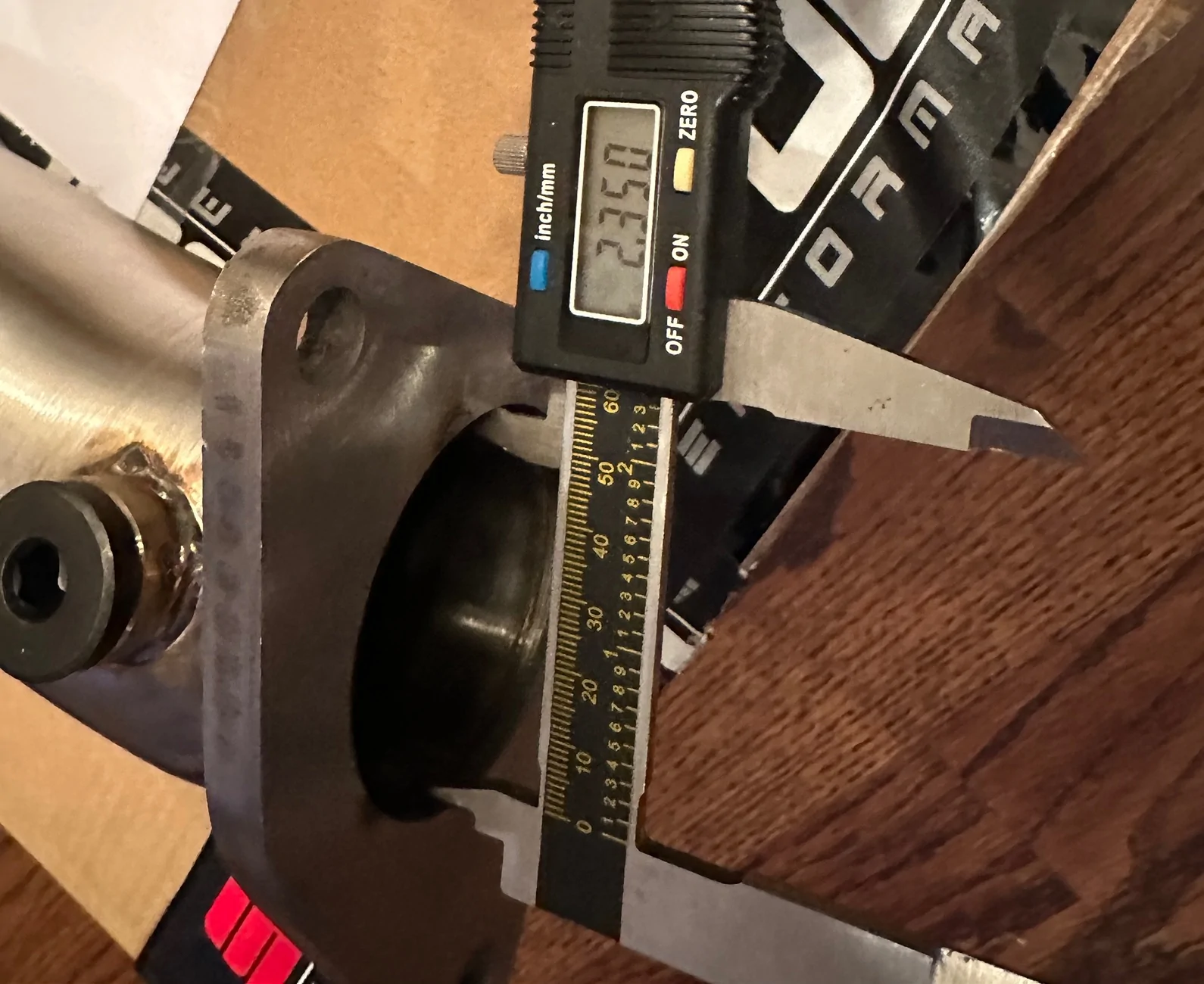

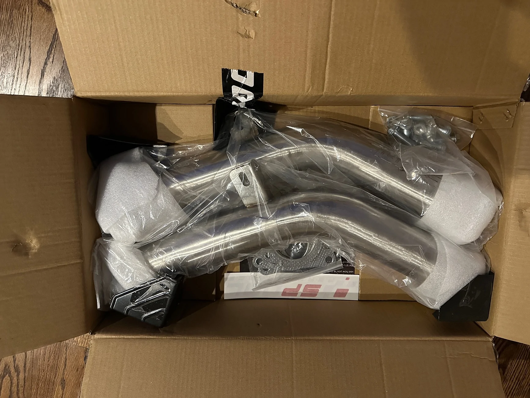

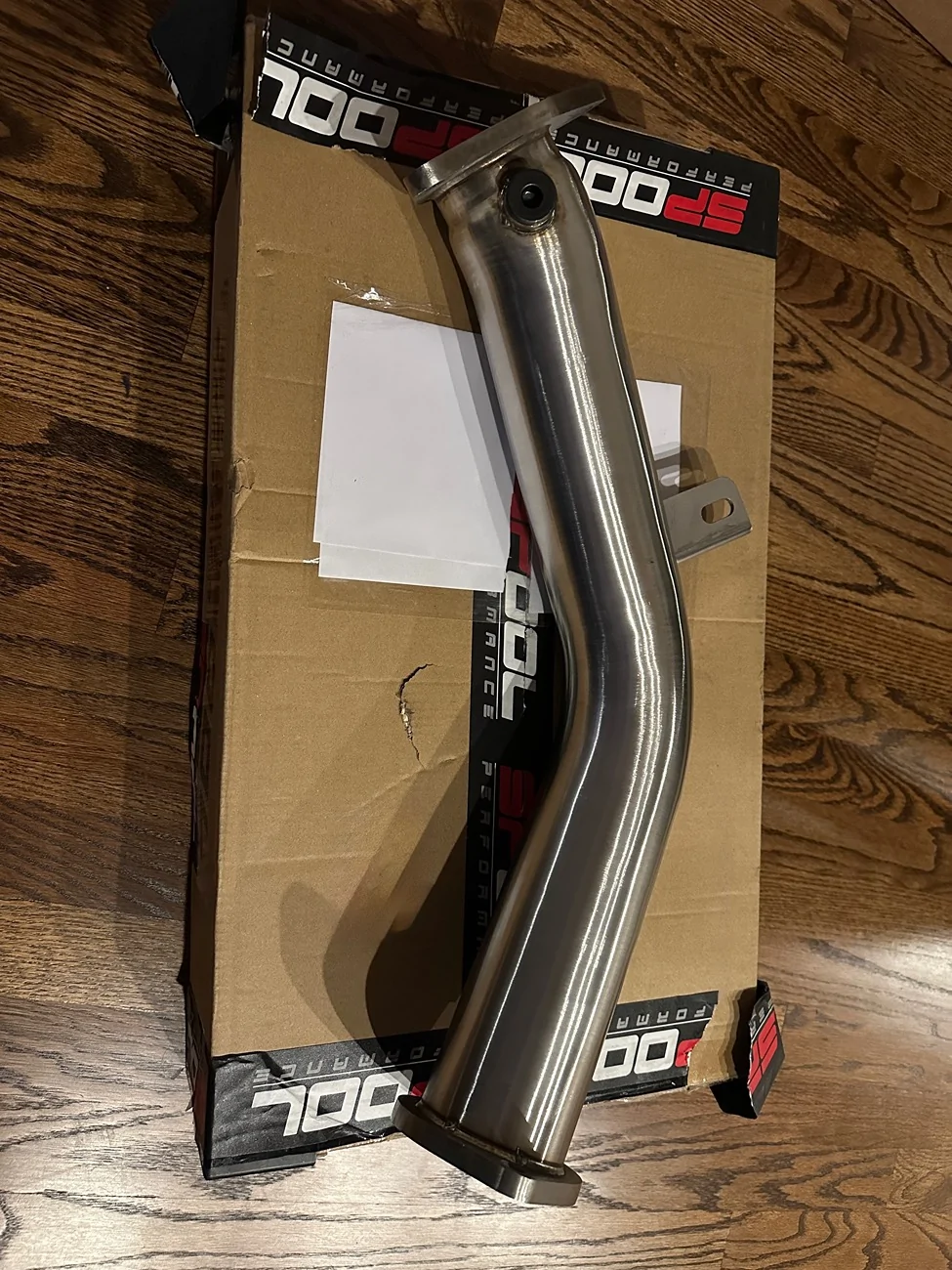

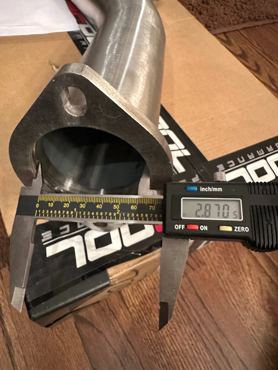

3” lowers delivered from houston, tx.
the inlet flange ID is the the smallest, the inlet tube end is necked down but much larger than the inlet flange. The outlet flange ID is close to the same size at the tube ID.
