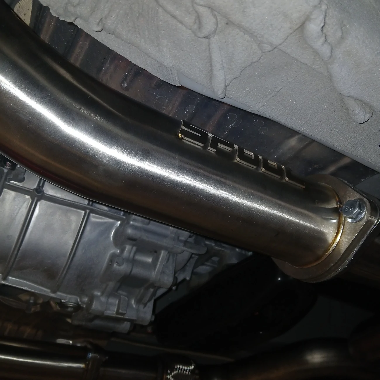

I installed the AMS catless LDP this weekend. The install was fairly easy but time consuming as I did it on jack stands.
I still retained the OEM cat in the UDP not CEL it any issues so far.
The LDP is probably the most restrictive part on the car. It goes from like 2.5 inch down to ~1.5 inch. I measured the UDP at about 2.75 inches going into my 3 inch exhaust.
Car sounds much better. You get abit of a deeper tone, more spoil noise and a VQ rasp.

Thanks for the info. from the pictures, it looks like the upper exit necks down to ~2” OD with the ID being even less.
is the picture different than reality? I was looking at the full dps to get rid of the bottle neck in the upper, but if the upper’s exit is really 2.75” OD exit, I’m going with lowers only.

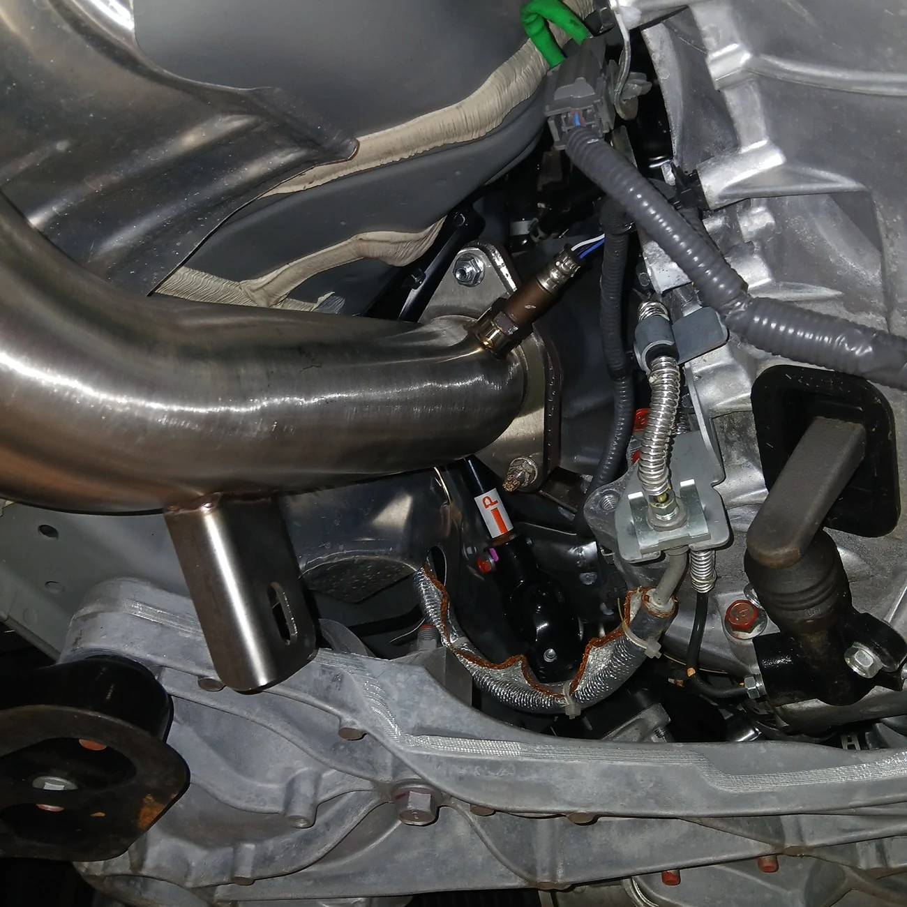

it should help but no guarantee, it’s an old fashion lawnmower spark plug defouler or o2 sensor extender. This is why ams has the extended o2 bung welded into the pipe for you.
You can also pack the extender with steel wool. The best solution is to have a tuner to disable the o2 check in the ecu.

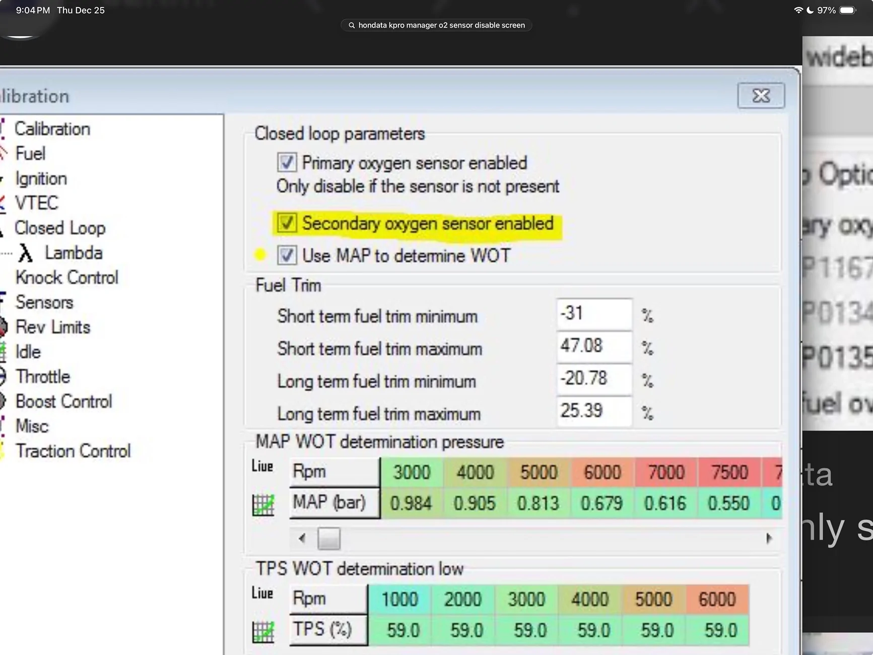

for Honda’s you can do your own tuning using hondata - including disabling the o2 check. When disabled it also reports the cats are present and good for emission checks.
I’m sure an ecutek tuner can do the same for the z - but they are not going to post this info on a public forum. Keep in mind this is for off-road applications only - lol
