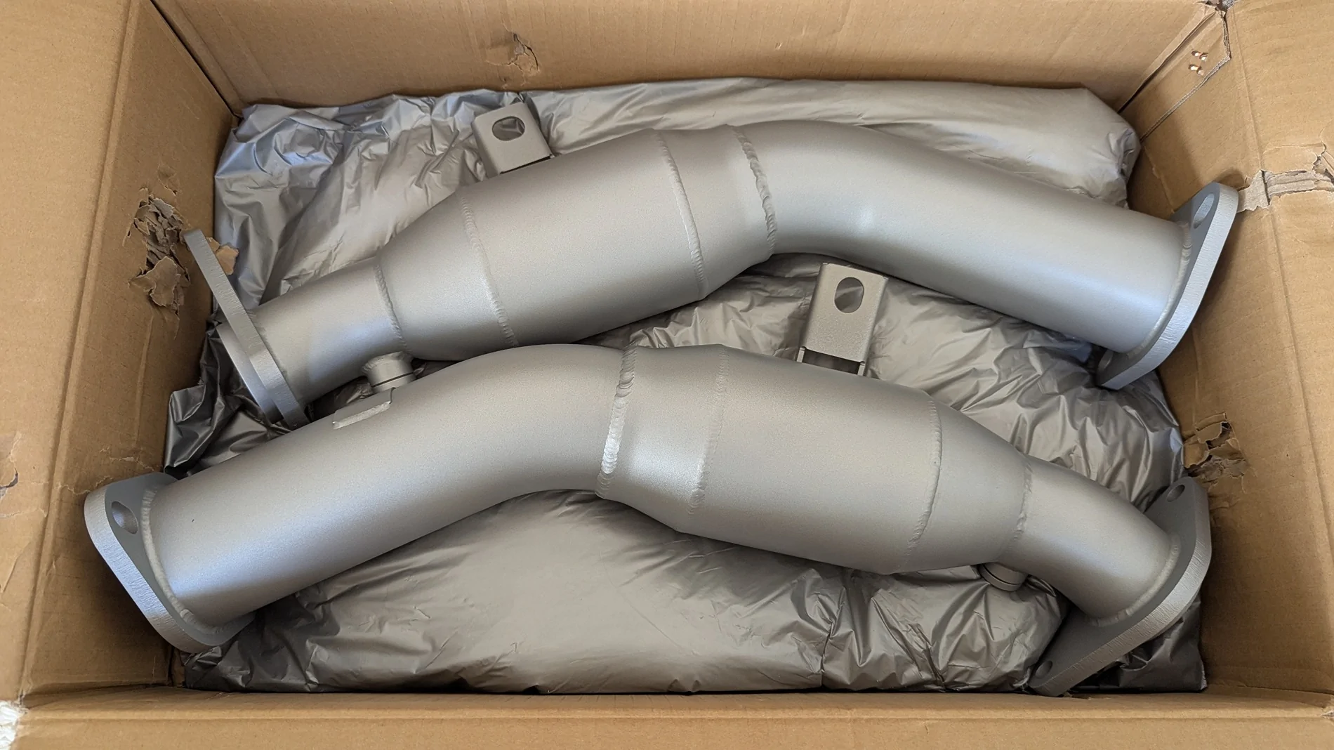

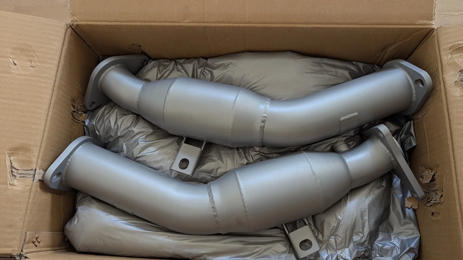

They are the new 3.0" version; received 3/27/26 (pics - before & after ceramic coating).

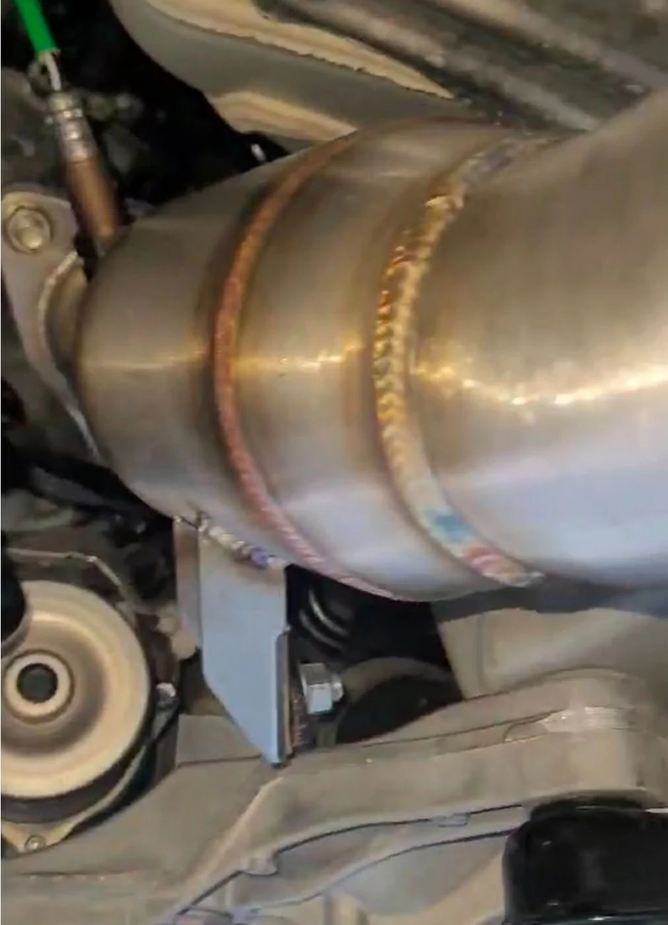

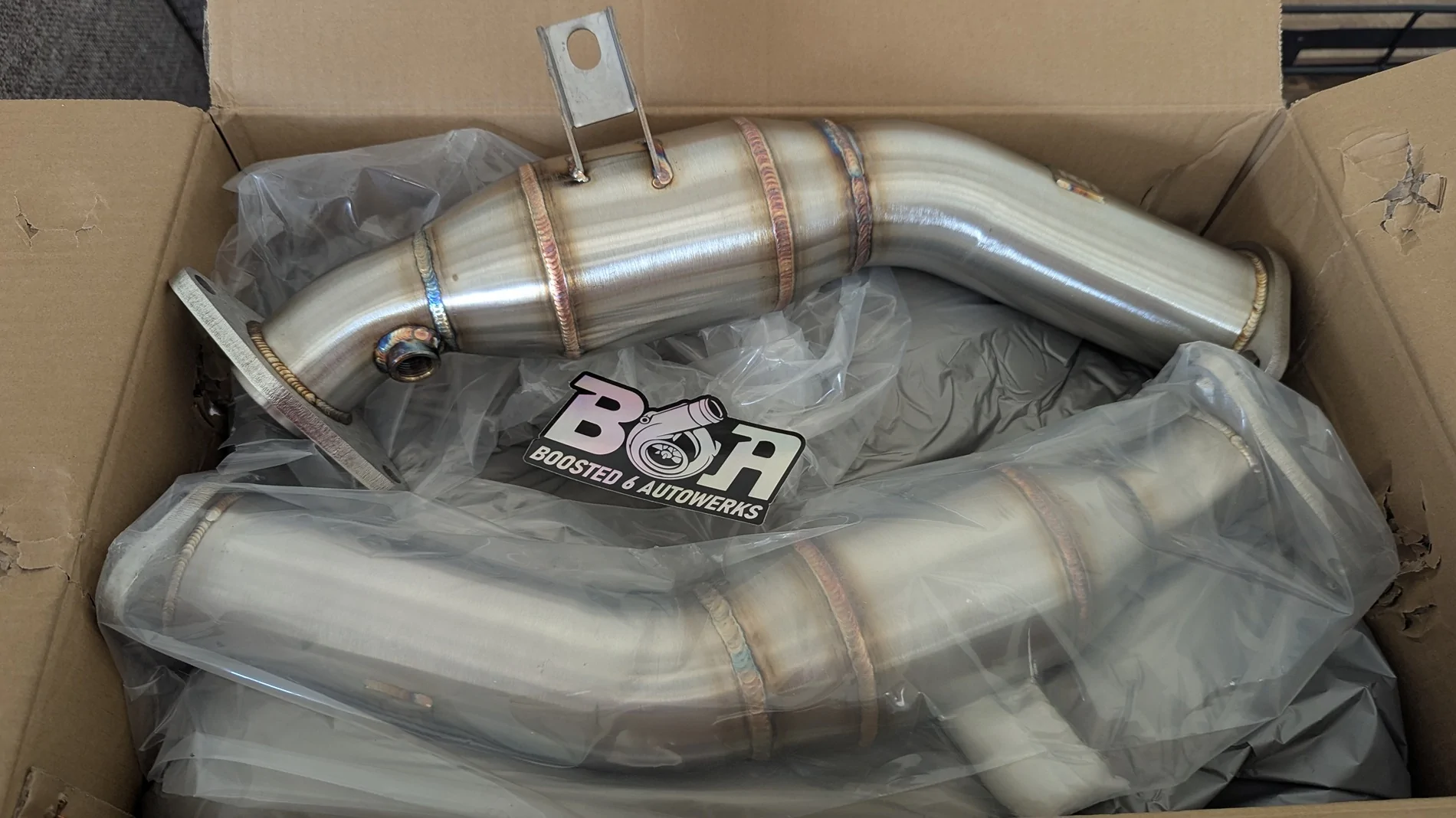

Hey Parash with B6A here. We’ve installed multiple sets of these downpipes, all produced from the same jig with consistent fitment. It’s possible the unit you received may have experienced a slight bracket bend during shipping. We’ll go ahead and retest it on our end and keep you updated with our findings.
We’ve also attached a video and pictures showing proper fitment on a Z for reference.
Sounds good, thank you. RaceBox was also going to take a fitment video so I'll share that when I get it.

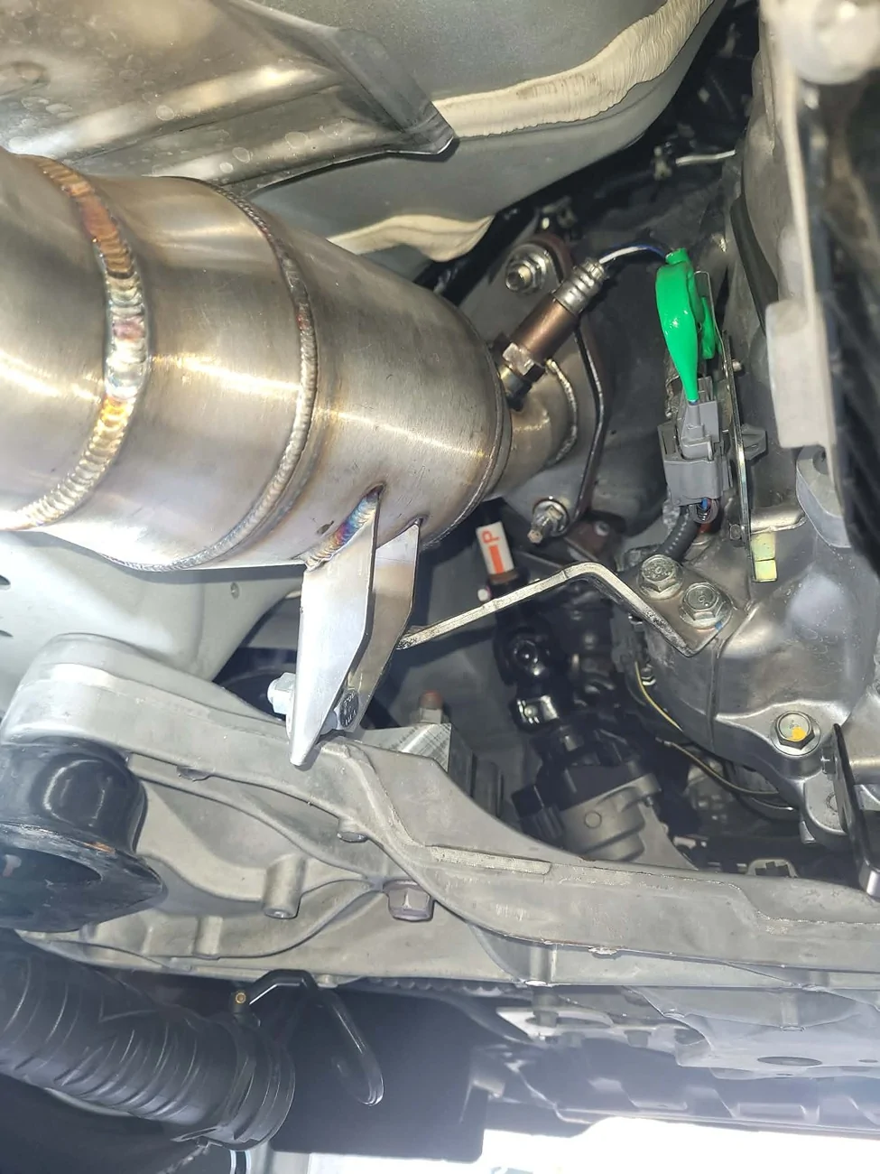

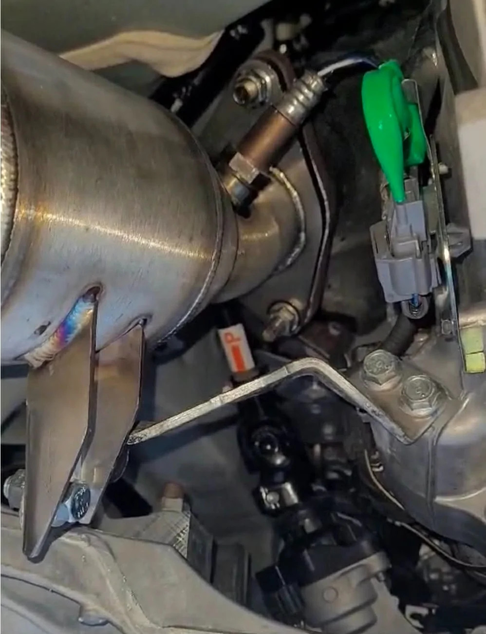

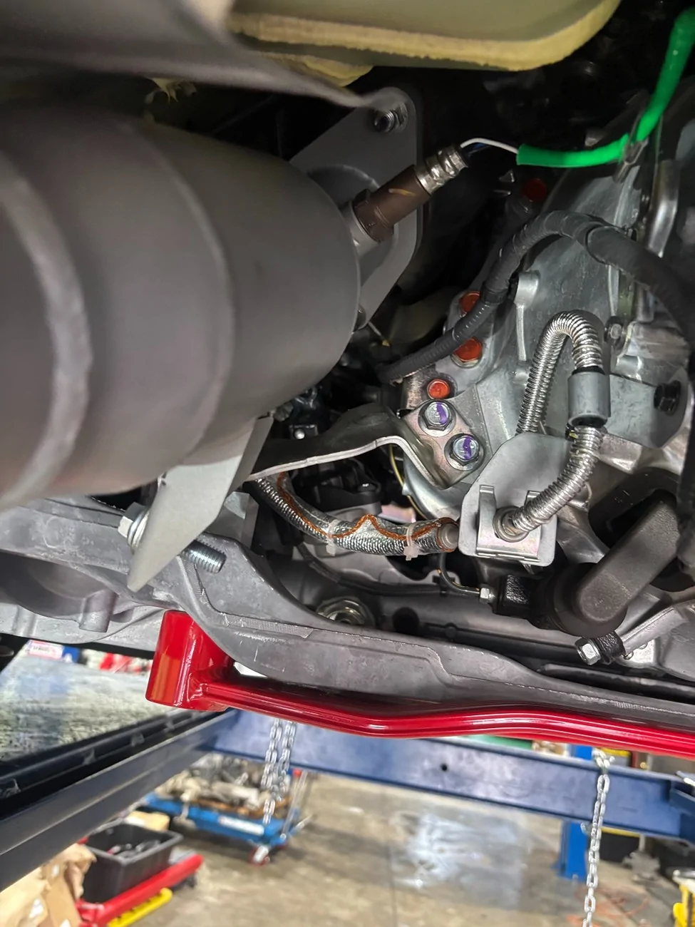

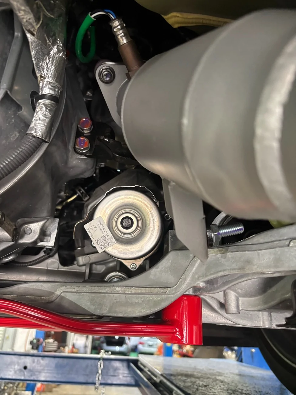

Update #2, and much better news!
RaceBox got it back up on the lift to take another look at it, and with a little tweaking/bending of the brackets, they're now bolted to the mounts.
As far as the sound goes vs. the Spool 3" resonated LDPs...minimal difference if any. Maybe a little quieter at idle? Maybe.

Maybe it’s the camera angles, but the flange welded to the resonator looks vertical in B6A’s pics (6:00 on both), where @KrackaC8ā€˜s look about 5:30 on the drivers side and 6:30 on the passenger side. Am I the only one seeing it like that?

Hats off to B6 pics and calling bs. now it magically fits… ufb…. Assuming the spool fit as well…
That was my original thought after looking at the brackets - can’t be that hard to bend/tweak/beat the brackets into submission.

I agree - my best guess is the oem bracket is bent during the removal process. The bracket (frame side) looks weak and easily bent.
The spool race/non-resonator lowers are reported to fit just fine.
