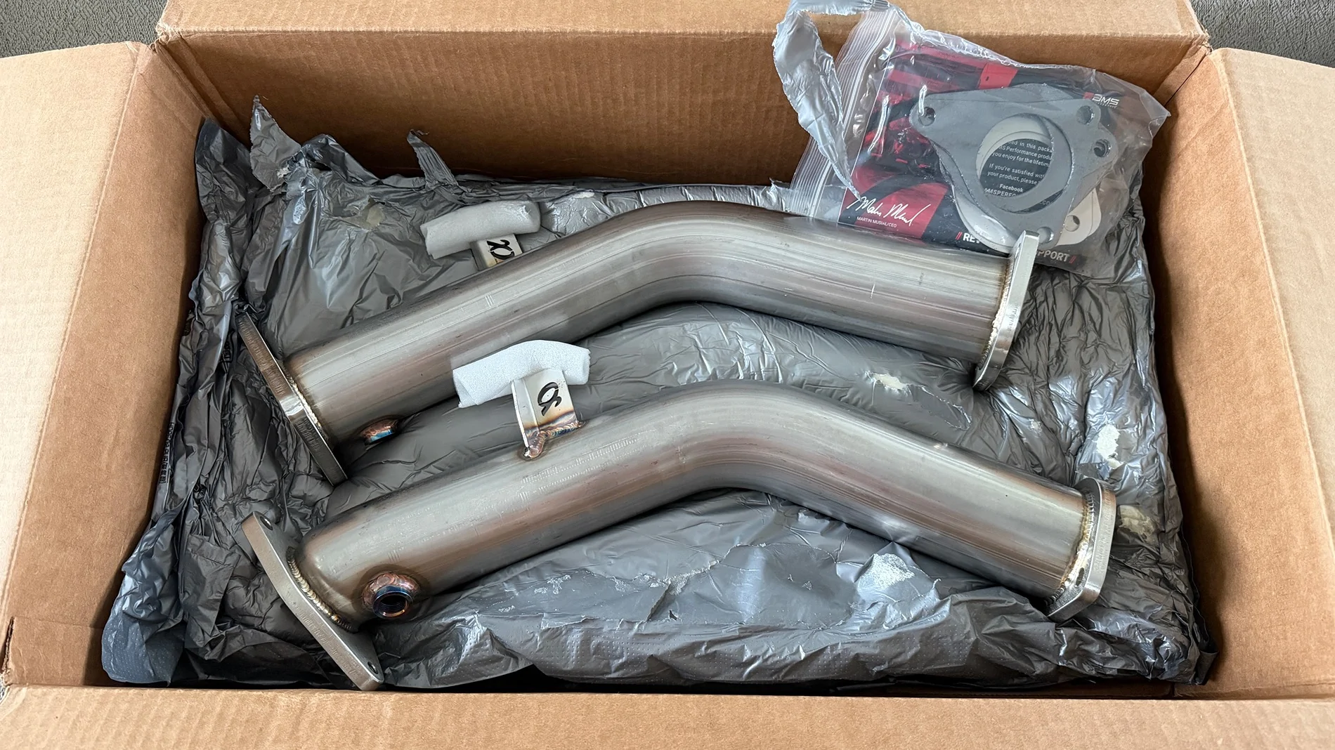

Who's ready for the update news?!?!?
Just like the Spools, the B6A mounting brackets do NOT fit the Z.
So there we have it folks... Regardless, the B6A LDPs are now installed on my car; the Spools are removed and available if anyone wants them for cheap.

Someone probably already said this, but I wonder if they're using 370Z/Q50/Q60 bracket locations and the Z is different.
Q50/Q60 is RaceBox's theory.

I doubt this is an oversight, as I'd assume someone's told them. My guess is they have stock they're trying to burn hoping it won't become a big deal.

I installed the HKS Lower Downpipe/High Flow Cats originally designed for the Q50/Q60 and it bolted right on.
These are the new version B6A 3.0" resonated LDPs.

I installed the HKS Lower Downpipe/High Flow Cats originally designed for the Q50/Q60 and it bolted right on as well.
Those are the resonated ones, correct?
Is the cat matrix only in the end of the DP where it connects to the Y pipe, or is there another one in there?
