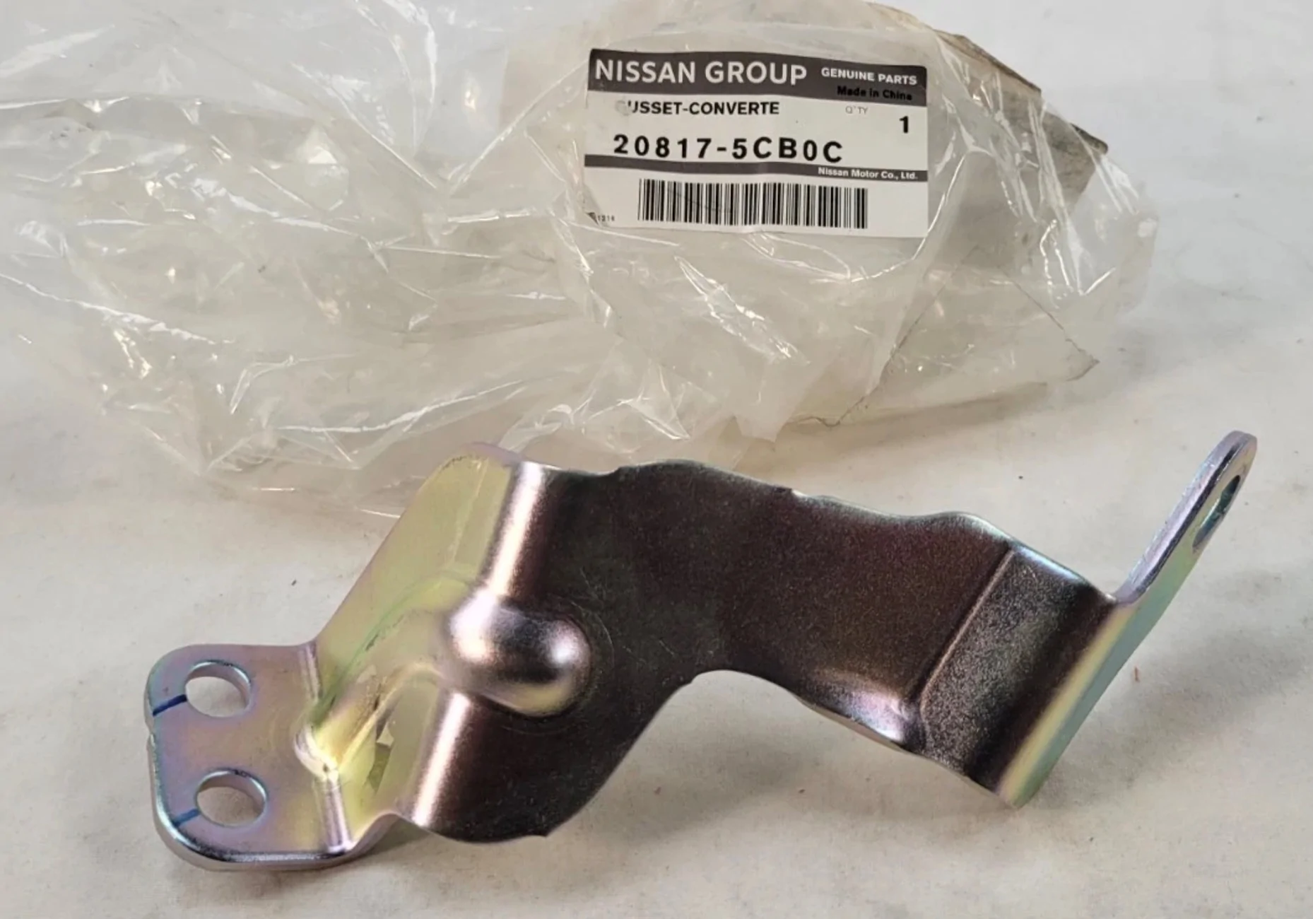

I’m referring to the oem bracket that mounts to the frame. -it’s made of sheet metal (die stamping) and will easily bend when removing the stock lowers.
I can guarantee you this is what happened. Especially after multiple uninstalls and reinstalls. Those oem brackets are pretty malleable. Even in the event of "them not fitting" by 5mm you can literally bend it by hand. The point is its fitting and bolted tight with a much better downpipe design.
Also q50/Z cats have the same mounting points, dont let them tell you otherwise.
