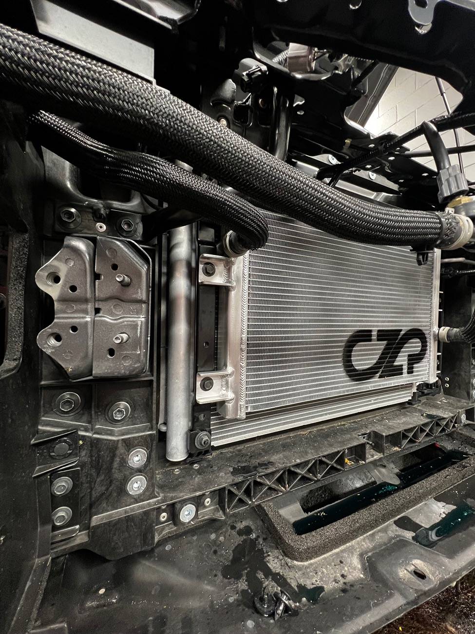

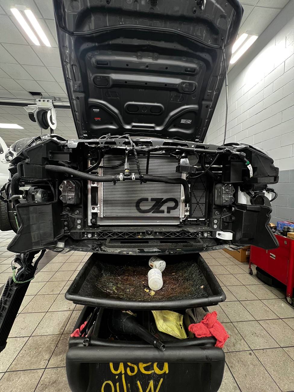

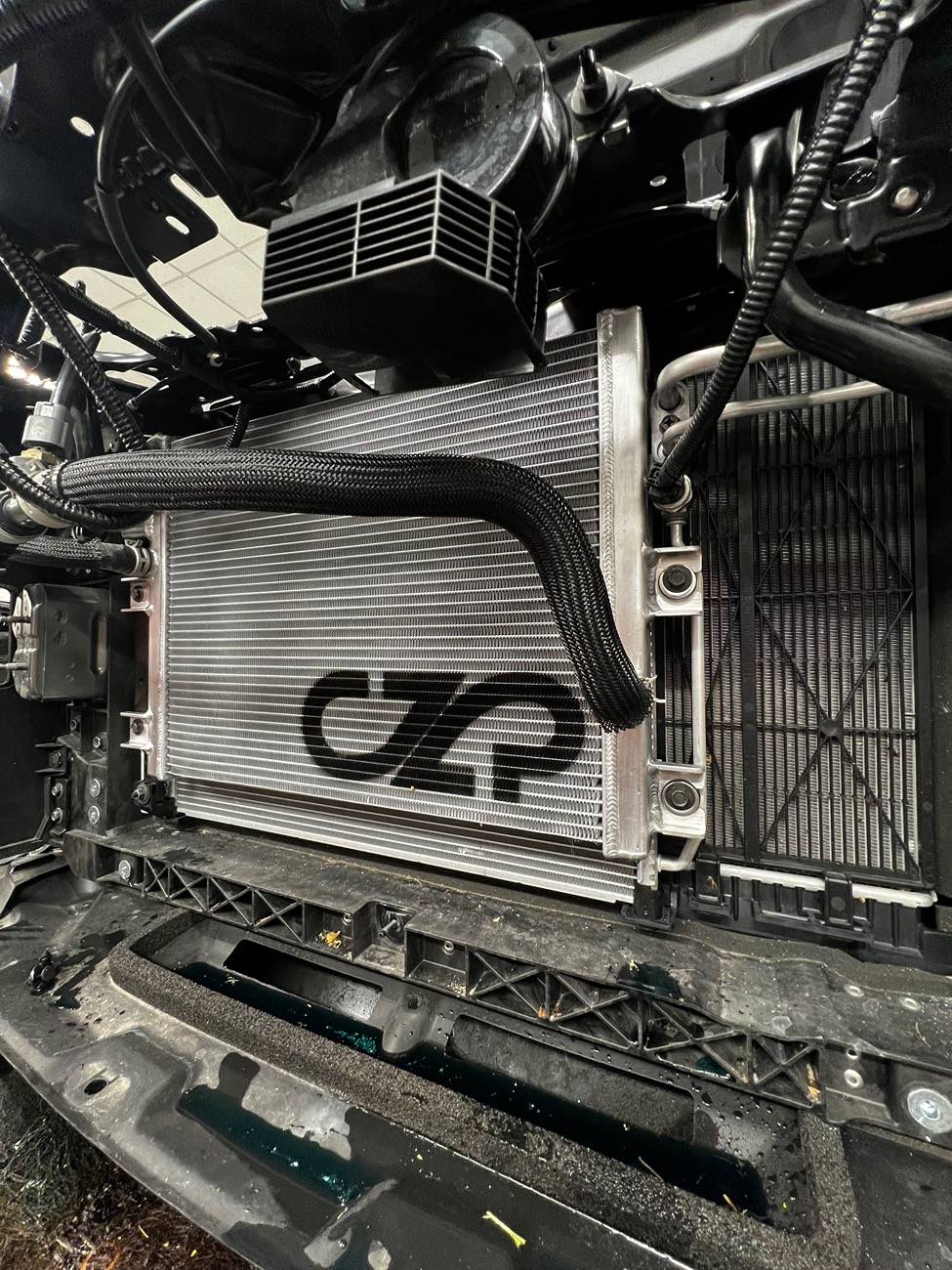

Thanks for clarifying, I have one arriving today, so I will get some pics for folks of the CZP once it get's installed.
How did the install of the CZP heat exchanger go? Liking it so far?

So far so good, it’s been raining allot, so haven’t taken the car out much.
It looks great sitting in there! Thank you for posting and sharing your thoughts. Did the shop have any comments about the quality or installation process? It looks like a great OEM-type fit, looks really clean

z34
My friend owns a Nissan Dealer, and had one of his lead tech do the work. They said the install was easy and clean and bolted up nicely. I also installed the concept Z on piece under shroud, and it's a very nice well-built piece, far superior to the Z1 piece in my opinion.
