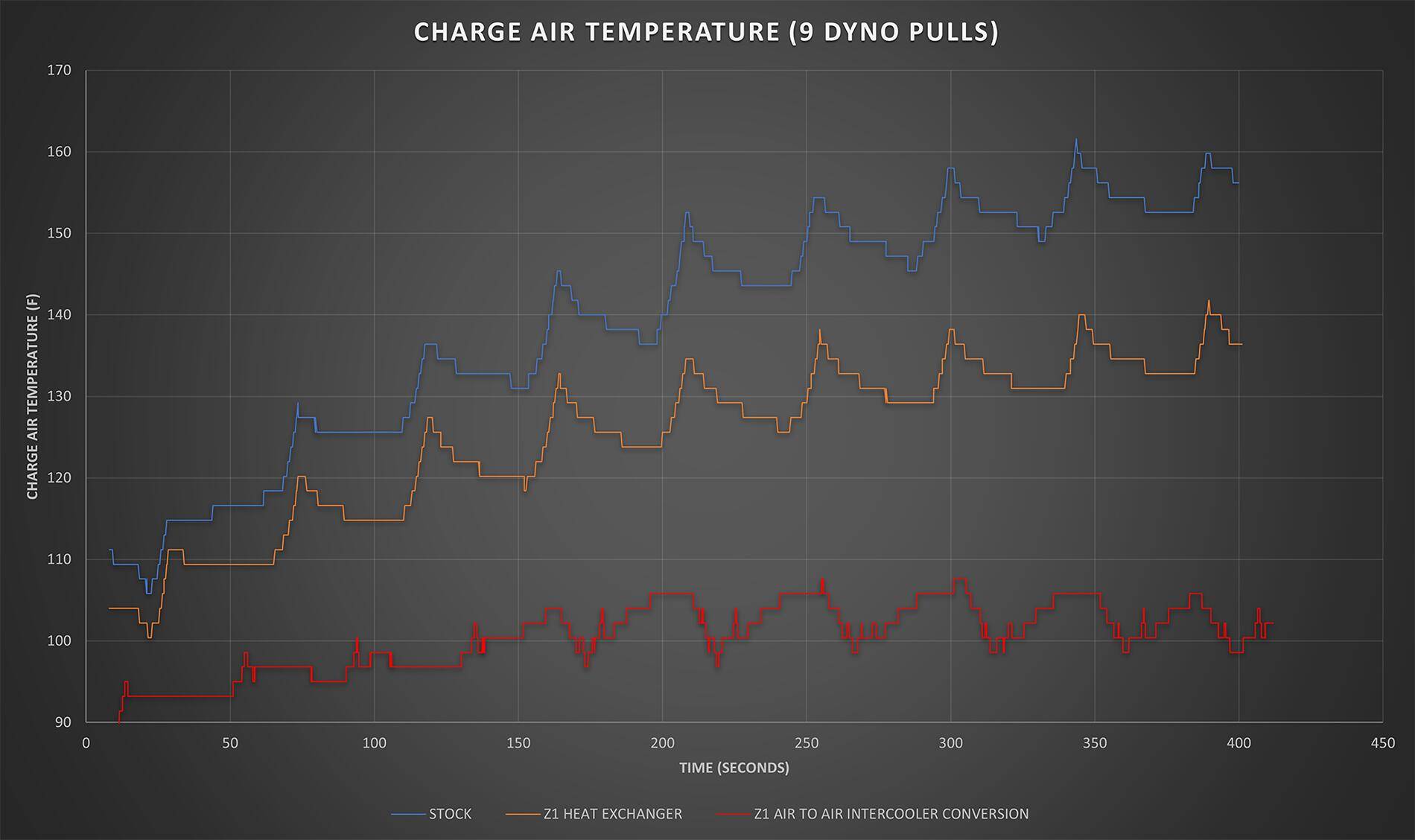

Z1 has a chart up that shows consistently low intake air temps with an air to air system but they don't clarify whether the car has just an upgraded heat exchanger or intercoolers as well.
Hi NocturnalEmber, I believe with the Air to Air kit the water intercoolers are removed entirely. I would believe the heat exchanger would also be removed.
Someone else posted that a downside to the Air to Air, other than needing modifications to the core support and other pieces, is that it only works well while the car is moving. The other poster mentioned in traffic or congestion the A2A would not work very well.
Another thing to consider, the graph Z1 has put up has 9 full blast dyno pulls all within 6 minutes - with only approx 30 seconds of cool down before starting each pull.
I haven't been to too many tracks yet but I can't imagine that for most tracks you will be able to hit the back straight going full send 9 times within a total span of 6 minutes - and even less likely to do that on a street.
While the A2A Z1 kit may be promising I wanted to call out the above.
They say the A2A kit provided consistent charge temps while testing at Road Atlanta, but proceed to list a graph of dyno pulls instead.
I would want to see how the OEM designed water kit performed on track as well as the Z1 A2A kit overlaid.

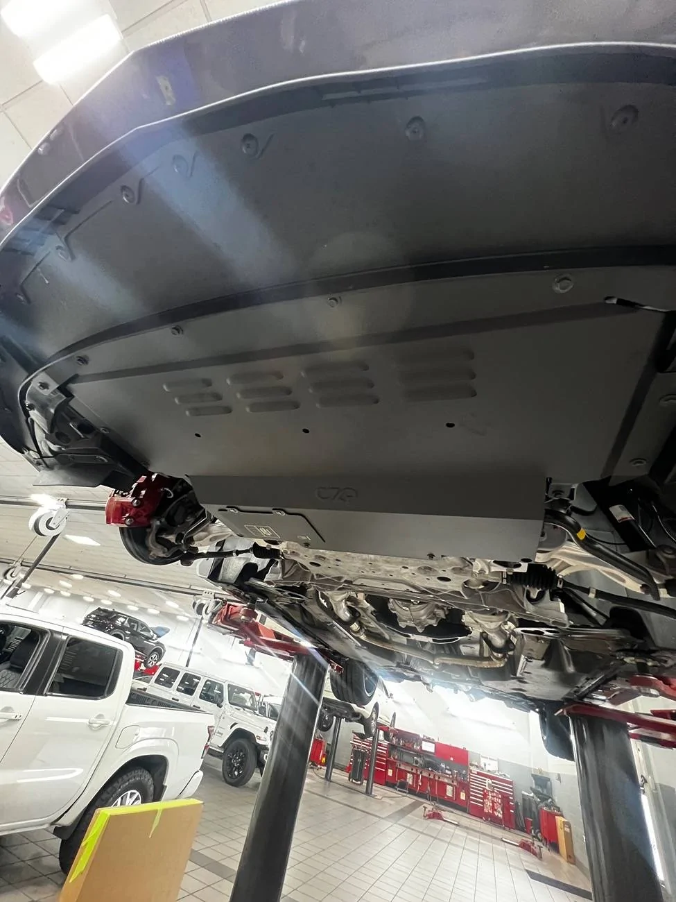

My friend owns a Nissan Dealer, and had one of his lead tech do the work. They said the install was easy and clean and bolted up nicely. I also installed the concept Z on piece under shroud, and it's a very nice well-built piece, far superior to the Z1 piece in my opinion.

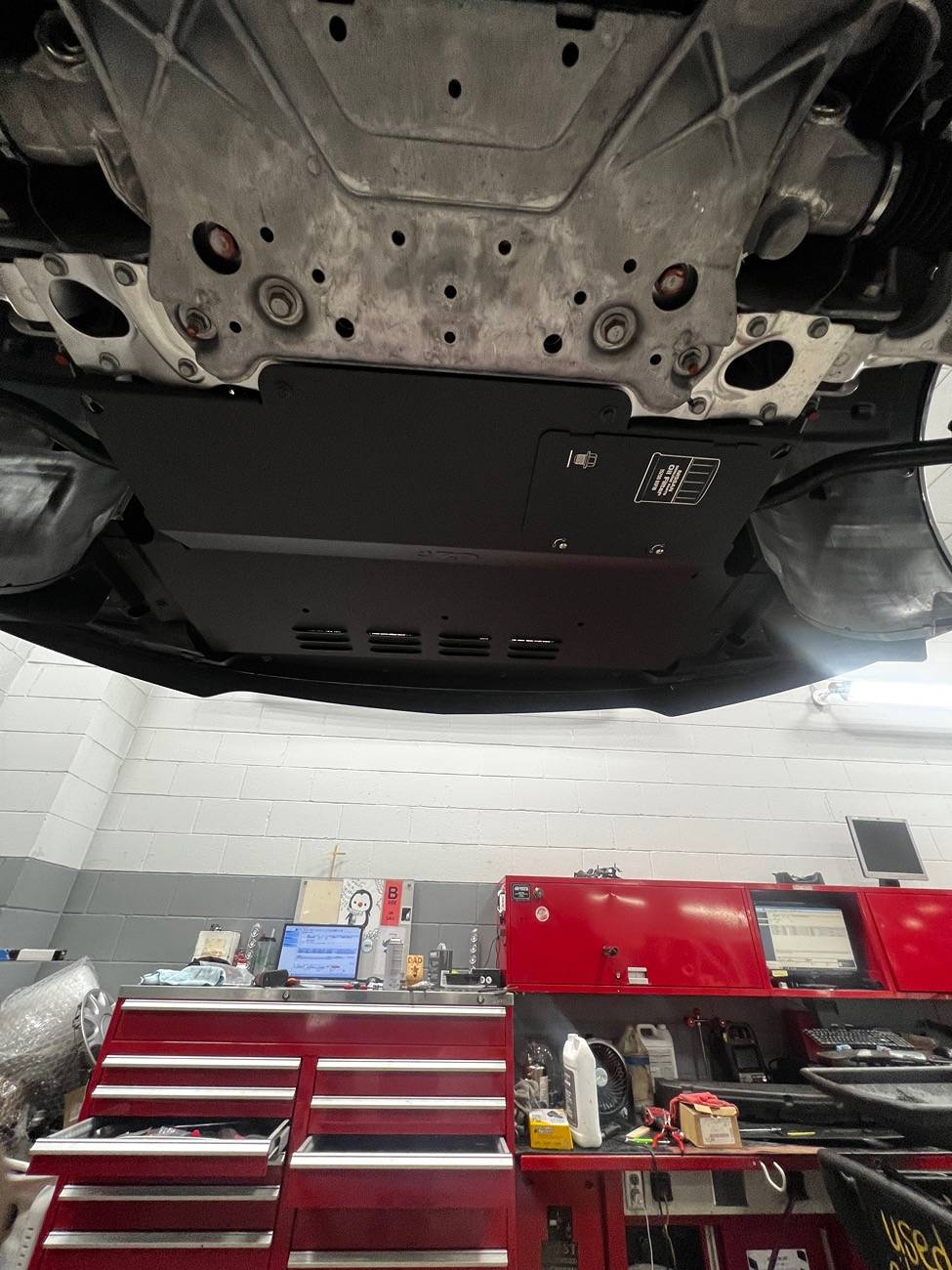

Nice! Do you also have pictures of the under shroud from CZP? It technically is part of the OPs cooling overhaul thread as I am curious about the oil coolers heat escape. The CZP heat escape looks like its built differently than the Z1's heat escape and I am also curious which one is more close to stock
Here you go! The one piece design is really nice, it’s a very solid piece of aluminum and the easy oil change access is great!
Does this one require riveting the front bumper? I was looking at the Z1 piece until I read that part of the installation instructions. Kinda surprises me that a company as big as Z1 wouldn't just design their products better to where irreversible modifications aren't needed.
This is 100% plug and play, heavy gauge aluminum and one piece. It uses only the factory bolts, no modifications required. I was sold, and it's cheaper then the Z1 piece and just remove one door to change the oil.
