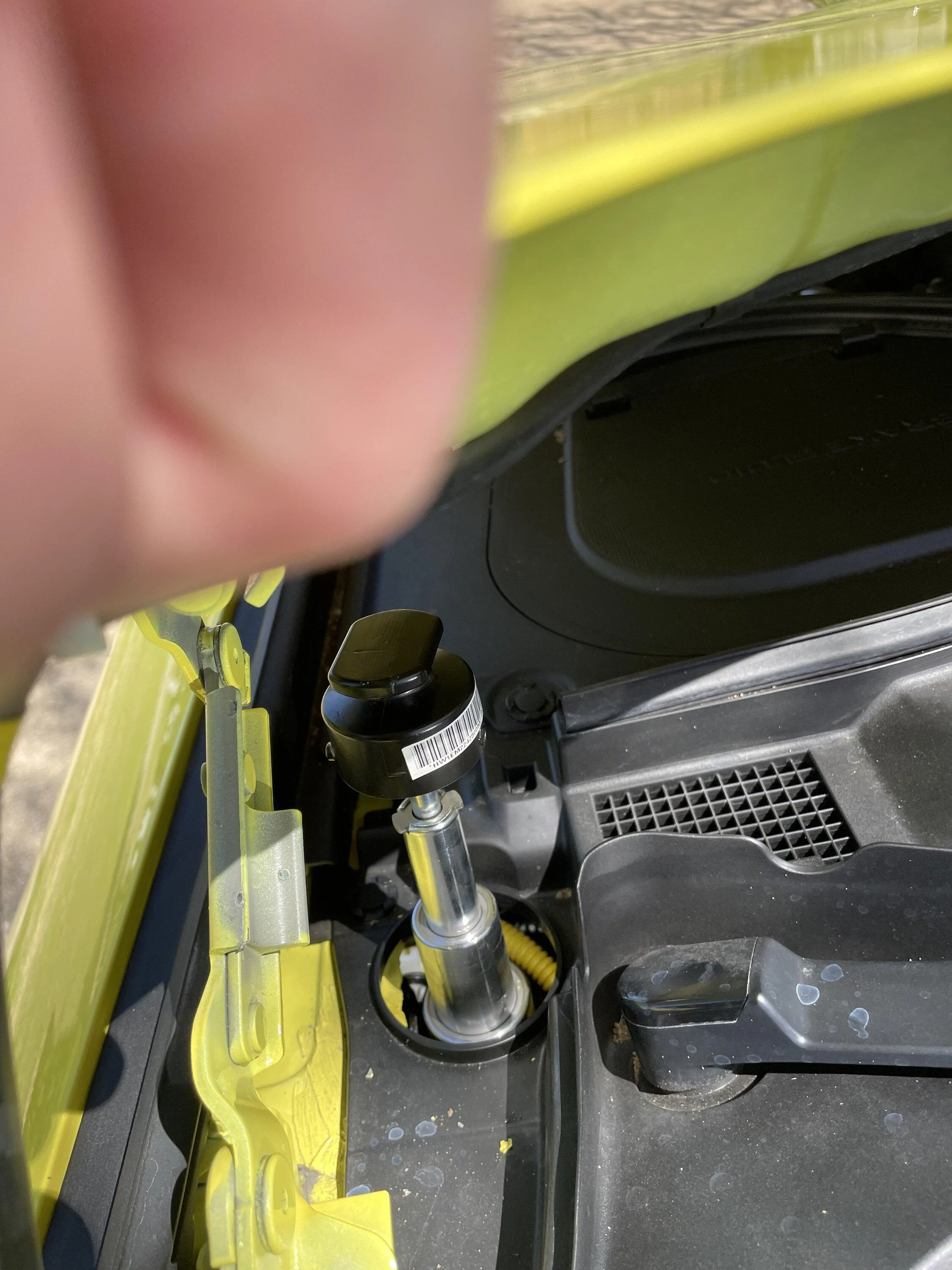

Anyone seen these hood risers & know how to get them down. Spun the Z on wet roads and caught back wheel on curb. These popped the hood open - can’t open or close hood

No collision- no body damage at all - spun it - went back wards into grass - might have popped edge of curb - car seems to drive fine but with hood popped i obviously can’t get up to any speed - it’s going to Nissan tomorrow

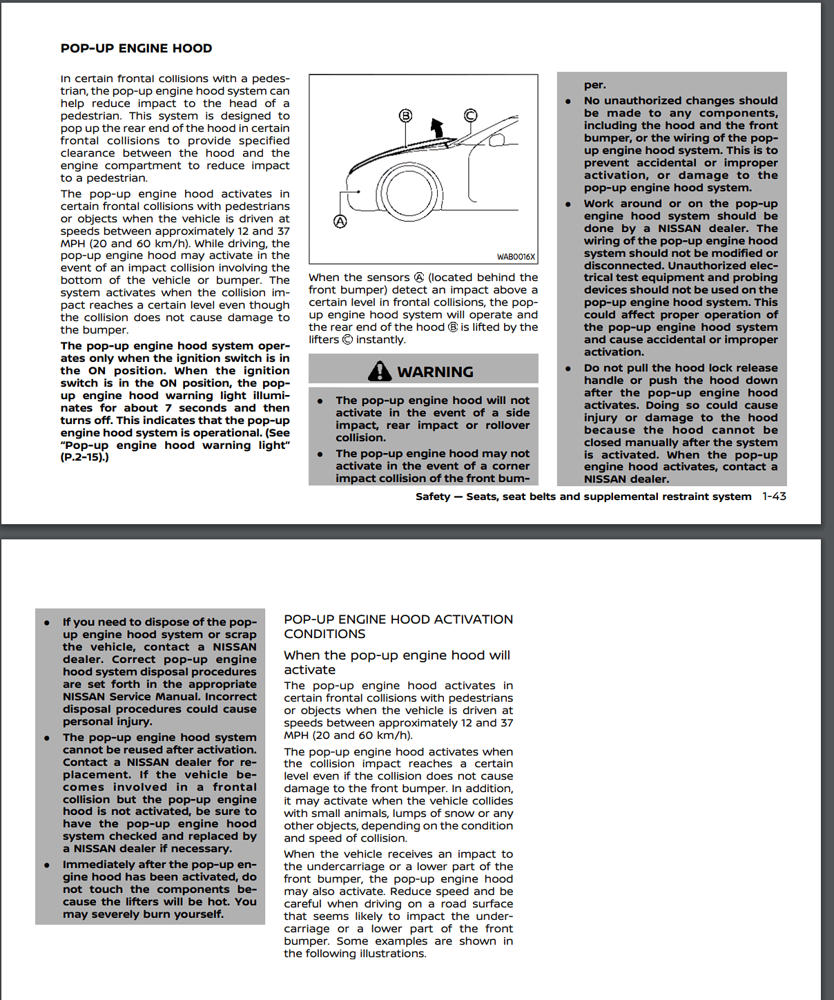

Maybe this video from Malaysia would help. Poor resolution.
Nissan SKYLINE GTR35 Engine Hood Pop Up Troubleshoot When a pedestrian collision is detected by the car, the engine hood will instantly pop up... | By ECU Repair Malaysia EcuTech | Facebook
In short, you can remove them to close the hood as a temp fix.
To fix, maybe a dealer visit and/or insurance claim if applicable.
Yep that’s it - and it looks like they must be replaced not reset - I’ll take this info to dealer - chances are no parts availability - could be months to get them in.

Did any of the prior Zs - Z34, Z33... - have these? I doubt it. Any other current Nissan/Infiniti? This is not good for any intending to be tracked. Sometimes things happen, like spins onto dirt, hitting curbing, even bumping others unintentionally of course, what about towing situations? I wonder if they can be removed without any SES lighting up? That I'd prefer to do, disable it completely. Then not sure about any warranty issues. Dumb safety feature.
Your wallet is going to hurt.
Looks like the actuators are $1204.78 each.
Hopefully that's all it is. Only thing that's concerning are the yellow cables. Yellow is part of the restraint system. A lot of times, if an airbag blows, other parts need to be changed.
I would not be surprised if the book says hood, hinges and/or diagnostic unit has to be changed.
