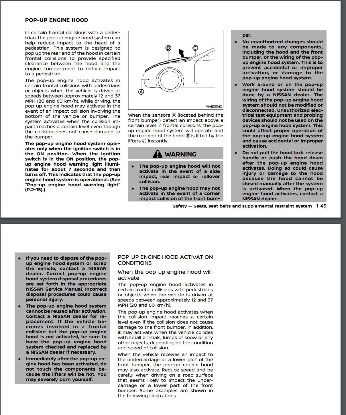

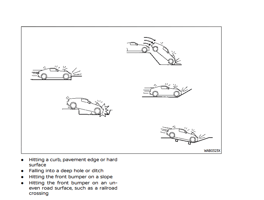

hmm this is concerning but seems like a freak occurrence? as you would think if this were a widespread issue where they were too sensitive you would have had reports from the reviewers who ran these on track reporting this. seems like they only activate between 12 and 37mph. I worry that would hitting a cone during autocross cause this?
the description in the owners manual says it can happen even when hitting snow or small animals when the bumper isnt even damaged. it even says going over a railroad crossing could cause it? so they think you should play $2400 for replacements if you go over train tracks too fast?
I agree this could be an insurance claim or even a nissan warranty claim if the front wasnt impacted.
The pop-up engine hood will not activate in the event of a side impact, rear impact or rollover collision.

it uses an explosive charge to launch it quickly like an airbag thus it's a one time only deal
