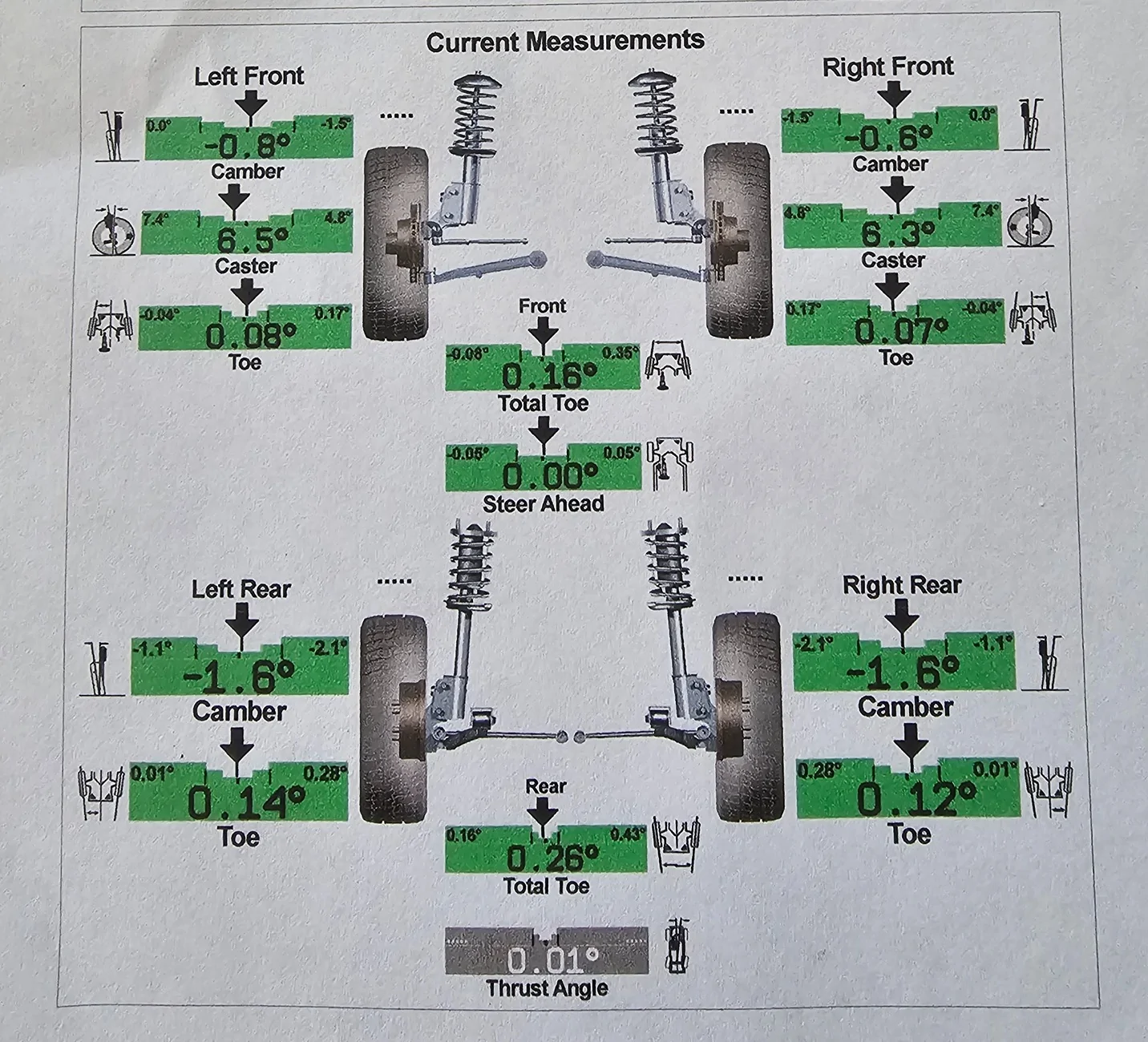

Finally got the Nismo coil overs installed and the alignment below:
The ride quality is great. Somehow is firm and less bouncy but still comfortable as can be.

Nice! Glad to hear you are happy with your decision and that your alignment has been nailed down! Congrats!

WOW- all greens on coilovers- NICE! How low was your drop with the Coil overs on the Z?

Sadly while the front drop was about an inch the rear wouldn't adjust down much. It was 3/4 on just lowering springs but we couldn't get the rear down much. Hoping the springs settle.

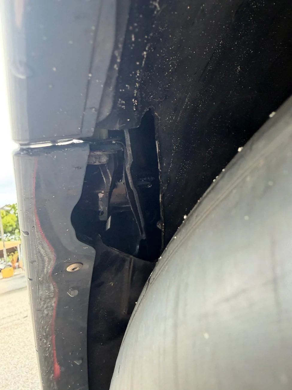

Bumping this thread back, I installed Swift springs on my Z NISMO.
After 2 days, I'm hearing rubbing and figured I need spacers after the suspension settled?
I'm running a 275/30R19 front tire and a 305/35R19 rear tire on the OEM wheels.
At the moment, I have stock alignment arms.

Are you sure you’re not just bottoming out on bumps? Highly unusual to be rubbing under normal driving conditions with factory offsets.​

OEM wheels?
Spacers?
OEM links/arms? Yes
Larger tires? Yes
Alignment after springs?
It would help to know where you're it's rubbing. Outer front touching is a different animal than inner rear.
The front tires are a tad wider, but shorter. They shouldn't rub with OEM wheels/alignment and a 1" drop (or whatever the Swifts are).
The rears are meaty. I'd suspect rear outer based on the meatiness, but I don't know. I think you should have plenty on the inner for more meat.
But it could be something else too, not just tire or wheel touching something.

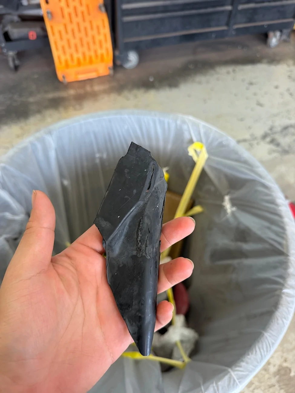

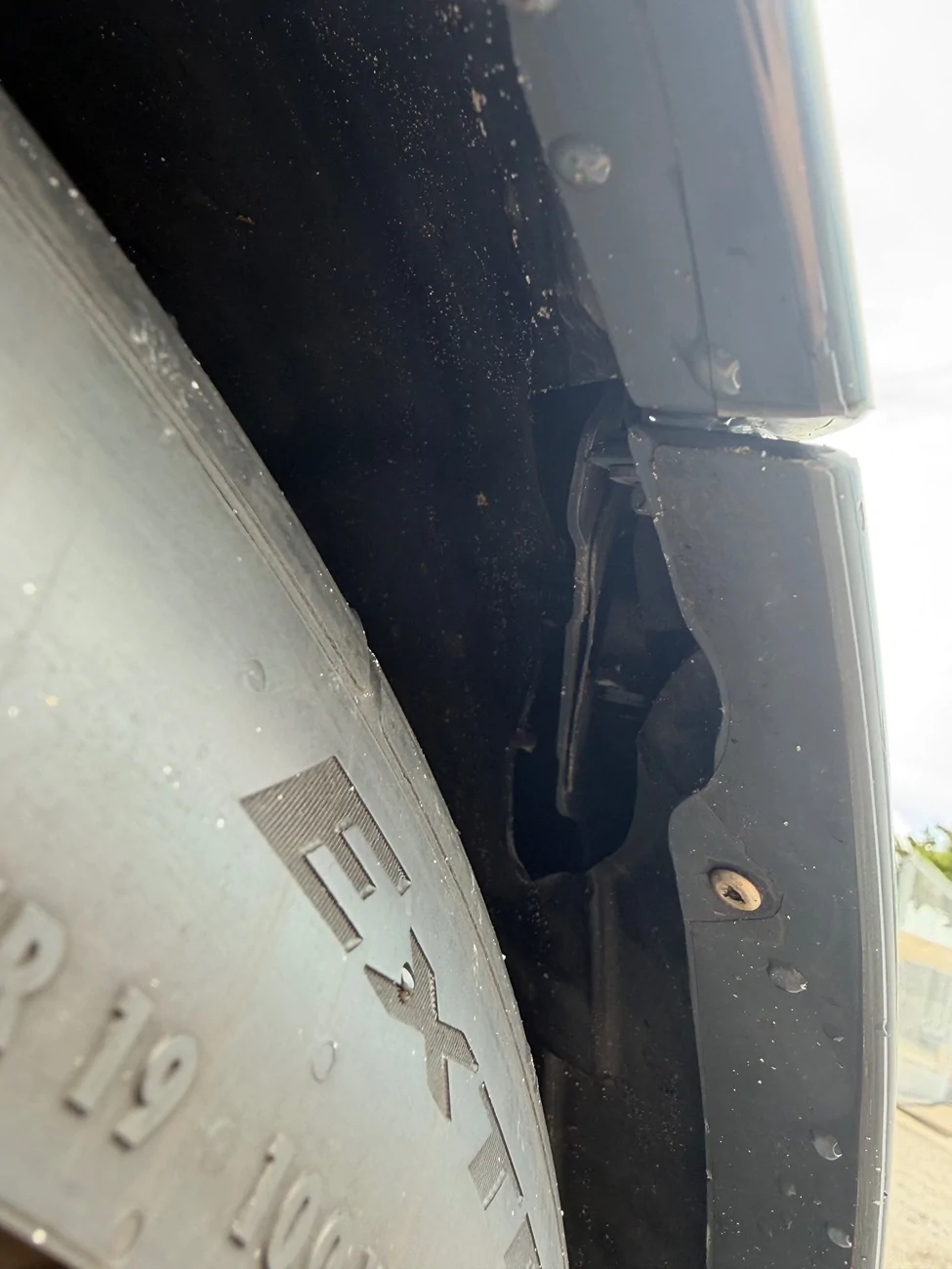

Well I found out it was the fender liner and trimmed a piece of it where it was making contact and I figured I just order adjustable FUCA’s
