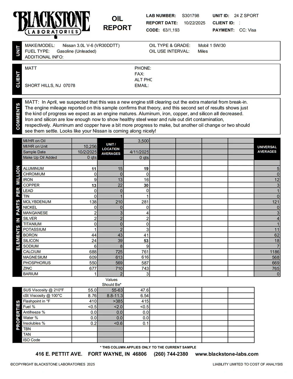

I just changed my diff and transmission fluid and plan to send both off for analysis after doing my oil ~10k miles ago. Very interested to see what they say about the diff fluid seeing as it's gone over 300F on multiple track days since it was last changed

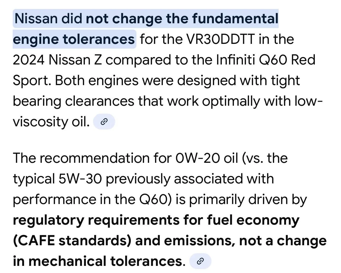

Found this on FB. Yeah, it's FB, and it is an AI-gathered response.
TL; DR: I'll stick with my 5w-30, and a quality filter with a higher relief valve setting (To force more oil through the filter.)

Maybe I'm getting too anal retentive. Bottom line: I'm happy with my Blackstone numbers, will keep doing it, and getting a baseline.
Hope to see other's results here too.
