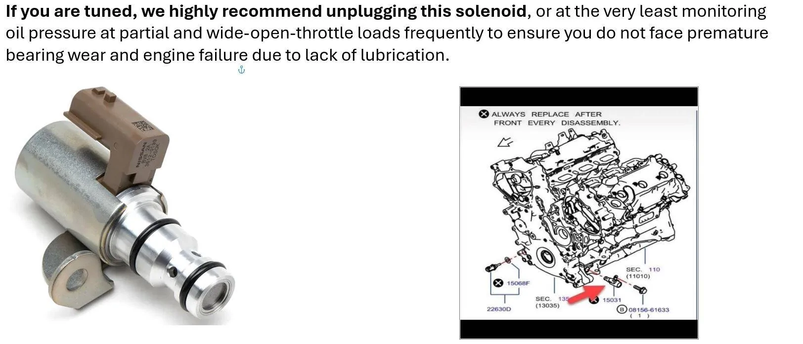

9E01 or Nismo filter and unplug oil solenoid I believe is way to go. I'm attaching a "file" GoRacebox posted also SonicTuned has great information on there web site. I will have car tuned as soon as exhaust and LDP's get in to go along with 3" titanium intakes. Ordered a bunch of the 9E01
I read the article. Have you unplugged the solenoid? Is it just unplugging the solenoid all that needs to be done?
