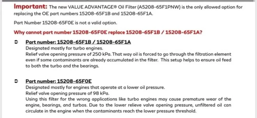

I'm using the 15208-65F1B, because that's the one that is listed as the OEM proper replacement according to the Nissan parts sites.
I think the 65F0E is the same filter with a different bypass valve pressure. I'm not about to gamble using an improper filter on my new car. I feel like if there was a better option that protects the engine better, Nissan would have used it. Especially since all of these filters are basically the same price. If other filters worked properly, I imagine that the compatible part numbers would be listed as options.
I'm not sure if I'm right or wrong, but if I use the recommended filter, it won't matter If I'm wrong.

Use 65F1B
Too late already used F0E on the Z. The longer filter went to the Murano as it already had a longer filter from a previous oil change at a shop. I guess Z1 put my phone call to them into consideration when packing my order.

Use 65F1B
This is exactly why I wanted to use OEM, but didn't have/know the explanation. Now that I have the reason, I know I made the right choice to stick with an approved filter!
I'm not smarter than the Nissan engineers, so I will continue to follow their recommendation.
Thank you for posting this. You may have helped people save their engines!
