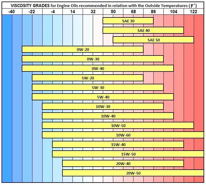

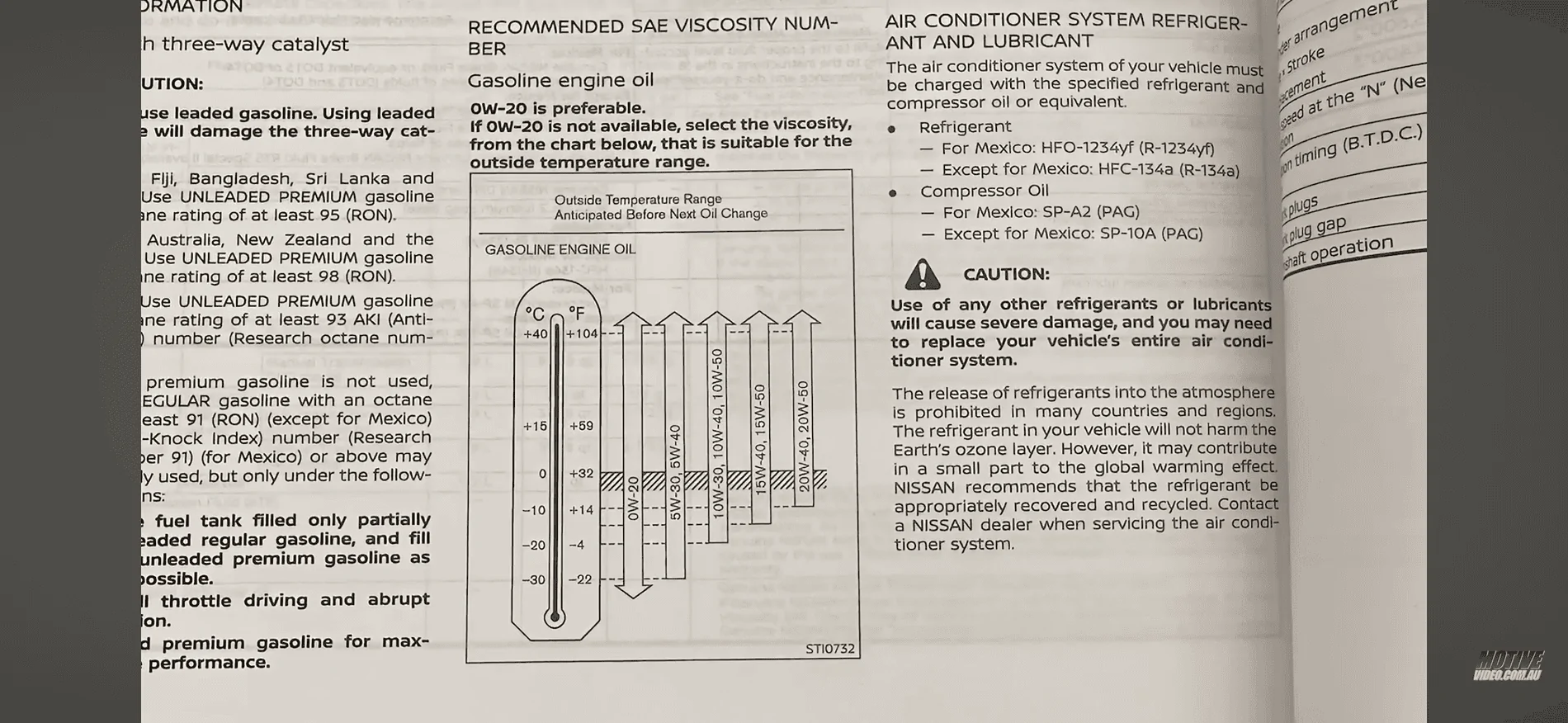

Are there any Australians that can confirm this is what their manual says? From Motive Video's Youtube channel should be from their Proto Spec owner's manual.
VR30Infection
Jul 21, 2024
538
523
Based on the above chart, my tuners recommendations, and my hidden spring of talent which enables me to out drive my engine, I will be switching away from 0w20. :rockon:
(I had to add to the show)
all kidding aside, the manufacturer is not suggesting an oil viscosity for a car that has downpipes and is pushing the turbos to the limits with a tune. If you’re tuning your car, ask your tuner what they suggest. If you don’t think you can trust your tuners advice, then my advice is to get a more seasoned tuner with a few seasons under their belt. As far as warranty is concerned, if you have a tune, and you break your motor, the oil is the least of your concern. Just my .02

They designed and built the engine, and are on the hook for warranty coverage for 5 years. I'd just trust em'...
Maintenance section of the owner's manual...:
"-Genuine “NISSAN Motor Oil 0W-20 SP” (or equivalent) is recommended.
-If the above motor oil (or engine oil) is not available, a synthetic 0W-20 SP GF-6A motor oil (or engine oil) may be used.
-Damage caused by the use of motor oil (or engine oil) other than as recommended is not covered under NISSAN’s New Vehicle Limited Warranty."
Wanted to add to this, by law at the federal level (I think), auto companies cannot void warranties for using 3rd party parts or non spec oil in this case. If damage is caused by using non-spec oil the company has to PROVE the damage was caused by the non-spec oil or part.
Also looking at that chart though I'm wondering if I should start using 5w-40 instead of 0w-20 since where I live it never goes below -10F and I also track the car.
I'd post that question on the internet and see if anyone would respond with an opinion...
