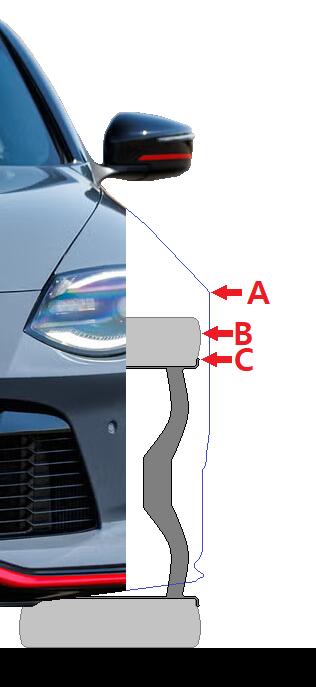

Wheel and Tire to Fender Dimensions for 2024 Z Nismo
Bone stock on level asphalt
Dropped a plumb line from the top outer crest of the fenders (A) and measured from that point to the widest portion of the tire (B) and to the outer lip edge of the wheels (C).
Front:
12mm (0.47") from A to B
13mm (0.51") from A to C
19x10+33, 255/40
Rear:
8mm (0.31") from A to B
9mm (0.35") from A to C
19x10.5+23, 285/35
