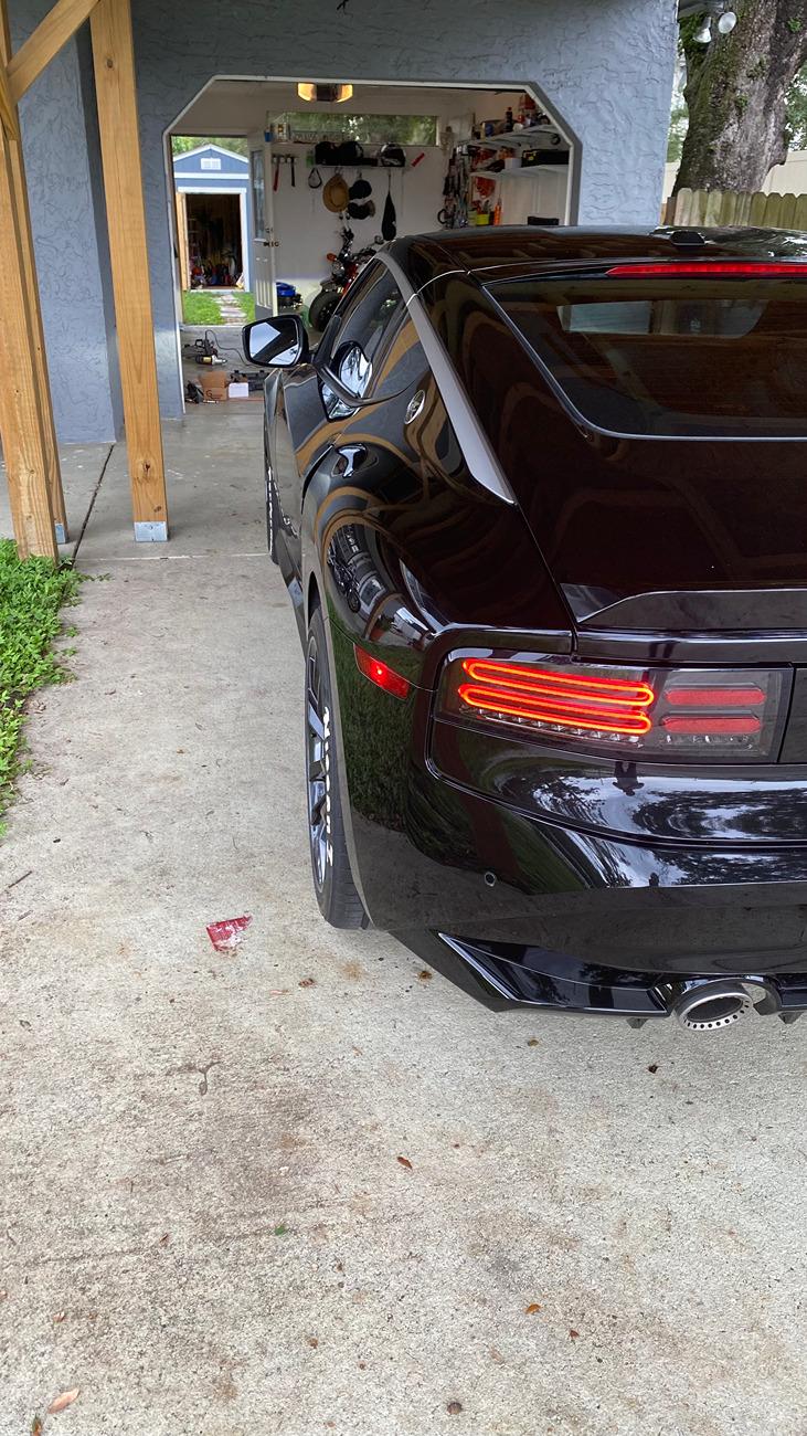

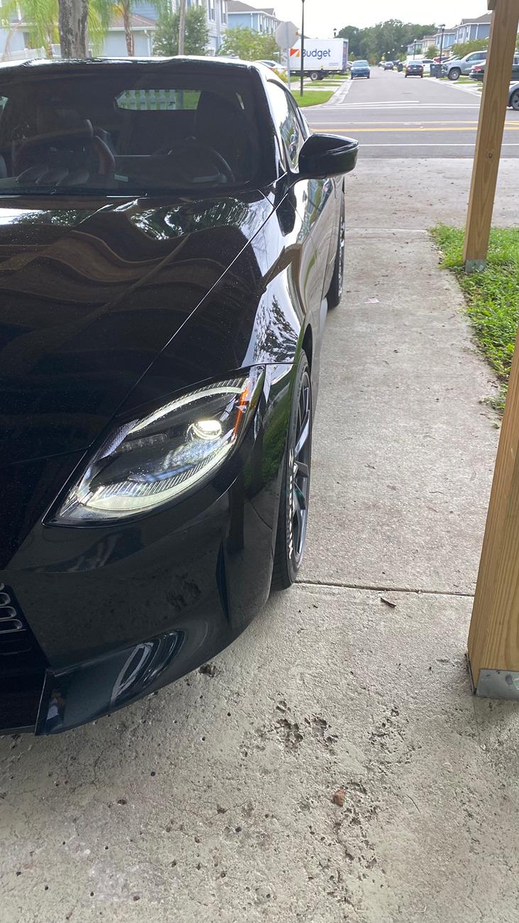

It works perfect. I took it for a test drive and I'm satisfied. I hardly noticed any difference. And it still looks the way it should. See the pictures. So, 15mm in the front and 20mm in the back.

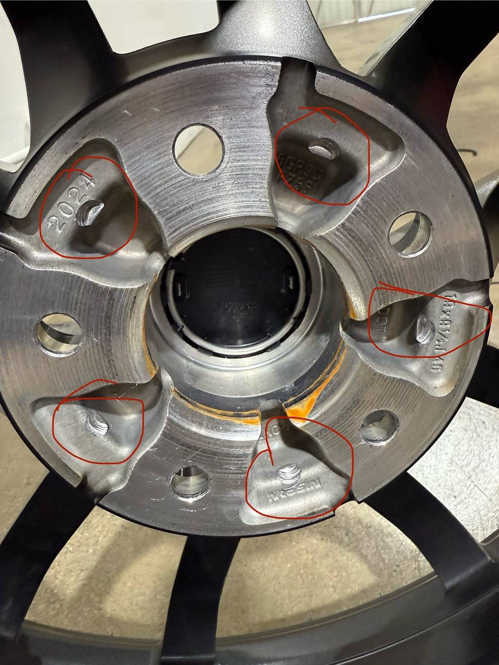

@CPerdomo, I mentioned earlier that I was concerned that when using 15mm spacers on the front, the lug bolts wouldn't be able to clear the very shallow pockets in the rim. You confirmed that it actually worked for you very well, so I pulled the trigger on a set of 15mm Bonoss spacers.

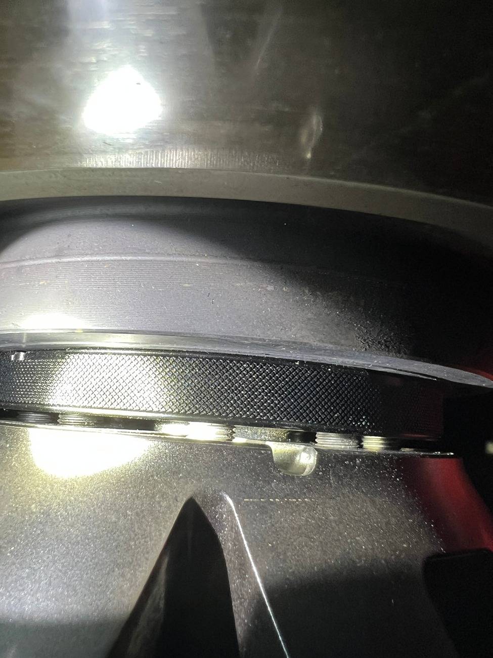

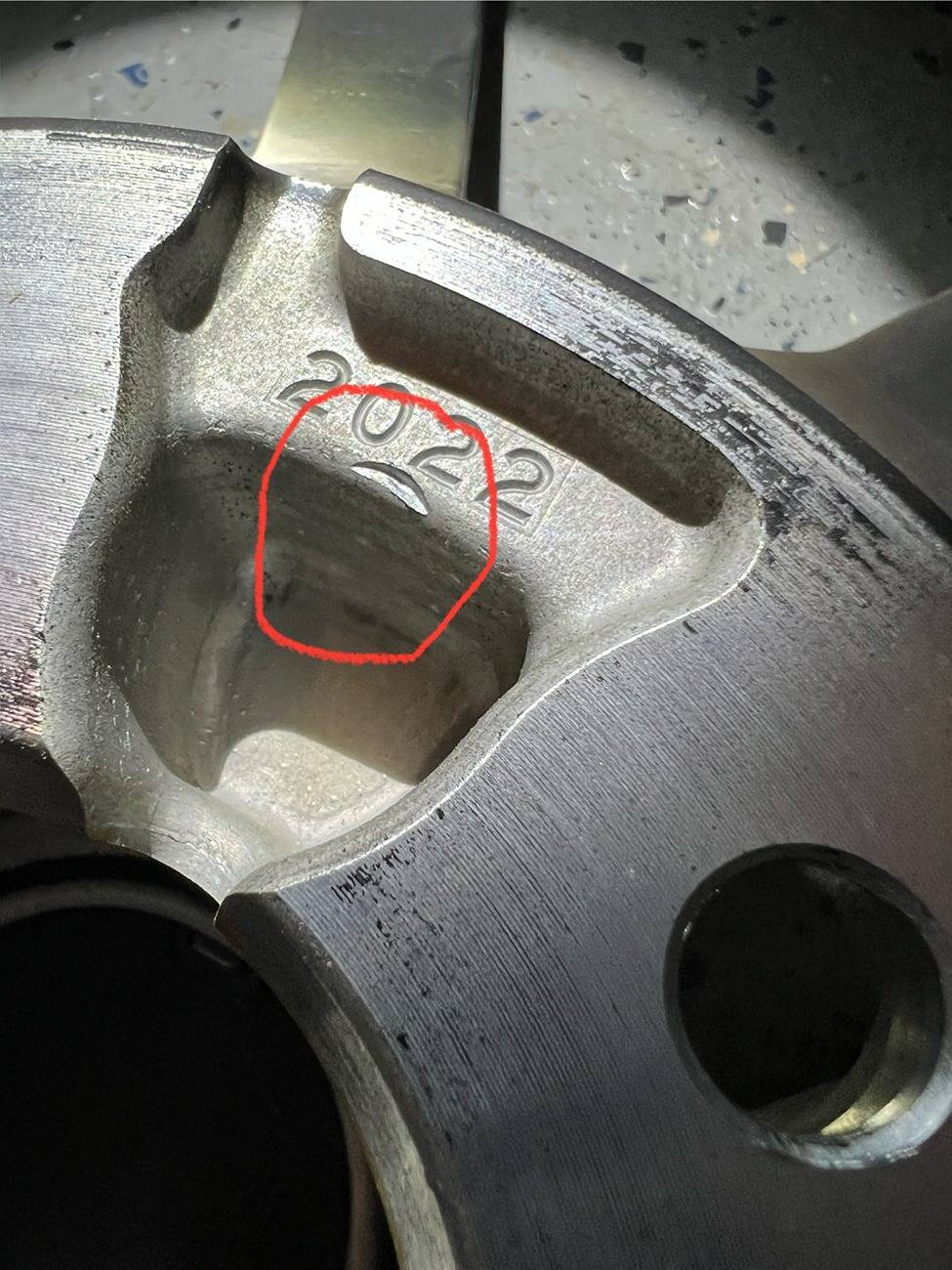

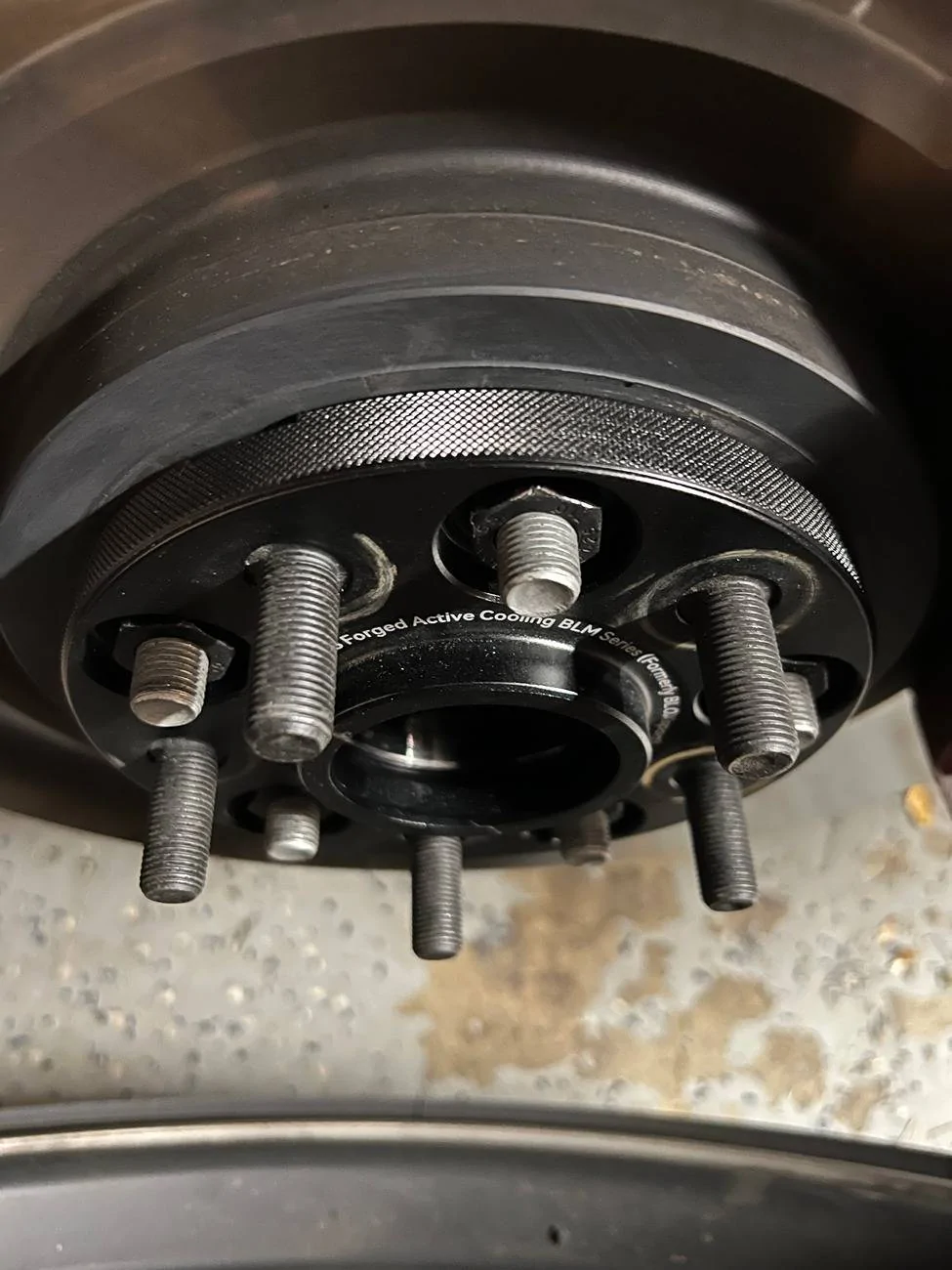

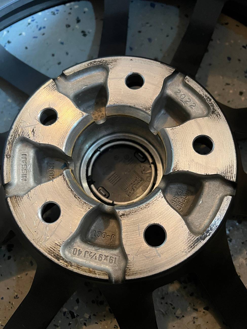

After I installed it, at first I thought it was a pretty good fit too. But then I became suspicious that there might be a tiny gap between the rim and the hub. I managed to stick my phone in there and snapped a picture: There was indeed a pretty big gap in there. After I removed the rim, I could see the dent made by the OEM lugs because they couldn't clear the rim. Since this problem is a result of the OEM lug and OEM rim design, you would have the same issue unless Nissan installed different lugs and rims on the same model year Z Performance. You may want to check out your car.
To make the front work with 15mm spacers, the OEM lugs will have to be ground down by ~4mm.
You are absolutely right. I didn't see anything at the beginning. Then, some time later, I started to feel a small vibration in between 65 to 75mph. Took the car to the dealer to get balanced and aligned and the mechanic found out the same thing you said. I asked him to cut the part that sticks out too much and he did. Now it's good.
Good job spotting it out before anything else. It looks very good, doesn't it ?
