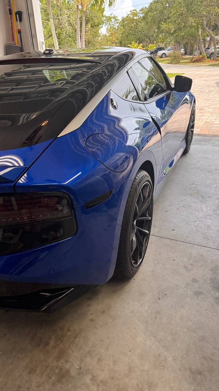

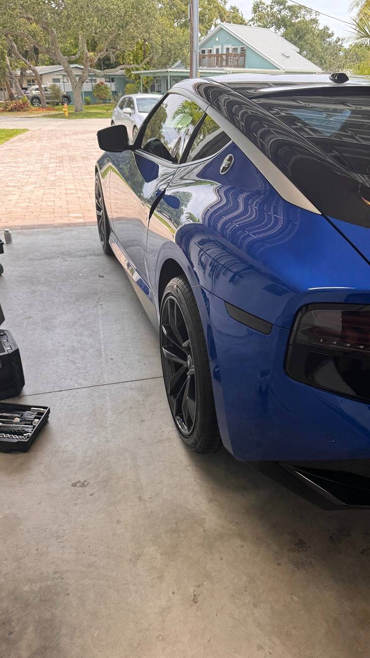

Got these installed this morning! I ended up going with 85 ft. lbs. since Z1 confirmed Nissan's spec was 80 but a few folks had been doing 90+. Very easy install, just time consuming to spec every bolt. I also decided against using Loctite; Z1 point blank said they don't recommend it.

NIIIICCCCEEE... What a difference, ha?

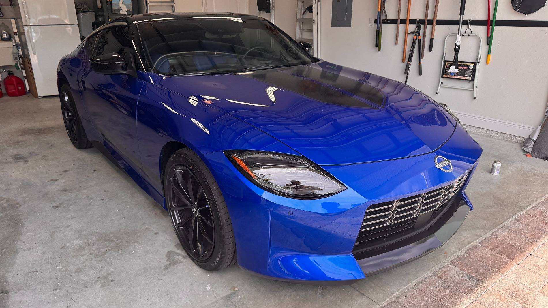

It works perfect. I took it for a test drive and I'm satisfied. I hardly noticed any difference. And it still looks the way it should. See the pictures. So, 15mm in the front and 20mm in the back.
