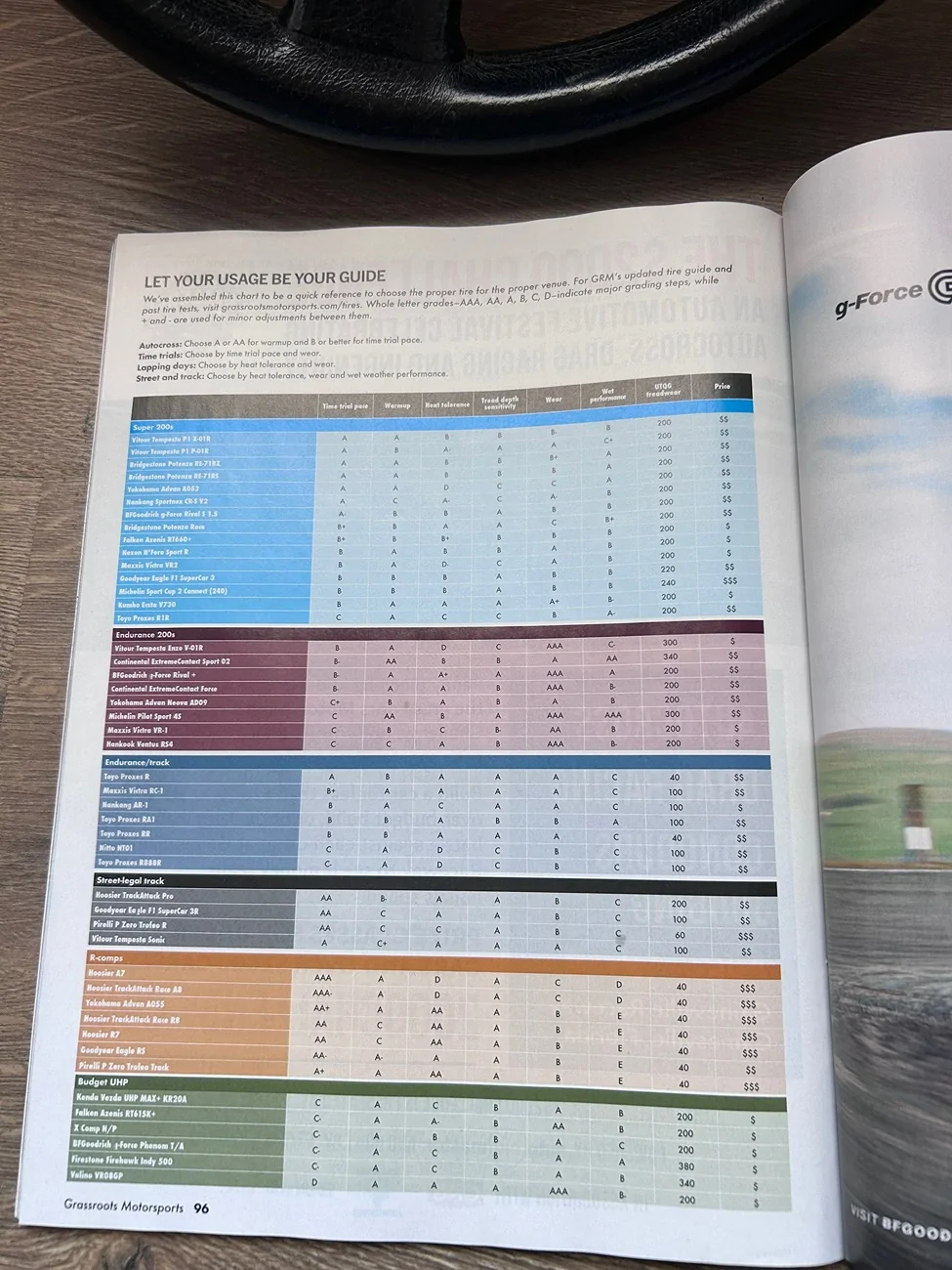

I've been on Grassroots Motorsports for many years, here is their latest guide on tire ratings. The Super 200s are what you're looking for. I've used RE71RS before, going to the RZ soon. But most of those are good performers. GRM tests them.

This page is very useful, thanks! Ill update whenever i make a purchase. I dont think i need to spend 2k for my 2nd season of autoX....well see.

Decreasing lap/run times is great, but those tenths can cost serious money. Awesome info from @trackratZ/Grassroots!
