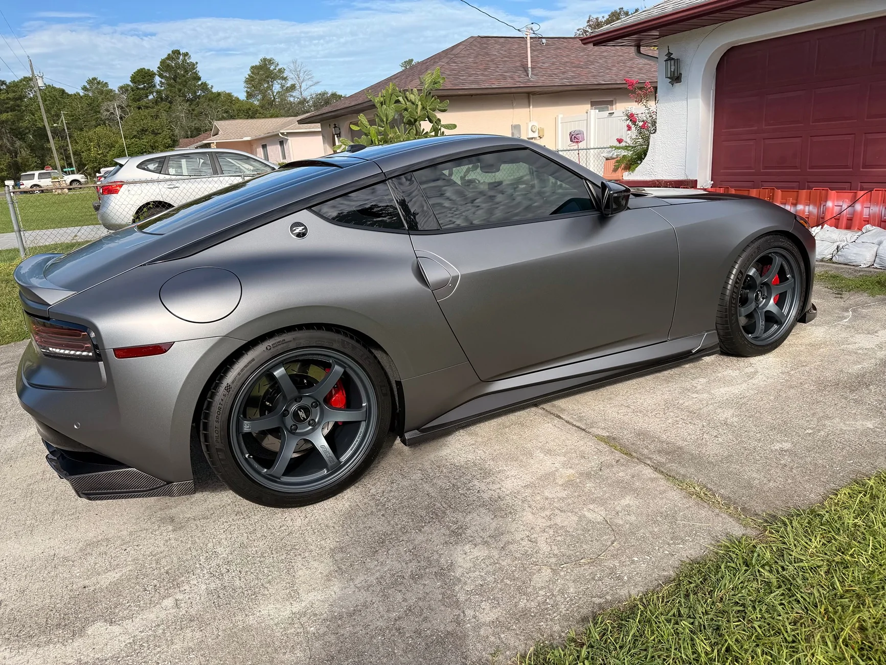

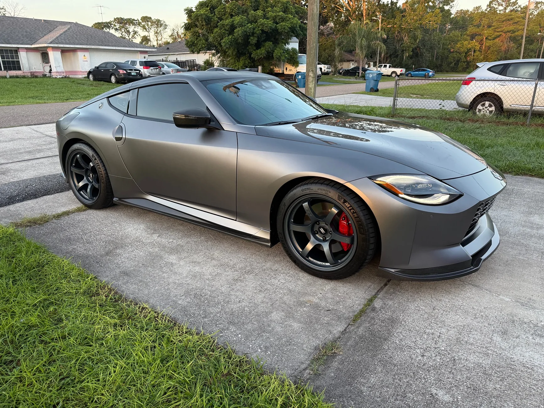

The subject of coilovers drives me nuts. I was and still am really going through the idea of adding coilovers. In the mean time I just installed lowering springs. My goal was really simple lower the car just a moderate amount basically closing the gap , improve handling and keep an enjoyable ride. So for now I ended up holding off on coilovers and added “Ark Performance GTS Lowering Springs”(read about them here) “SPL Front Upper Control Arms” & ”SPLTitanium Rear Camber Links” Actually I can’t deny it actually rides pretty well, corners better than ever and ended up lowering the car just about where I wanted. (Not sure about the exact measurements) need to find that out. Also, no issues with clunking noises or anything strange coming from underneath.
I’ve been talking to one of the big Z parts retailers about adding the Ohlins DFV. Not cheap but I’m really more concerned about ending up w/ a car that looks and rides the way I want it. No track just spirited road. I’m willing to spend the money if I can achieve better than what I have with Lowering Springs. I know that most the guys here on the forum are not fans of Lowering Springs and I’m willing to switch but before doing that I want to be certain I can get at least what I have already.

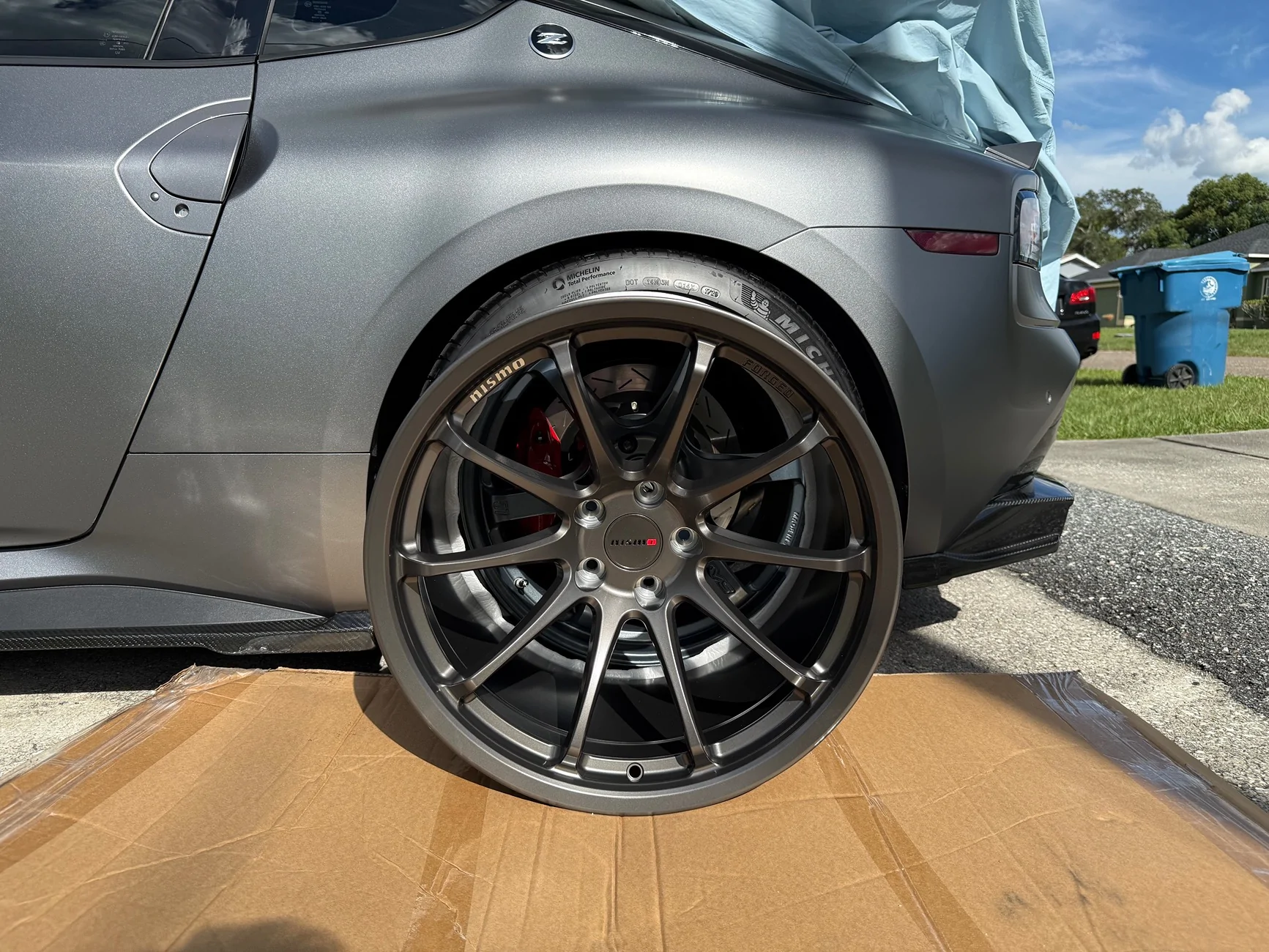

I’m a total noob w/ coilovers and after reading so much on the subject both here and elsewhere I’m not sure if I really understand anymore than when I started. Not many photos since lowering it but found a couple. I'm switching over to the Nismo LM-RS1 Antracite (above) so when I get those installed I'll be back tackling the issue of coilovers...again.:crazy:

So I have added the two piece rotors (Z1) on those but really not effecting anything else. As far as the DR 57 wheels they are F+25 and R+12. As far as clearance they fit fine. Sure the caliper is close but absolutely no problem at all. Now that I'm adding the Nismos I have kind of taken it a step further and went +12 all the way around. Spoke to an owner w/ the same +12 all the way around and they fit like a glove. Wish I could tell you the size of the Michelin PS4 . I'll need to look it up to see what I ended up with..

Let's see some photos when you get 'em mounted. Like to see how it turns out for you. Also, that Big Brake upgrade. Before and after photos FTW. How they pop with whatever color Z you're rockin'. I can tell you that on a White Z....they are straight-up 🔥. Some say I'm nuts for changing out of these because they look so super nice on Gun Metallic. True..but lookin' forward to see how my new Anthracite Nismos will look too. Showing off those two-piece sprinkles. 🤞
Anyway post 'em up brother!
