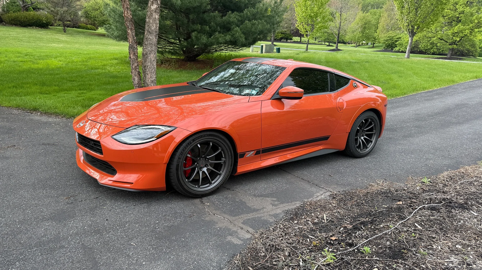

Nismo coil overs. I dropped the car as you can see, I have it set fairly soft it rides well it’s factory and reliable. It’s factory fits of no noise clunks bumps or anything else.
Looks great. Think I saw you mentioned having AWE exhaust as well, heard some clearance problems could pop up. How have they been holding up?
