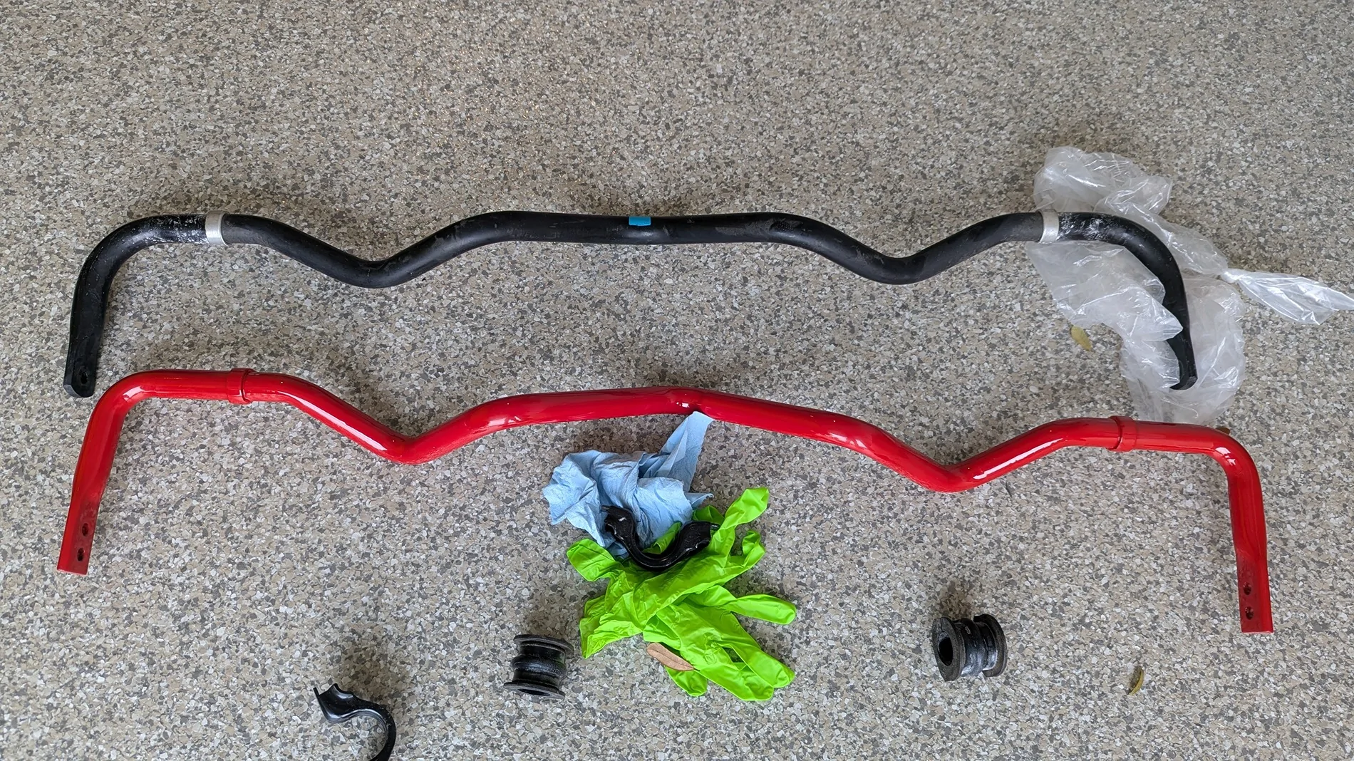

Stillen rear swaybar installed today to match the front I installed a few weeks ago.
The rear bar made a more noticeable difference than the front did; feels amazing and much more nimble. I have both front & rear on the softest settings. I'll be leaving the rear there, but going to bump the front up to the middle setting.

Commodities
Just to keep record, I now have the front bar at the middle stiffness setting and the rear bar at the softest, which is what Stillen suggests as a starting point for stock tires/suspension.
