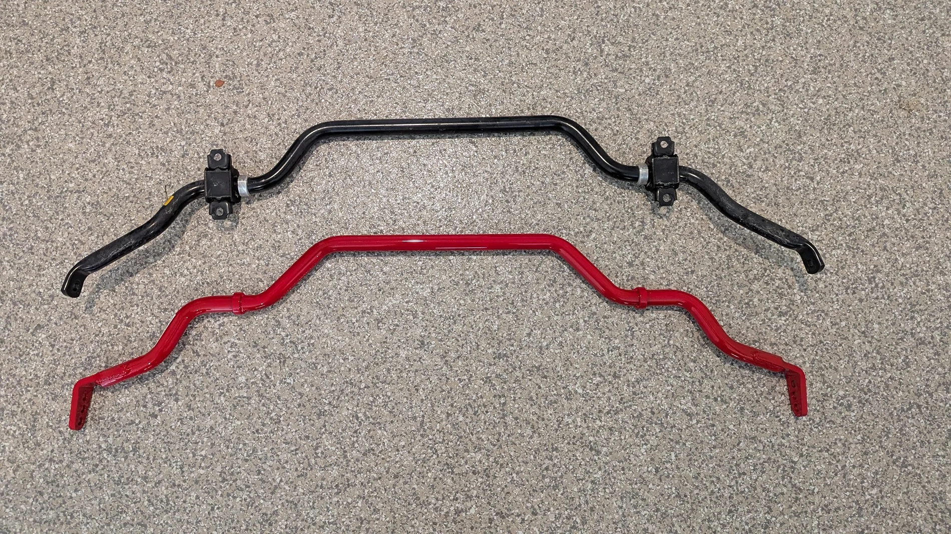

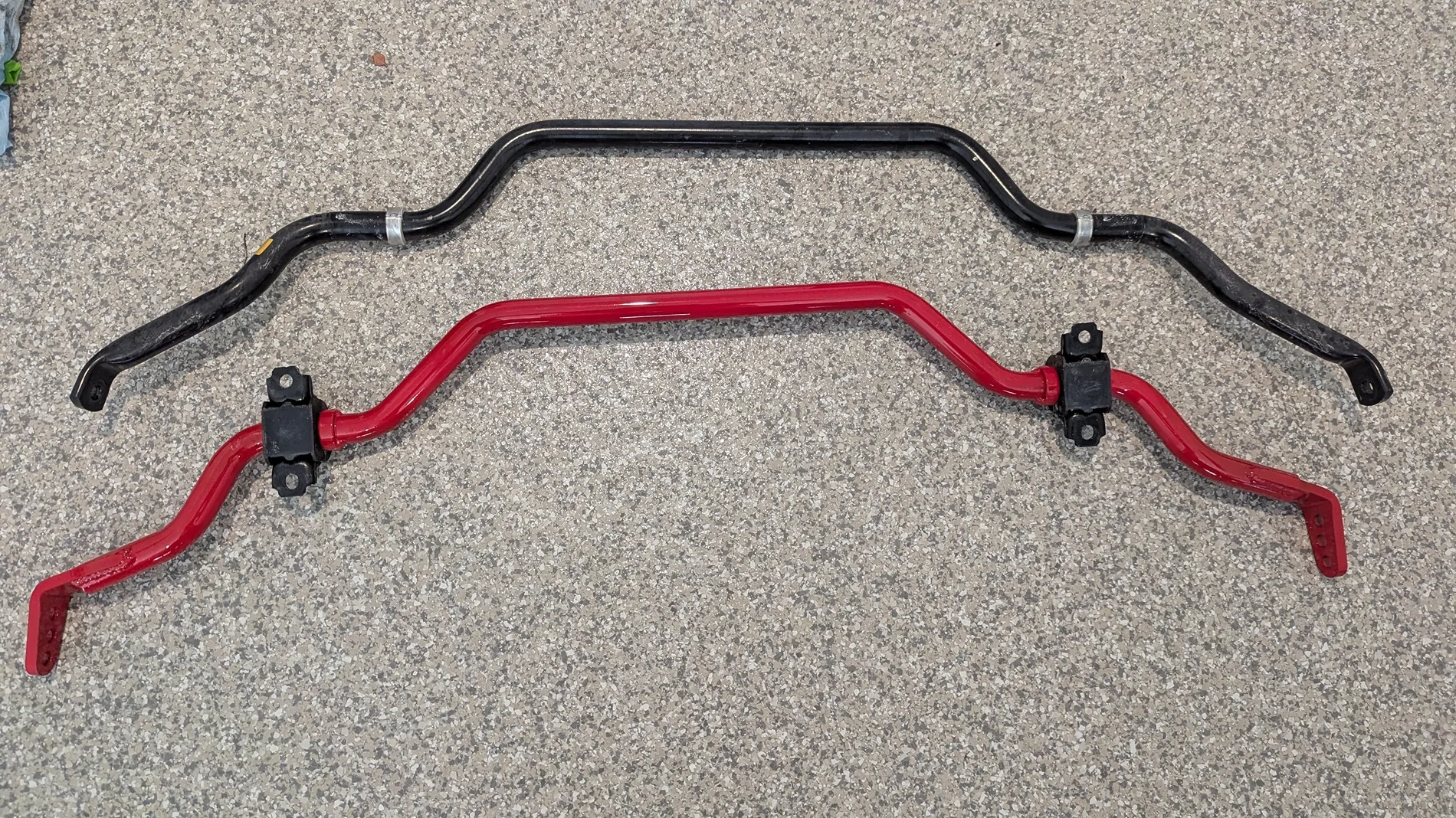

STILLEN front & rear
Hollow design and retains the stock bushings & mounts.
Stiffer isn't always better. Eibach was my #2 but I was trying to avoid aftermarket polyurethane bushings this time around.
In the past on other vehicles I've run:
  • Eibach (Evo X & C8)
  • Whiteline (S2k, Evo IX, & Evo X)
  • Hotchkis (C7)
  • Swift (S2k & Evo IX)
  • SuspensionTechniques (DSM)
Of that list, the only swaybar brand I'd recommend or install again is Eibach. I could make a very similar list for aftermarket lowering springs...

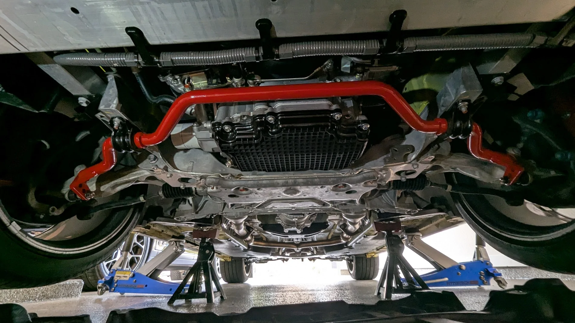

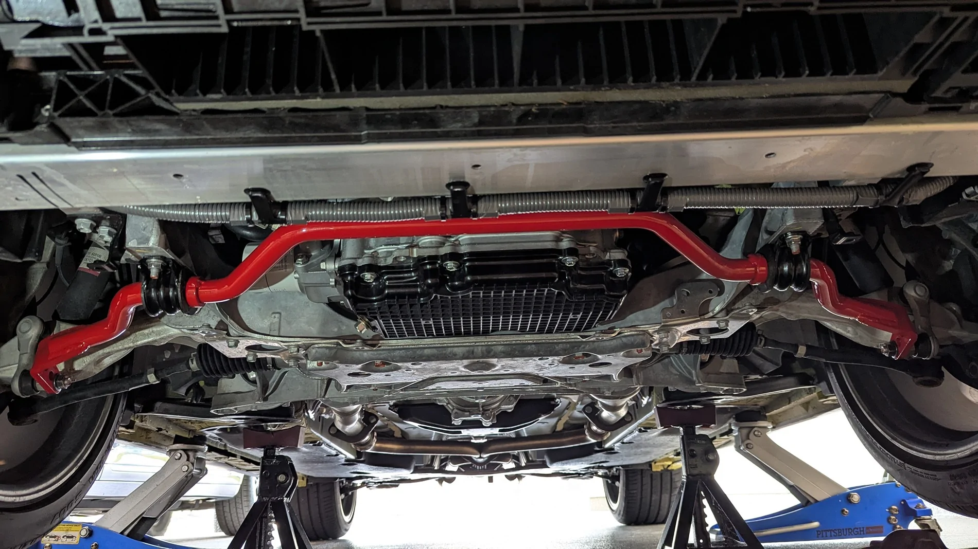

Stillen front anti-sway bar installed on the softest setting this morning; will stiffen it up once I do the rear bar as well. Install was easy and fitment perfect reusing the stock links/brackets/bushings. I had to use an electric impact to get one of the end-link nuts off (17mm). The bracket nuts (deep 14mm) were no issue. I cleaned the brackets & bushings and relubricated them with a packet of Energy suspension grease for zero squeaks.

99
2,919
5,496
They will make a noticeable difference vs stock when set to firmest front. I started with the middle setting but not that much of a difference. Rear is still on soft setting. Flat cornering and well controlled, still on stock springs and shocks.
