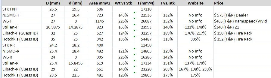

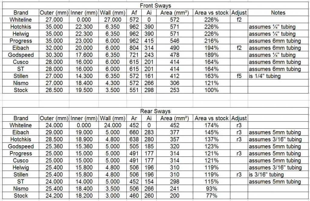

Hotchkis front sway bar, no rear bar. Why? It's proven to be the best bar in the 370z community and the front 100% fits the RZ34.
More detailed comparisons vs other bars
Link to Hotchkis Product page
Features:
• Lightweight, Durable 1 3/8" (35mm) Tubular Front Bar.
• Lightweight, Durable 1.125 (28mm) Tubular Rear Bar 3 Way Adjustable
• Premium mounting hardware including, greasable polyurethane bushings and heavy duty brackets.
• Finished in durable anthracite powder coat.
Benefits:
• Brings handling excitement to your 370Z, G37 or G35
• Dramatically improves steering and chassis response
• Increases stability, improves traction, reduces body roll by increasing front/rear roll stiffness
• Easy bolt-on installation.
Specs:
Front Sway Bar 35mm (Ø1-3/8") Hollow
Rear Sway Bar 28.5mm (Ø1.125") Hollow 3 Way Adjustable
Photo of the bar installed on my RZ34

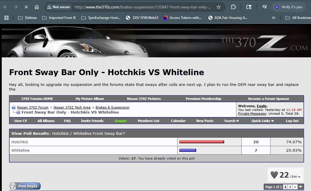

You could start by checking the threads I posted. Most Z34 racers have been on a Hotchkis bar and to this day nobody has made a better performing one yet. If anything other manufacturers have just copied the design and specs.
Only thing better would be a massive custom bar with a switch blade design, something like what the Doran Racing 370Z race cars used to run in the Grand AM Continental Tire Series.

Well thats unfortunate for you that the links don't work on your phone, but the evidence is there.
Not sure if you realize this but the car already washes out from the factory and very badly I might add. And no, a bar is not a bar as not all bars are made equally. There have been some cases of Whitelines breaking and to this day I've not heard of a single Hotchkis bar breaking or malfunctioning. That stiffness you were talking about is detailed in those links. But since you can't look at them or won't be bothered to I'll help and spoon feed the info.
This data is not hearsay, it's track proven. I am one of those guys. I run stiff front, no rear bar on anything from a 265/18 to 295/18 square tire setup and have put down many laps at every single road course here in California except for Sonoma (Streets of Willow, Big Willow, Buttonwillow, Chuckwalla, Fontana (RIP and thanks NASCAR for killing this track), Laguna Seca, Thunderhill Raceway). I've even run this configuration at two tracks out of state, High Plains Raceway in Colorado and Atlanta Motorsports Park in Georgia. It works and it works well.
Granted this setup probably wont work so well on a Z with stock suspension or just some springs, it is meant to work best with coilovers, a track alignment and a grippy square tire setup. Which if you're serious about tracking or competing, this is the route you typically end up going anyway.
Why bother playing around if you have a known good working formula that has been analyzed, beat on, tested and raced from grassroots to pro-am levels of motorsport?
I'm simply providing the info, take it or leave it. Google is a thing and much of this info can be corroborated by doing a quick search.
