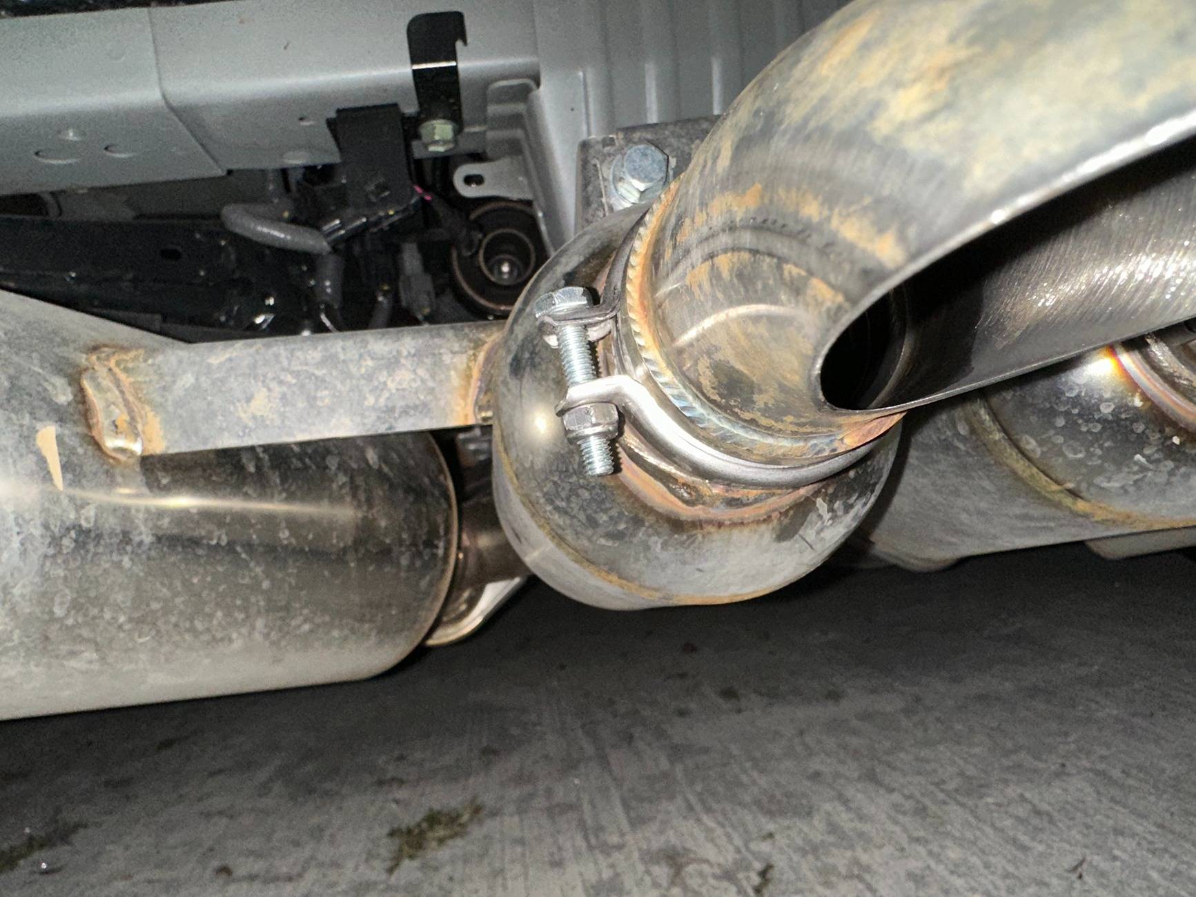

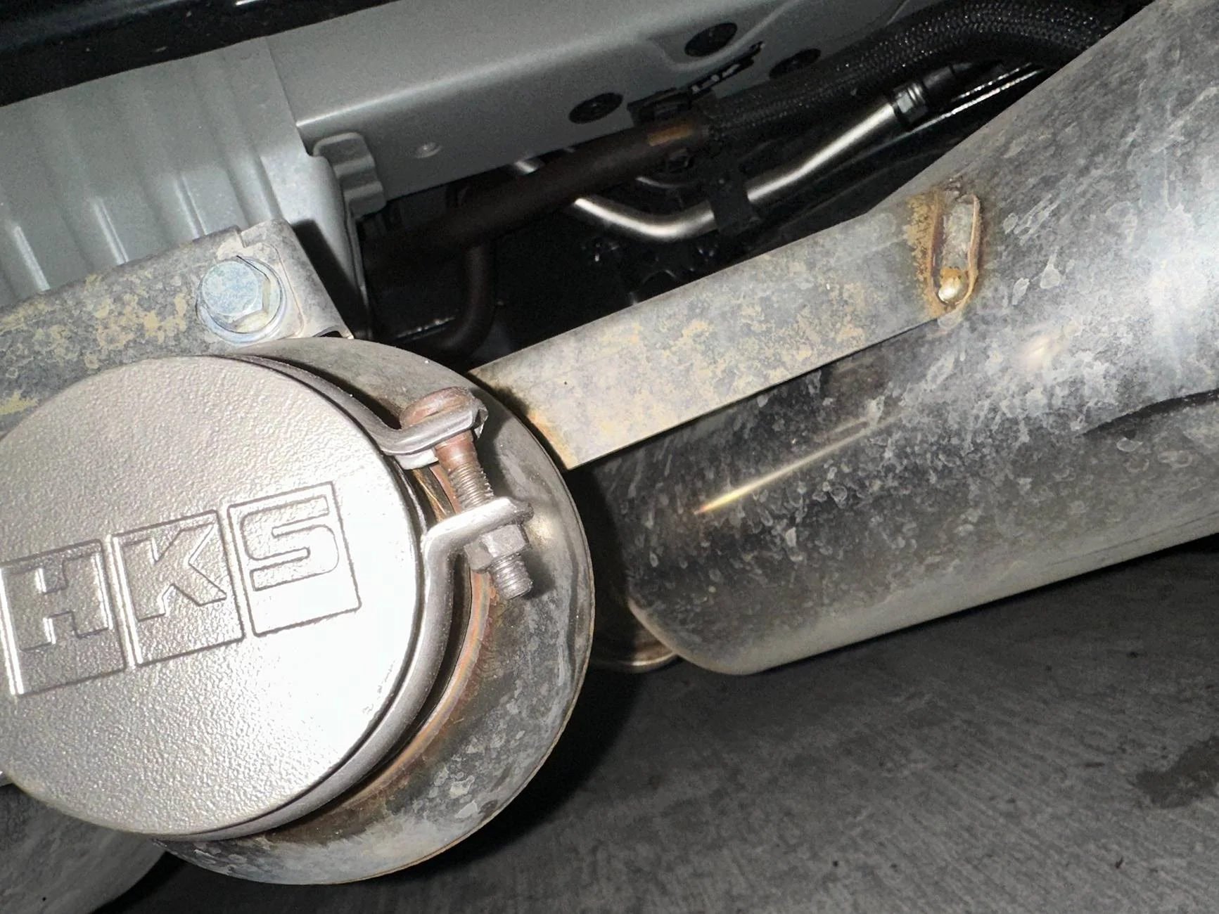

Well I did the cap switch at the shop since I was moving and got no tools to do it myself(they asked me for 160 for 1 hour labor wtf). And was trying to switch the tubes back to check the noise and found that the bolts aren't even the same. Kinda losing my last trust...

The metallic sound could be an internal piece/baffle(?) that wasn't welded properly and is vibrating.
You said you turned ASE off. Did you also turn off the noise cancellation? Not sure if those are connected or separate. It's possible that noise cancellation is picking up something and spitting out an annoying frequency to try to cancel it out. I really have no clue, just speculation.
Regarding the two pics of the bolts...
The bolt in the bottom pic appears to be the one that was made for that clamp. Can't say if that's the original nut, but both appear to be stainless.
I'm guessing the top pic is the bolt AND nut they lost/replaced. That bolt is zinc plated, not stainless. Judging by the rust present elsewhere that bolt could be permanent before you know it. The nut appears stainless, but it also looks like a nylock, and if the nylon melts out of it, it's more likely to loosen up causing you to chase another clanking noise. I'd replace both bolt and nut on that side.
I have the noise cancellation still on, and I did think about there might be some problem when the speakers are trying to cancel the noise from the exhaust. But I'm not sure if it will cause the metal sound though. I rechecked and can confirm that the bolt form the bottom picture with the cap on is the original bolt sent with the exhaust, so yea it should be some replacement, and that's nylock. So I'm gonna look a set of the same bolt and nuts and place them on.
